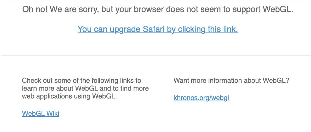

Please check the following:
  1. WebGL Test: Open https://get.webgl.org in Safari. If the cube doesn’t spin there either, WebGL is disabled in Safari.
  2. Lockdown Mode (most common cause): System Settings → Privacy & Security → Lockdown Mode. This completely disables WebGL in Safari. You can either turn it off or add an exception for kurviger.com in Safari (Safari → Settings for kurviger.com → Disable Lockdown Mode).

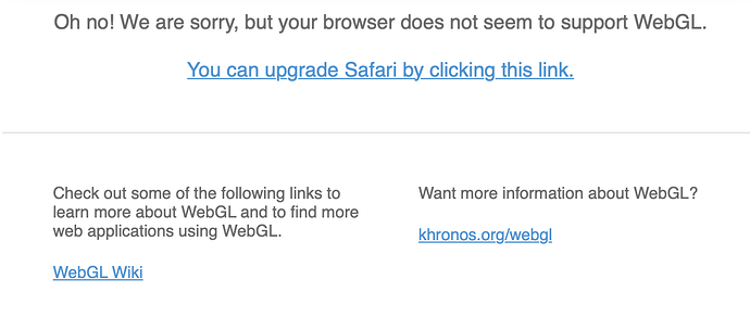

Regarding 1. get.webgl.og shows the following:
It seems the issue lies with Safari after the update to macOS 26.6.2 (performed recently). When I click the link, I am redirected to the Apple Developer page. However, I have never had anything to do with that.
