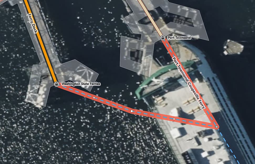

OSM help: https://wiki.openstreetmap.org/wiki/Tag:route%3Dferry#How_to_map_using_a_single_way
The ferry route must not branch in the water, so the route must always be drawn to the ferry dock. This is important for routing to work correctly.
I suspect that the reason is that these two small arms of the ferry route were missing a motor_vehicle=yes tag. I added them, should be good to go in 1-2 days

You are right - routing via that ferry works now :+1:
So my assumption above was wrong (extract from OSM help):
Yes. The Coupeville-Port Townsend ferry route appears to work perfectly now. I can place a shaping point several km from either ferry dock and Kurviger recognizes the ferry as the most direct route.
