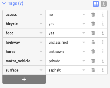

The latest tagging looks a bit weird to me. I don’t know the local rules, but to me it seems like the easiest would be to either use motor_vehicle=private or motor_vehicle=destination. Having tags like access=no but foot=yes can be difficult for some routing software to properly interpret, some will block foot access, others will allow it, if these situations can be avoided, that would make it easier :slight_smile:.
Regarding the tag horse=uknown, I don’t know the local rules, but usually if there is no sign, it is either permitted or forbidden depending on the local rules? If you can’t verify the information locally, then it should not be added to OSM :slight_smile:. If you are interested to why, see the OSM Wiki here :slight_smile:.

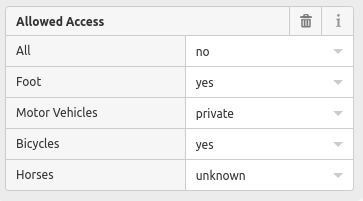

So, there’s a possible contradiction between all=no and bicycle yes. Unfortunately, I don’t know how to remove the all tag. Would all=yes be a safe choice given the value for motor_vehicle?
motor_vehicle=private I am sure of, there’s a sign saying exactly that.
As for horse=uknown, IANL, so I really don’t know. I could change it back to yes, as it was before.

There is this little bin next to the tag, click it and it’s gone.
Please ignore this area:
This is what the editor thinks might be the result of the tags. There is no all tag :slight_smile:.
Yesh no I got that, my question was what’s the difference between motor_vehicle=private and access=private
Ok, all is gone. Now I’ll just wait for three days to see if my route changes.

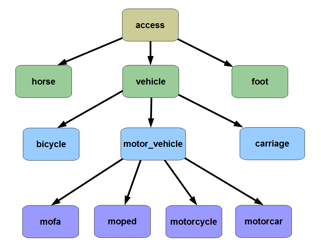

Access includes everything, like foot, bike, horse, moonwalking etc. :wink:
You can see the date of the OSM-Database Kurviger is using on the website menu (the 3 lines)
Looking at the OSM wiki the access tag is organized hirarchically.
Very cool, so a road that allows
  • access for all
  • but cars only for the owner
is possible. Very interesting
