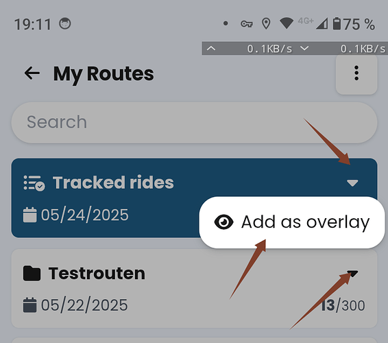

You can add a whole folder as one overlay. Does this work for you?
Goto Kurviger Cloud -> My Routes

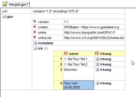

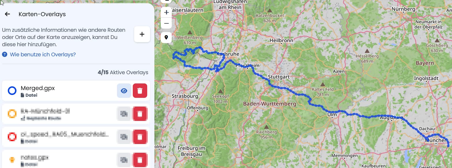

Try gpx.studio — app. Help for merging gpx.studio — help | Merge.
Just merged four tracks into one file.
GPX with four tracks.
Overlay in Kurviger:
Perhaps also with https://gpxshaping.de, not tried.

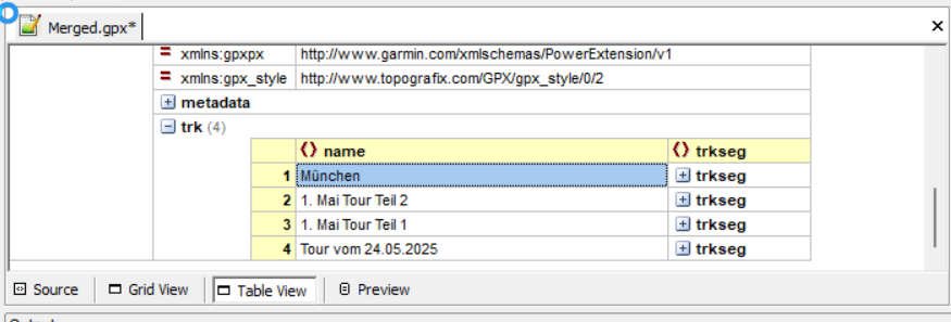

I have created a oneliner for the command line. Unfortunately only for Linux with gpsbabel and gawk. Perhaps there is someone out there who is able to do similar stuff for Windows; I am not experienced with scripting in Windows.
  • Create a folder
  • Copy your gpx-files in the folder
Create an output folder:
mkdir merged
Run this oneliner inside the folder with your gpx-files:
ls *.gpx | gawk 'BEGIN{ cmd = "gpsbabel -t " } { cmd = cmd " -i gpx -f " "\"" $0 "\"" } END{ cmd = cmd " -o gpx -F ./merged/Merged.gpx"; print cmd; system (cmd); }'
The onliner takes all gpx-files in the folder, combines the filenames as input-files to the gpsbabel command. All files are combined into the output file “Merged.gpx” in folder “merged”.
Generated command executed:
gpsbabel -t -i gpx -f "1.gpx" -i gpx -f "2.gpx" -i gpx -f "Muenchen.gpx" -i gpx -f "Tour vom 24.05.2025.gpx" -o gpx -F ./merged/Merged.gpx
Four tracks in the Merged.gpx as expected.
Overlay in Kurviger looks also fine (so far with my testcases).

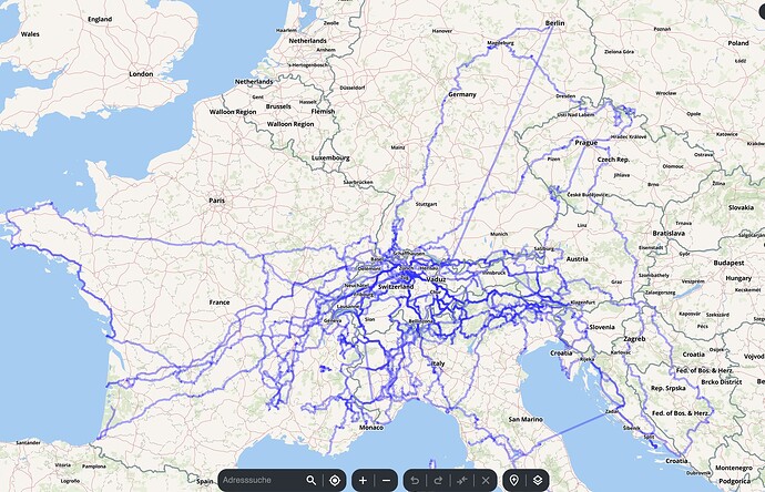

I’d like to have all tracks visible at one sight. Which is possible in Calimoto (pic) or Mytracks.
As I understood, in kurviger this is possible only with overlays - but not with a restriction to 15 …
And I’d still ike to have each tour in one folder, with several (day-) tracks in it.

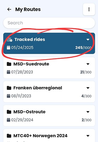

I have used Calimoto only within a short trial period and gave noticed the lines (tracks) like in your screenshot above, but I am not very familiar with the app. Where is the data for these tracks stored and can you switch them on and off individually? Does Calimoto also use the cloud to store the routes and tracks? How can you add the tracks that you recorded with other apps to this overview?
Kurviger currently uses a special folder (“Tracked rides”) for storing the tracks:
If you add this folder to your overlays, you will get a very similar representation to that from your Calimoto screenshot.

From my point of view 15 overlay x 300 planed routes = 4500 is not bad
Add 1000 Tracks you already ride.
Average track/route may 250km
You can see > 1.3 Mio km at once.

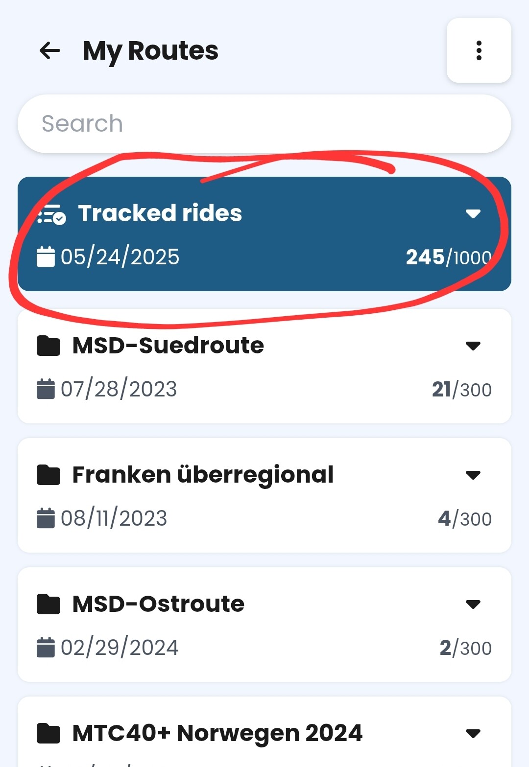

You can still continue tracking your rides, but please let us know when you reach 950 or so, we can increase this limit.

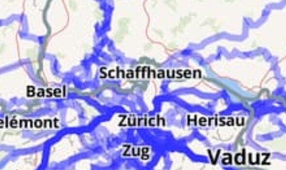

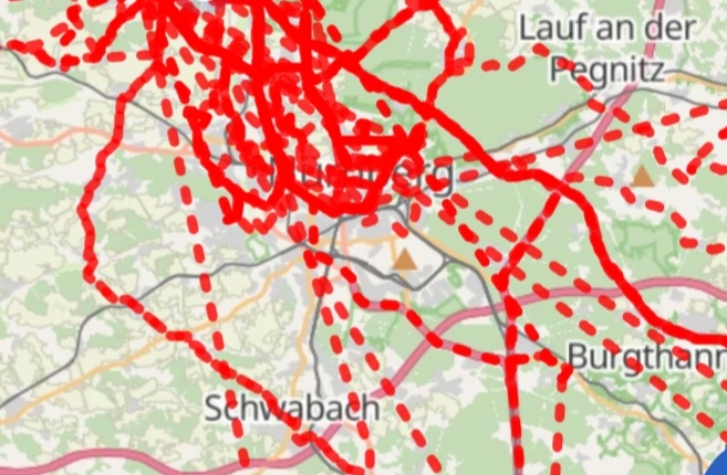

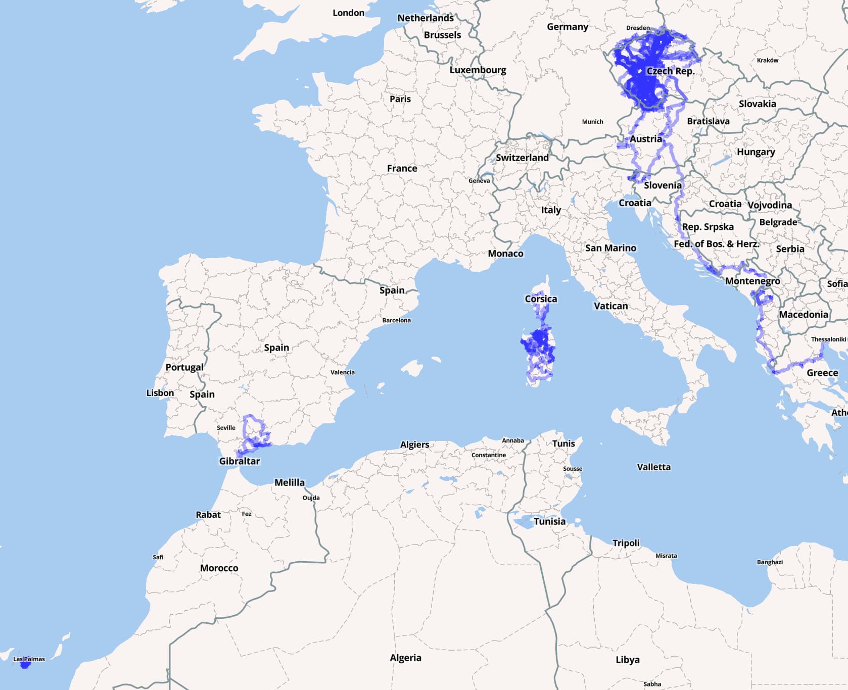

I think, one qualitative difference is that Cali uses transparency (i.e., opacity), which has two effects:
  1. You are able to see which sections you ride more often then the others (when two tracks overlap, the line becomes darker) and more importantly…
  2. You are still able to see the map below it (especially the city names at larger zoom). Here is a comparison Calimoto vs Kurviger
If you could also add transparency and allow the map below the overlay to be better visible, that would be great. Also the city names above the overlays would improve the visual orientation.

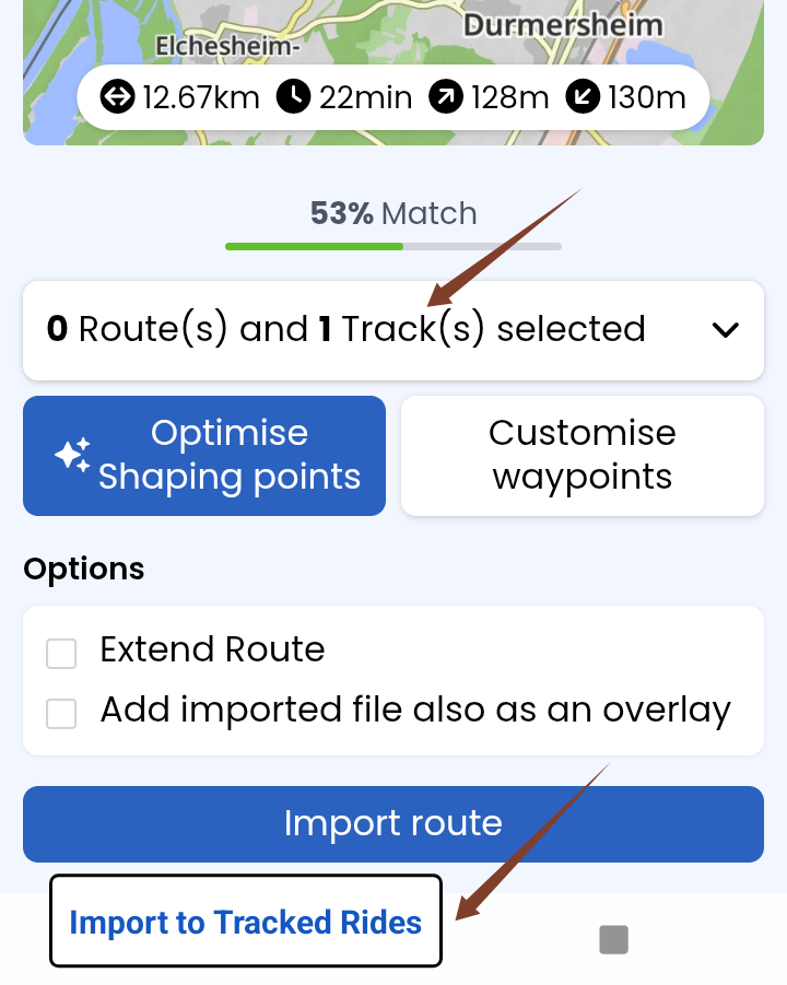

I ask myself if uploading gpx to “Tracked Rides” is a valid usecase - and perhaps less effort and more intuitive.
Seems to be an important point for those, who change to Kurviger.
Uploading gpx - even just to Tracked Rides - as single files or zipped file feels to me quite intuitive. Handling Overlays requires already enhanced knowledge.
So something in the sense of a migration tool. Migrate and drive.
Edit,
Perhaps in the Import dialogue.
If only one track is selected, then a button to import to Tracked Rides is offered (optional :only tracks are selected and count of tracks plus already recorded < max. Tracks). If the file contains no name, it should be an error, i guess.

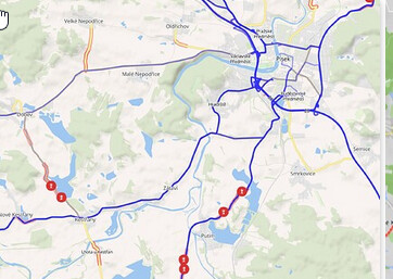

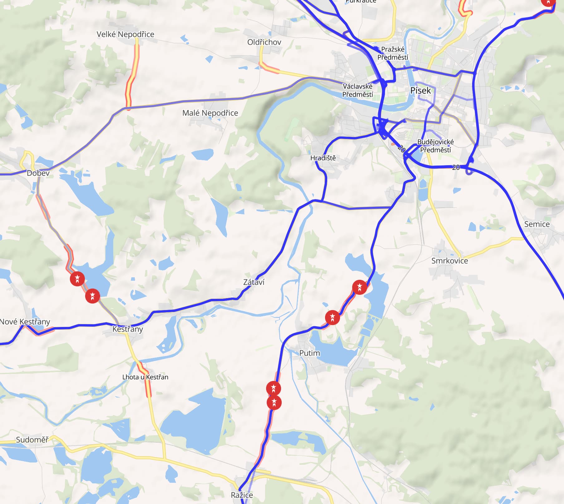

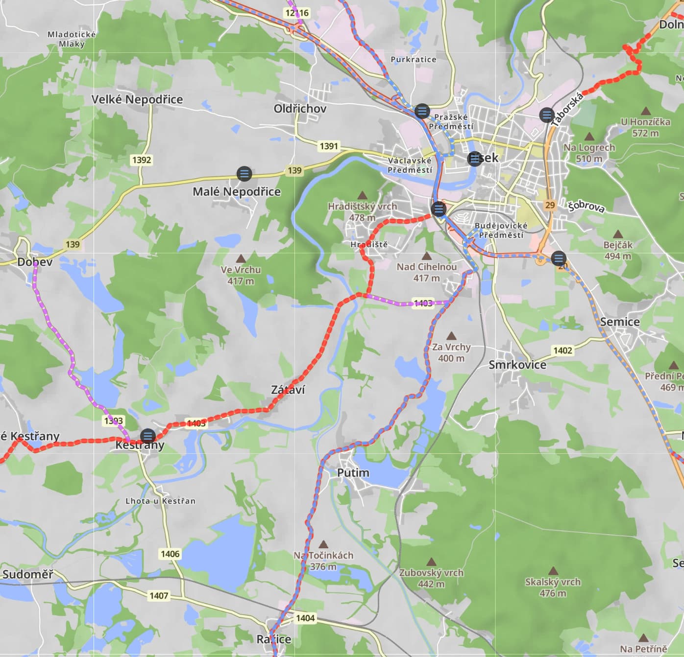

So I tried to create screenshots of the same area in both Calimoto and Kurviger. As @t00thl355 said, Calimoto uses transparency. More blue the road is, more times I’ve rode on it (and if you zoom in enough, it splits into individual rides, that you can click on). And also as he nicely noticed, they show town names on top of overlays.
Kurviger has the entire concept of overlays, which is awesome and as I said, one of the main reasons I was moved to switch.
But it creates a challenge. See the map. The light blue are tracked rides. Red ones are “good roads” (rudamentary attempt in Cali are the highlight points).
You can see the southbound road around a village “Putim”. It is both. So “good road” and tracked. But I can barely see the red color. And the red has set the thickest line, blue has about 75%. And if I make it thinner, it will be hard to see when zoomed out.
I would like to tell Kuviger to show red on top of blue. With combination of adding possible transparency and switching tracked or some other folders from dashed to solid lines individually, it could improve the readability.

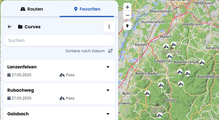

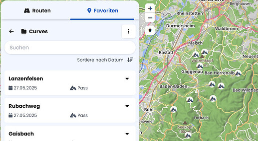

Nachdem ich gestern ziemlich kritisch war, habe ich nach etwas anderes gesucht. Zumindest mal für diese Markierungen schöner Stellen. So banal, ich habe mich geärgert.
Ich habe mir einen Favoritenorder “Curves” erstellt, dann bin in meiner Gegend durch dir Karte und habe schöne Stellen einfach als Favorit erstellt, Kategorie “Pass”, es fehlt an mehr Symbolen!
FĂĽr die Route musste ich dann nur den Favoriten entlang klicken.
Also anders gesagt: Vielleicht kannst Du auf die doppelten Overlays der Tracks verzichten, alle Tracks in ein Overlay. Die schönen Stellen werden zu Favoriten?
Ich habe in Favoriten zu dem Ordner “Curves” die Kategorie “Kurviger” vermisst. Zum Beipiel so. Ok, viel Mühe habe ich mir nicht gegeben.
