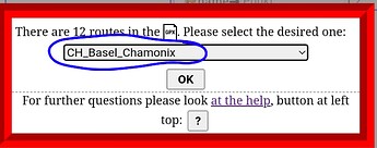

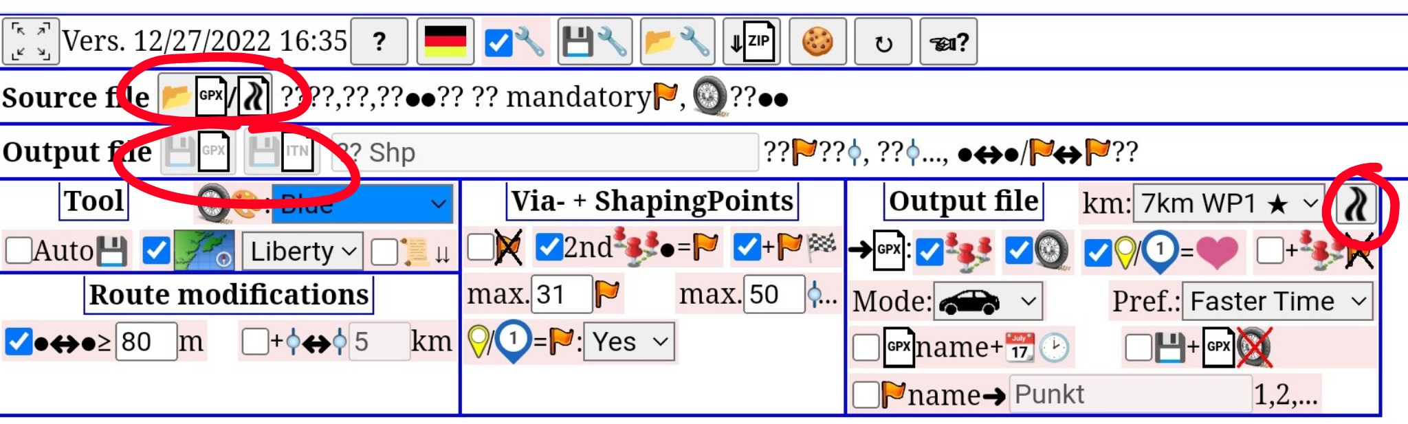

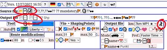

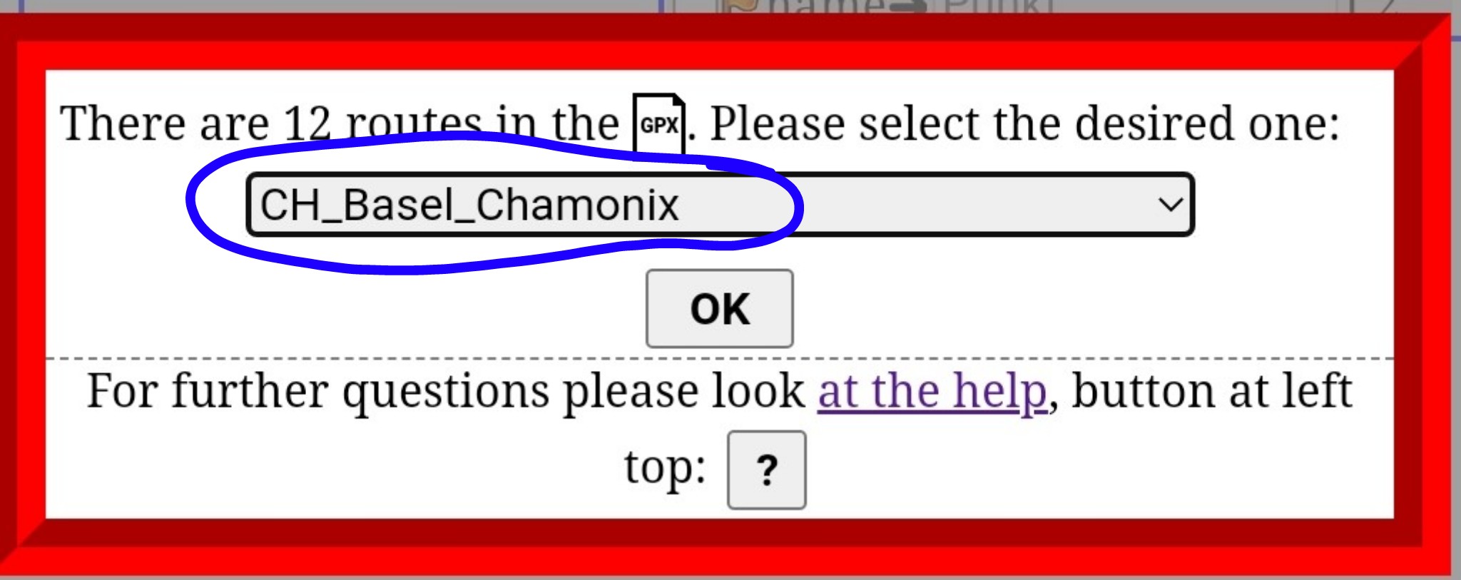

You can try gpxshaping.de
Open your GPX: Help
Choose your route and click ok:
Press Kurviger button: Help
You also can try to save your selected route as GPX and import that GPX in Kurviger - that might give you a track matching your selected route.

Thank you so much! I fixed it with your steps. I now have 3 routes in 3 separate files!
