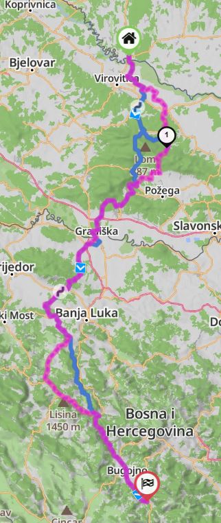

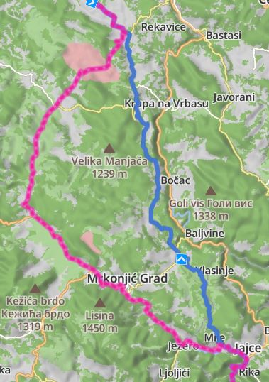

When I pull up a saved route it gives me the nice Red / Magenta route I planned and want to ride, however when I load it, it recalculates, and gives me a new blue road, which matches 70% of my originally planned and saved route. I cannot even recreate the route I saved a year ago.
How do I export my Red / Magenta original map?

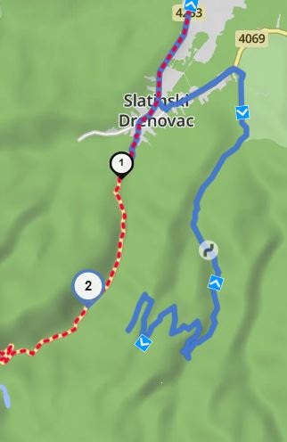

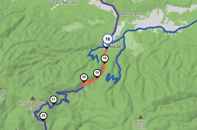

There is a place where a tarmac road is, and kurviger doesn’t let me in recently, however the route that was planned with kurviger a year ago it took me there, I rode that beautiful road, and now it doesn’t let me to plan that road again.
Blue is new, red dots are the old planned, ridden roads, I cannot get out to GPX.
I found my old GPX, and when I load the created route, it says 88% match.
Looks like something is off with the program, doesn’t want to plan again the same road…

Can you share the link to your route, so we can have a look?

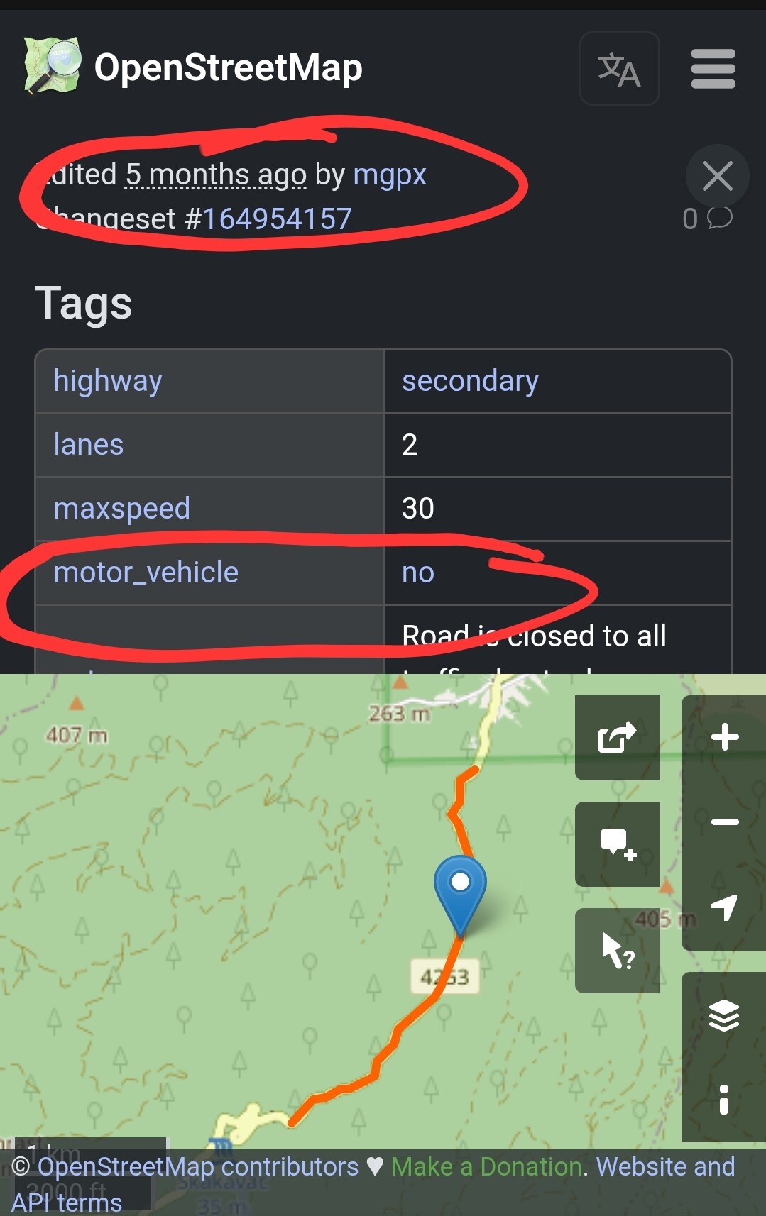

Most likely the road is now closed - we could check the status in open street maps (OSM).
Update:

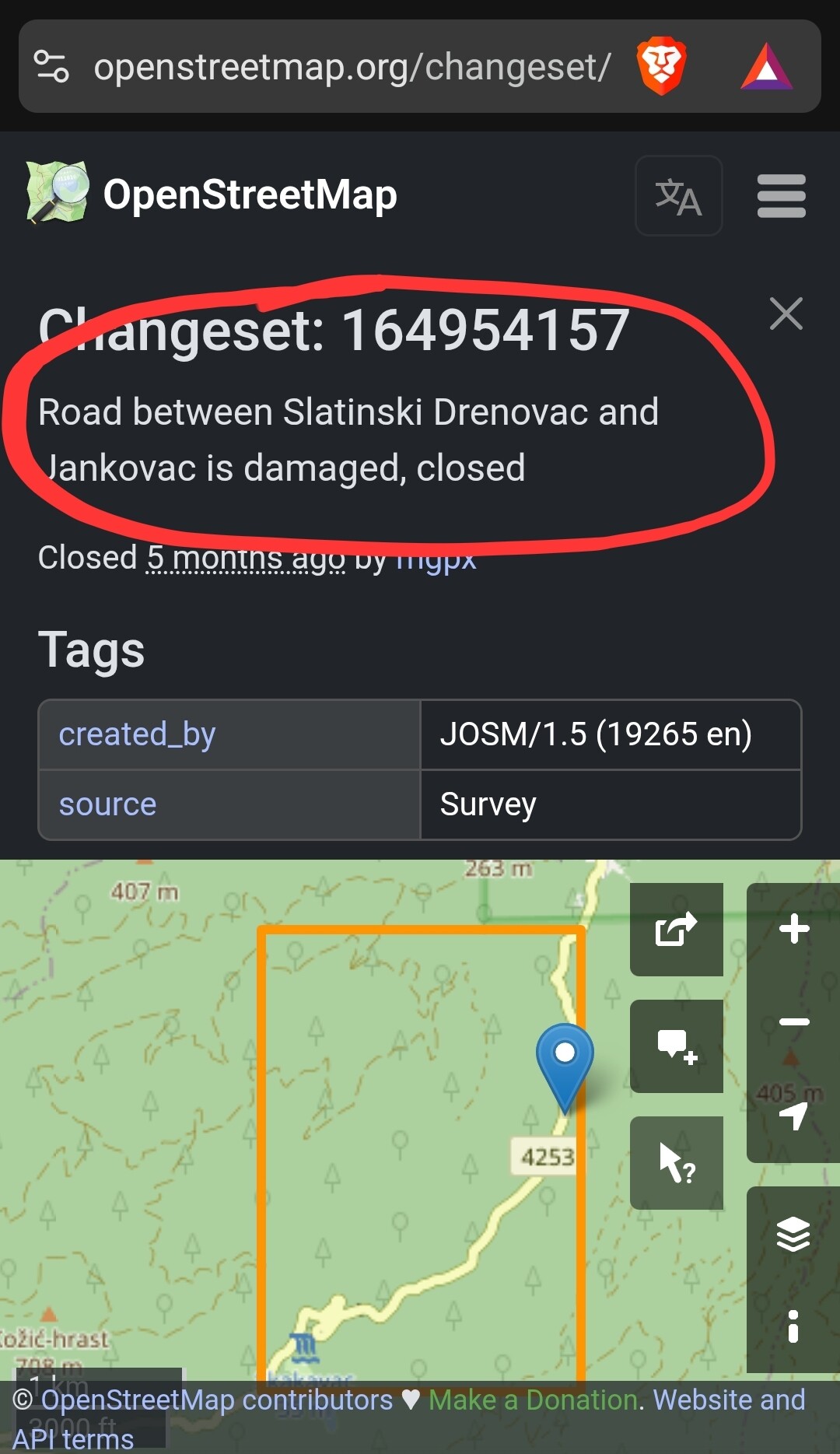

Found it: Changeset: 164954157 | OpenStreetMap
The road was tagged as not accessible for motor vehicles 5 months ago - it is damaged.

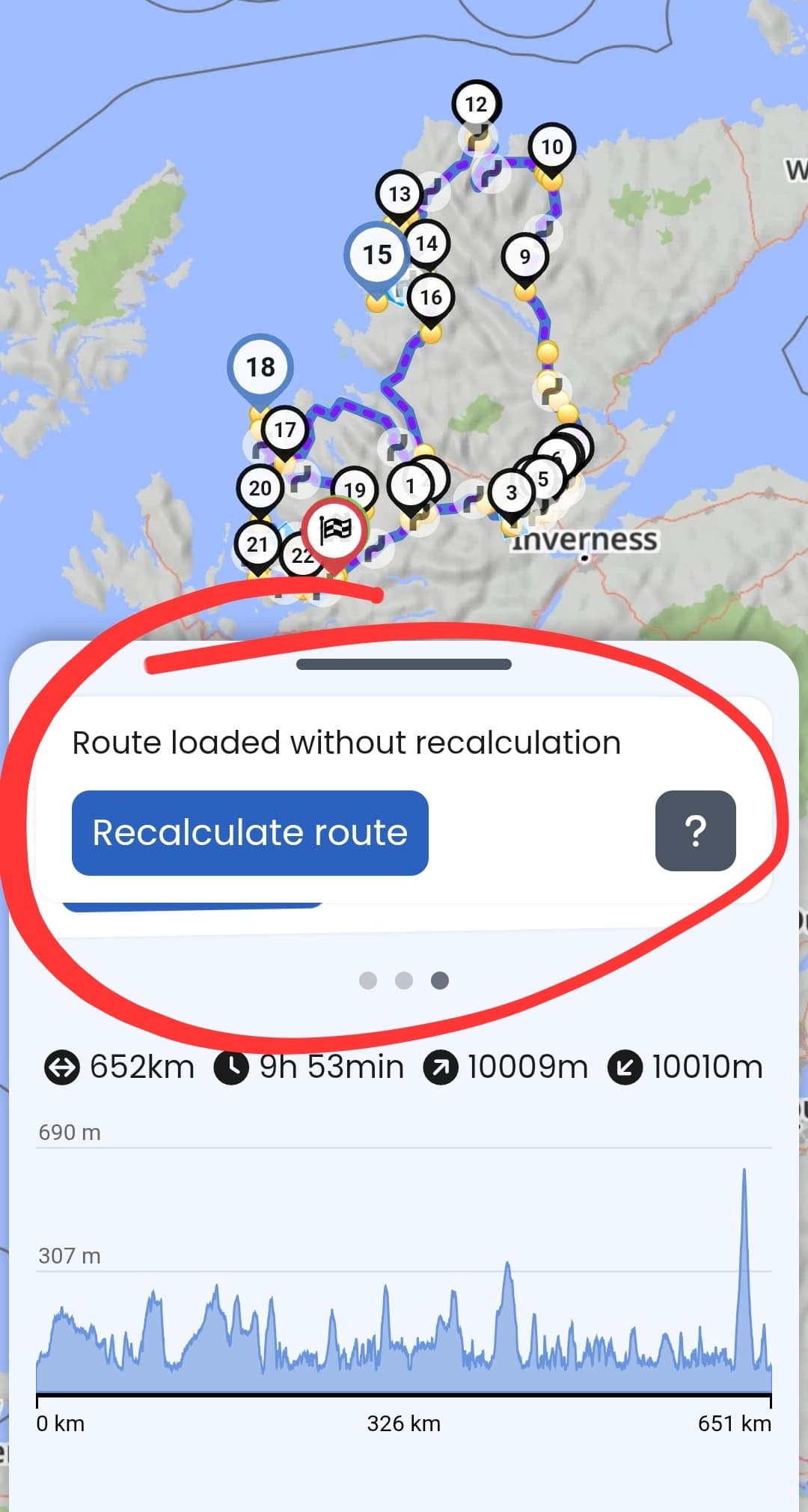

This is the default for all cloud routes for about 6 months. Routes saved before that time require a recalculation. That said, once you change anything about this route it will recalculate. Currently you can only share this route without any changes if you use the .kurviger file. If you use a link, the route will be recalculated (we have this on our list already).
You can use the beeline option (bird icon) to plan a straight line, that way you can connect a road that is marked as closed in the data.

One hint for “manual intervention” - load the route as overlay first then load the route for editing. This way you can see if there are any differences between original route and the recalculated route.

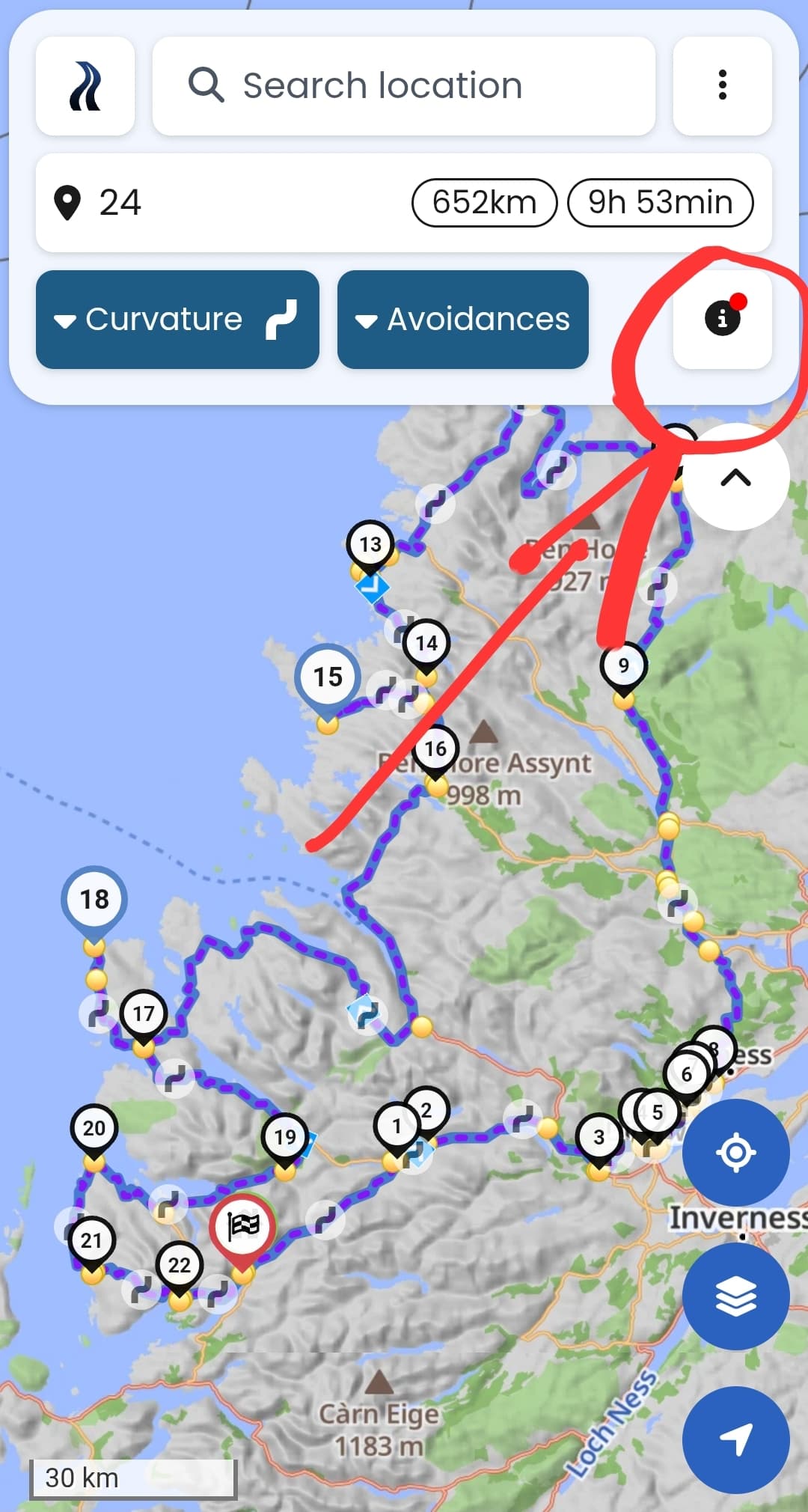

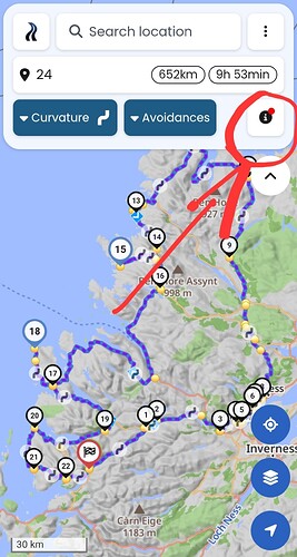

You can see if an older route has not been recalculated under “i” button (you may need to swipe a couple of cards before you find the right information):
I think the entry in OSM probably refering to this road closure:
The road was apparently at least partially repaired and opened, apart from trucks (if I unerstood it correctly):
…which is consistent with announcing the temporary event related closure from 9th to 10th August.
I made a note in OSM, I hope someone will update the data soon.
