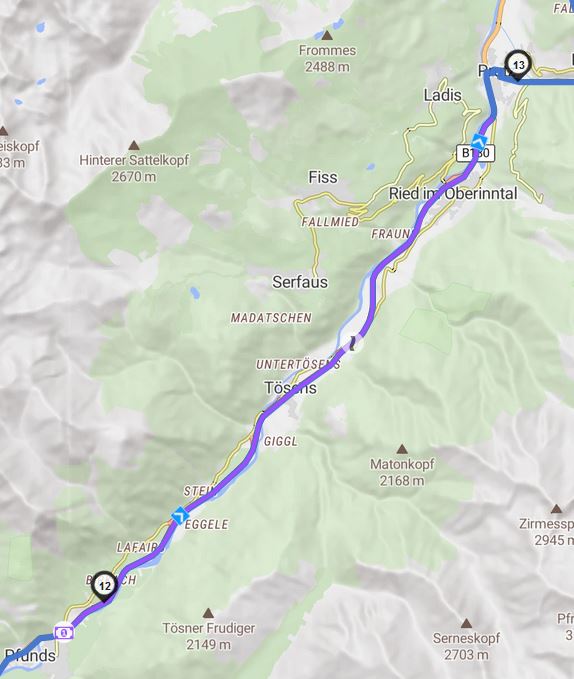

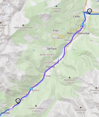

I think you mean that part.
with “avoid toll”
without “avoid toll”
Even with a waypoint it wants to avoid the B180 - strange.

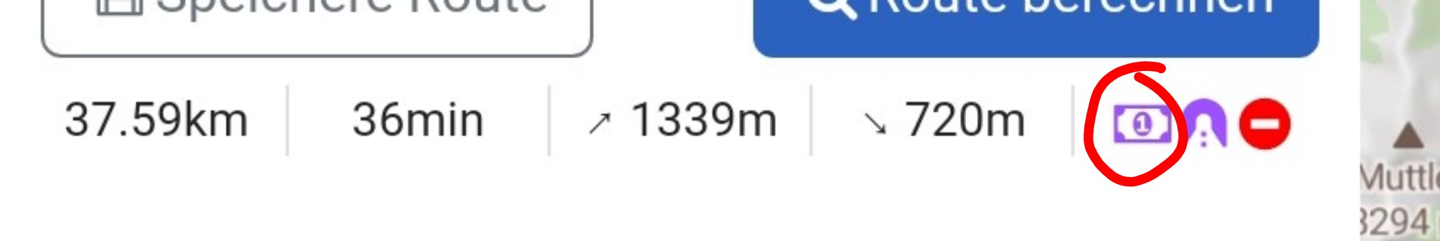

I also think there might be a bug in the Kurviger algorithm. If you check this route (with Kurviger Tourer):
you get a hint about toll:
Clicking on the toll icon and on the OSM link you go to:
But there is no hint about toll in the OSM data - just highway=trunk (not motorway!).
