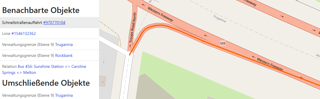

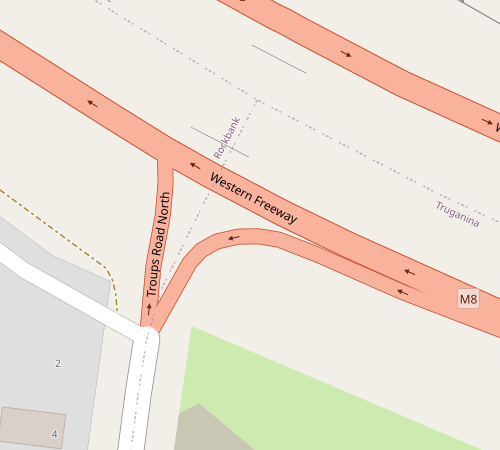

I suspect this is because the route initially takes you onto the motorway exit (turn left), and this exit doesn’t have a name. According to OSM, it runs as far as Troups Road North, as the image shows: (red line)
At the end of the red line, you don’t need to turn any more; you simply carry on straight ahead onto Troups Road. A prompt such as ‘Turn onto Troups Road’ is unnecessary.

Ich vermute, dass es daran liegt, dass das Routing dich zunächst auf die Schnellstraßenabfahrt führt (turn left), diese Abfahrt hat keinen Namen. Diese reicht laut OSM bis zur Troups Road North, wie das Bild zeigt:(rote Linie)
Am Ende der roten Linie musst du nicht mehr abbiegen, du fährst quasi geradeaus in die Troups Road. Eine Hinweis wie “Abbiegen in die Troups Road” ist unnötig.

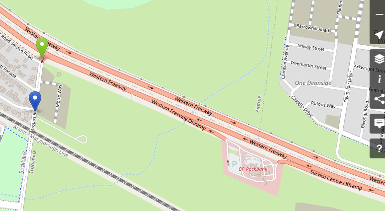

Good idea but the petrol station is some distance from the exit. From OSM
It is that BP Rockbank that I have a waypoint at - you then join back on the freeway before taking the exit to Troups Road North. If I set the waypoint further away from the exit it doesn’t change the directions, Troups Road North will still not be shown.

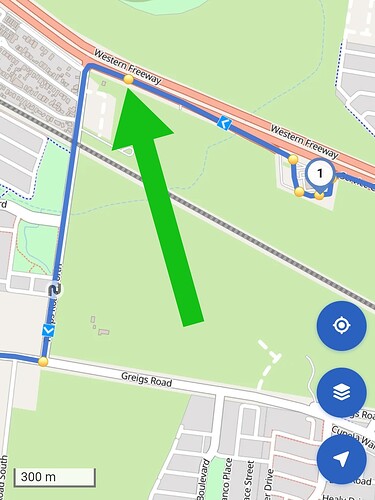

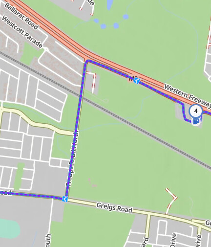

I have shortened a route to have this turn in focus: https://kurv.gr/tCvuQ
Kurviger generally does not announce instructions “continue straight” or “follow the road until…”.

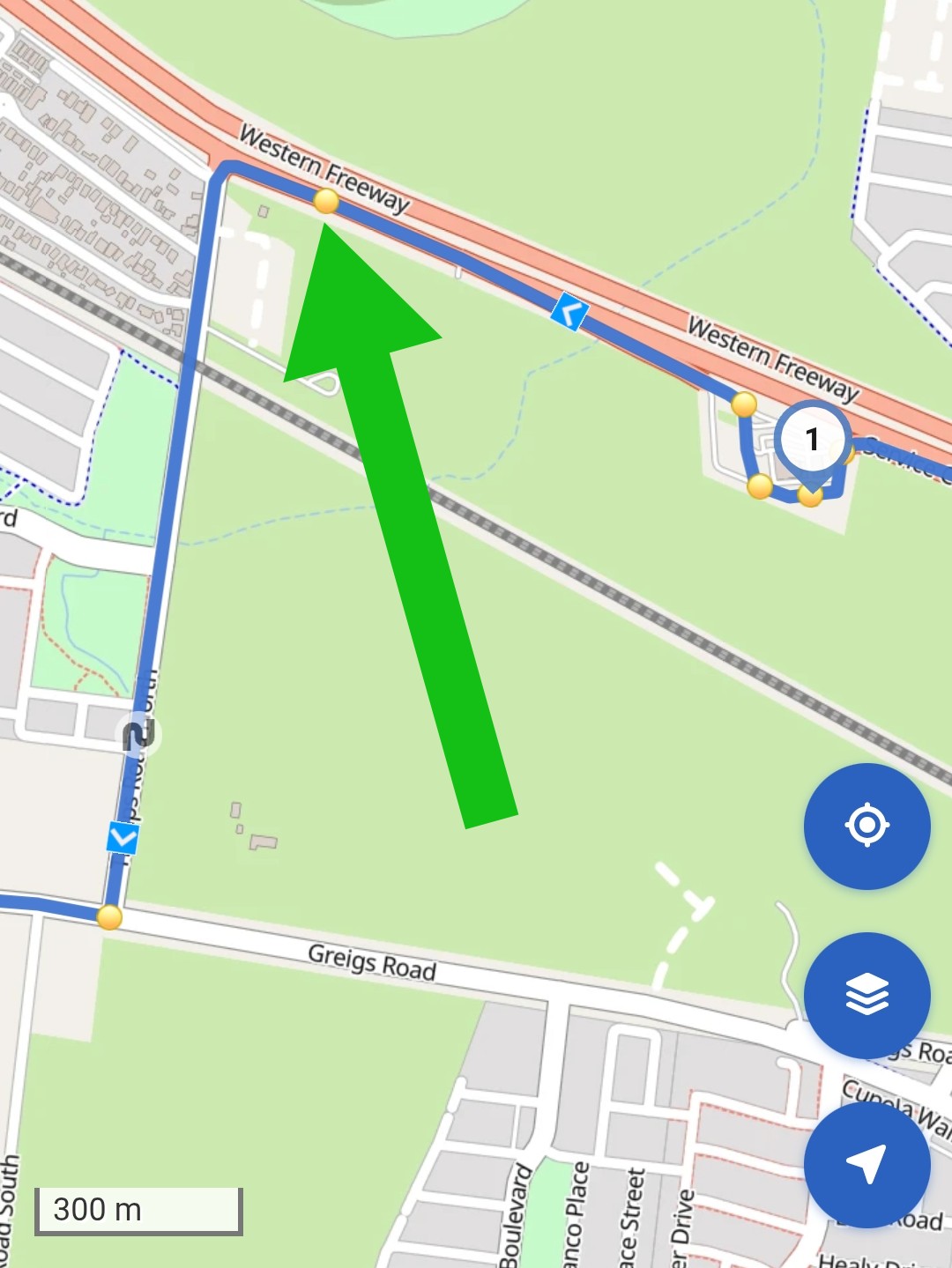

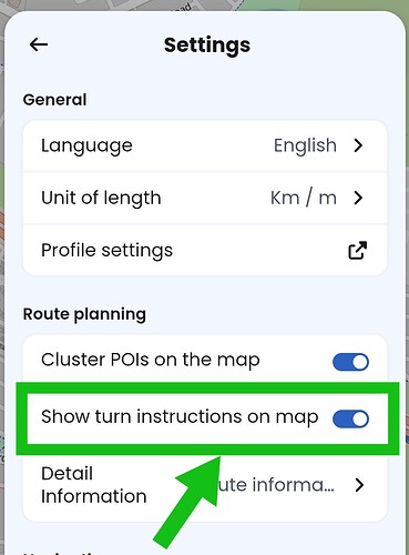

If you turn on “show turn instructions on map”, you will be able to see in planning mode, where the instructions will be given:
The yellow dots are marking the position where the turn instructions will be announced. The arrow on the map is showing the “turn left” instruction. It is the place where you really have to commit to the right lane to be able to turn left.

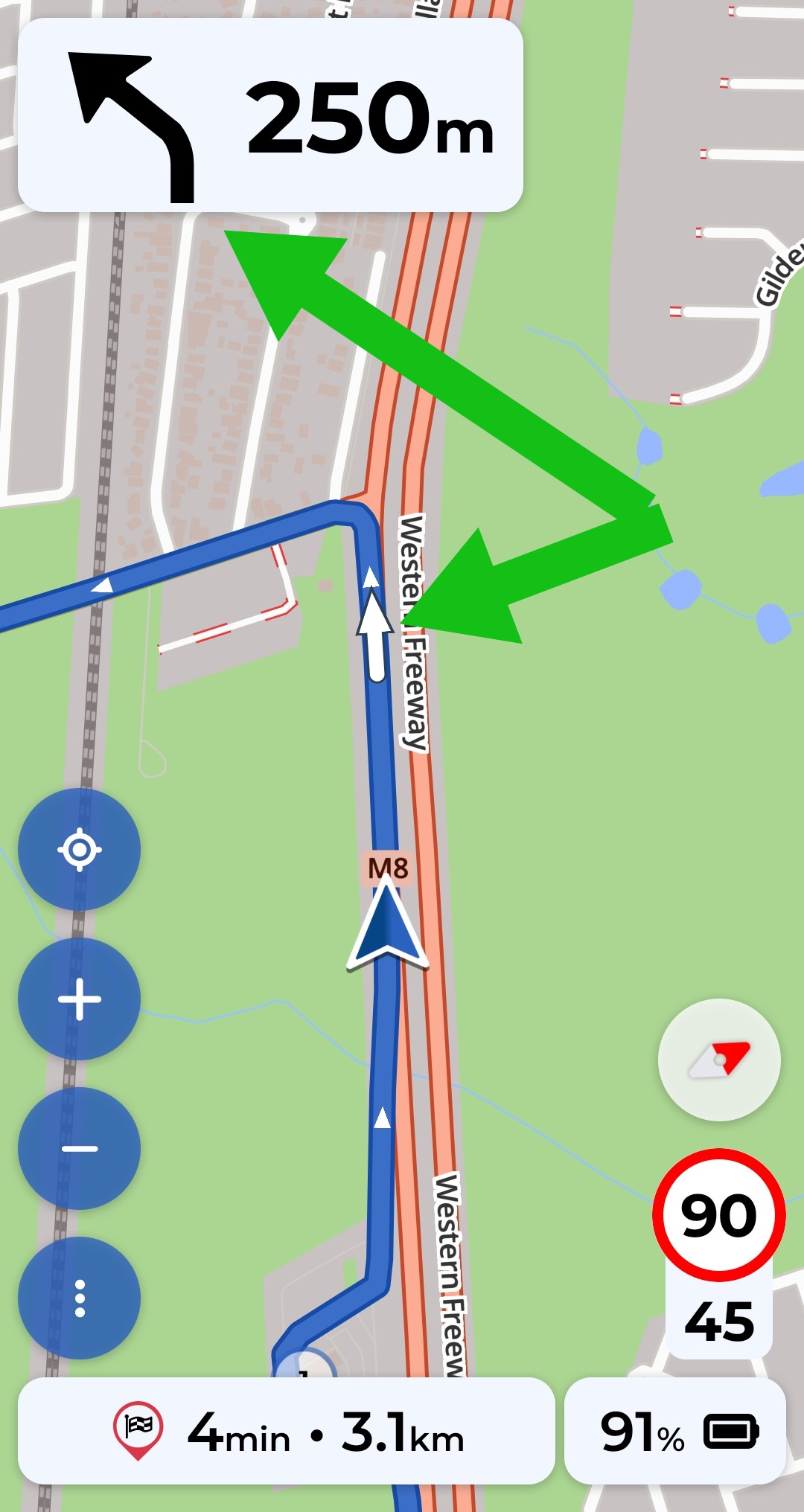

In navigation mode, it looks like this:
The white arrow on the route looks almost like going straight because the two roads fork at very small angle, but the arrow in the info box (upper left corner) clearly shows to turn/keep left. After that node (fork), the next node/crossroad is with Ballarat Road Service Road and Troups Road North. In this node, as @Maxx18 mentioned, you continue straight to the Troups Road North and Kurviger does not give any further instructions on that node.

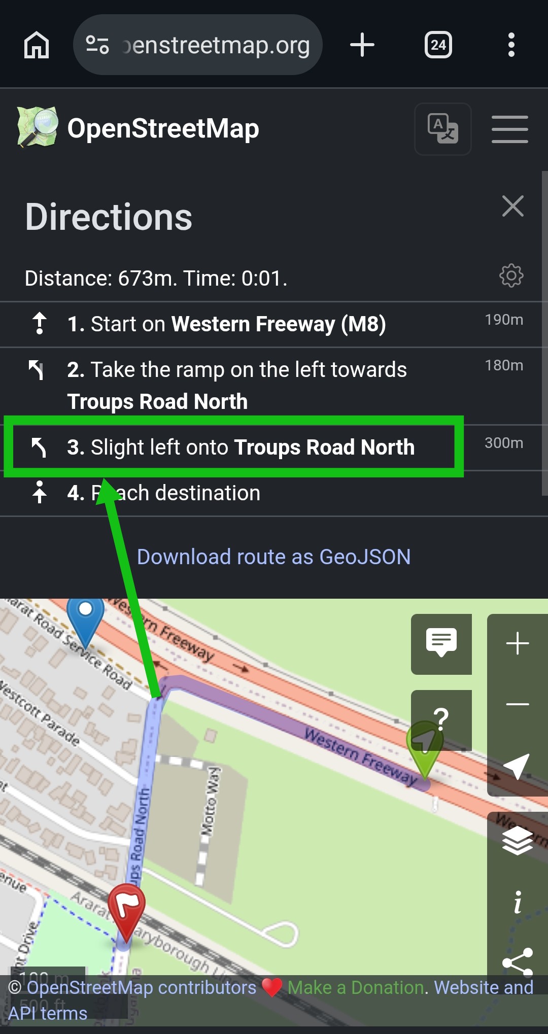

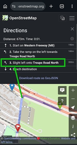

In contrast to Kurviger, OSM will issue a “slight left” instruction on this node, which is probably just a different interpretation when a line is a “straight” and when it is a “slight turn”:
The bottom line is - Kurviger likely behaves as designed for the given OSM data. It gives a very brief turn instructions, which we may or may not like. I sometimes wish I get an extra instruction but am also silently grateful that my music is not constantly interrupted by unnecessary announcements.

It is Australia so I’m on the left hand side of the road so that’s a left turn coming off the freeway onto Troups Road North. I’m not familiar enough with OSM but I’m suspecting that may be the issue - the exit of the Freeway to Troups Road isn’t named so it just says “keep left”.
I’ll add, it is probably the worst freeway connection in Melbourne. There really isn’t anything like a real freeway entry or exit ramp there as such, just a side road with a traffic island connecting to a major freeway.
