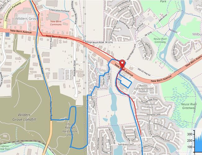

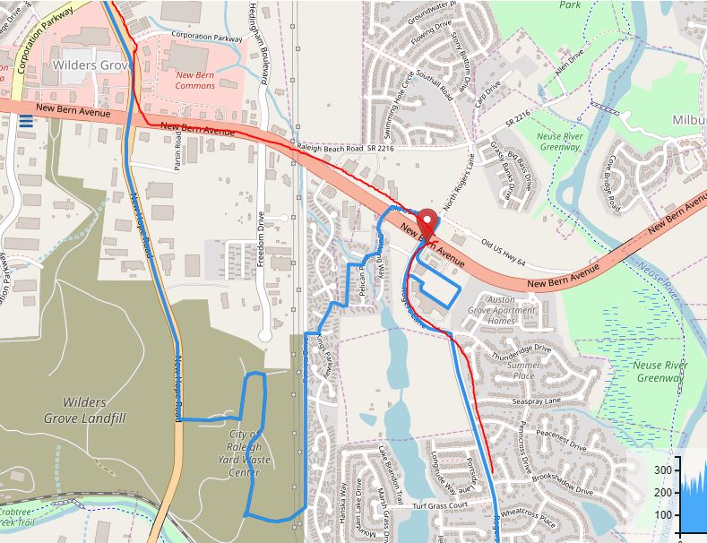

Thank you for the response. I can see how my waypoints would have been confusing. The reason they are there are because I was trying to drag the route onto New Bern Ave. See the attached pic as you requested.
This question comes after I made the ride, and I am familiar with the area. New Bern Ave the big east/west road near the beginning is actually a surface road. All of the intersections have traffic lights and the ability to turn left/right. My start/end point is a popular gas station. I wanted to pull out and head to the next lighter surface road, in case New Hope Rd. Instead of allowing me to do this, the routing always ends up off New Bern and New Hope and into these little neighborhoods. In the case of the inserted picture it is through an apartment complex parking lot even though there are names on the roads!
If you take my link and just delete points 2 and 3, you will still see the odd routing. I have had this happen to me more than once, this is just a dramatic example. I suspect it is “avoid main roads” along with “avoid same road” options. The sticky bit is when I try to just smooth it out with a few way points for affinity is gets even more resistant and creates rather dramatic routes on side streets.

  1. You wanted to ride Hwy 64, but have selected Avoid motorways.
    So Kurviger tries to avoid that highway. You would need a lot of waypoints to force Kurviger to use that highway nevertheless, because it would want to leave the highway at any occasion.
    Better don’t check Avoid motorways if you want to use roads with more than one lane per direction.
  2. As Patrick mentioned, your WP2 and WP3 are in the wrong direction.
    “Hwy 64” has separated lanes for each direction. On such roads you have to carefully place your waypoints onto the correct side of the road.
  3. Don’t place waypoints directly onto intersections!
In this first exaple I have changed your options a bit.
  • removed Avoid motorways, as this is a rather strict avoidance, and not very suitable to ride multi lane highways.
  • switched to curvy instead of fast and curvy, which avoids motorways anyway.
  • I’ve separated End and Start, to make the difference between inbound and outbound more clear. (zoom in to see that)
In this second example I’ve placed two extra waypoints onto “Hwy 64” to get you quickly out of the city.
Zoom in, to see that these WPs are placed on the outbound lane of Hwy 64.
