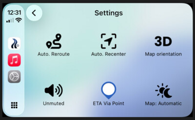

I dont have the same options in the screen shots you have sixxoptions i on other hand have only three on my carplay i will have to connect again to chech why.

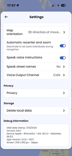

Sorry, I just searched for the docs, do not have a Carplay device. You could check your version on your mobile by upper left Kurviger icon, then settings, scroll down to bottom.
Version 3.6.5 should be the current one. You can also tap to copy and paste it here. Then the experts must help.
Edit Change log here. With 3.6.3 and later there were a lot of Carplay related changes.
Is it possible your’re confusing the three-dot-menu with the settings? The three-dot-menu has three options in CarPlay. Otherwise please send a Screenshot of your CP screen.
No im not i have only three options on the svreenshots in guide there are six.

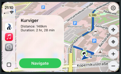

We are talking about this screenshot, right?
If you start CarPlay (not in Navigation or Follow-Mode, but the start view)
and click on the :gear:, you should get the 6 Settings. With the ETA setting you can then switch fi you want to see destination or via point ETA in the active navigation.
That you can do in the feature menu (three options) with the “skip waypoint” feature during active navigation.
