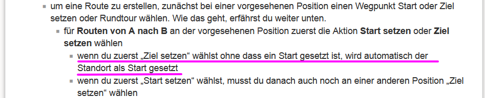

Dein Vorschlag ergibt eine für den Anwender sehr komfortable Option :+1: (wenn der Standort des Anwenders “Abseits der Route” ist).
So lange es diese Option nicht gibt, muss man das Ziel eingeben. In der Bedienungsanleitung zur App gibt es hierzu folgenden Hinweis:
https://docs.kurviger.de/de/app/manual/route#vorgehen_bei_der_routenerstellung

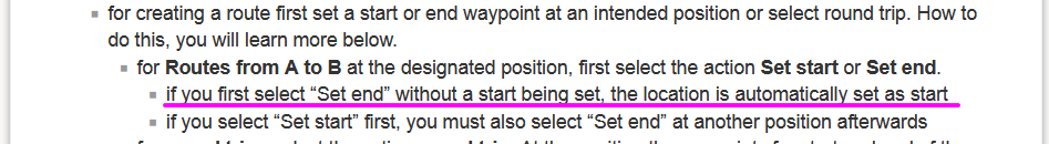

Your suggestion results in a very convenient option for the user :+1: (when location of user is “Off route”).
As long as this option is not available, you have to enter the destination. The app’s operation guide contains the following note on this:
https://docs.kurviger.de/start?id=app/manual/route#procedure_for_route_creation

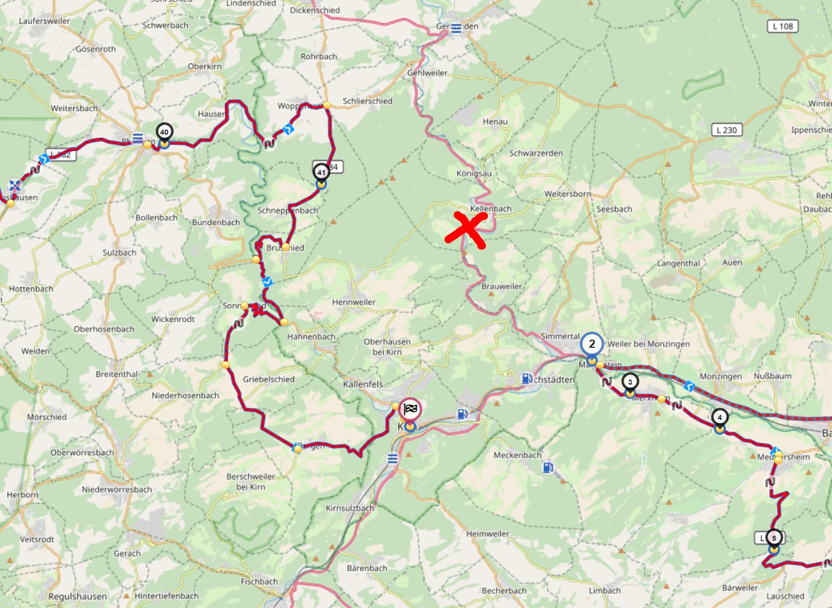

Argh, ich vergesse das jedes Mal, die passende Datei zuzufügen, habe die Route mit eingefügt. Ich war an dem angekreuzten Punkt, als ich die Route neu geladen hatte und neu berechnen ließ. Kurviger wollte aber partout über den letzten Wegpunkt zum Ziel.
Argh, I forget to add the appropriate file every time, I included the route. I was at the ticked point when I reloaded the route and had it recalculated. But Kurviger wanted to get to the destination via the last waypoint.

Starting navigation away from the route, the suggested rerouting options are:
  • Start
  • Nearest waypoint
The nearest waypoint (straight line) from X is the 41, not the destination.

That is exactly what I showed above, I do not understand what else you need. I was at the position of the red cross and started a recalculation. The App wanted to navigate me via WP 41 to the destination. I then tapped on the routing advice in navigation menu and chose the ‘skip waypoint’ option. After recalculation WP41 still persists. Is there anything else I can do to reproduce this or make it easier for you to track back to the error? The route and the pref file is already in the discussion.
Additional hint: The recalculated route only consists of the last Waypoint/Shapingpoint and the destination. It seems to me that the App does not skip the last waypoint and navigate directly to the destination.

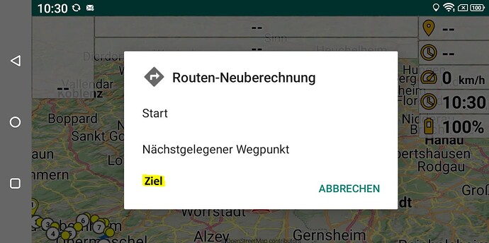

Thanks for the suggestion.
It will be available in the next app update.
Rerouting options when starting navigation away from the route:
  • Start
  • Nearest waypoint
  • End
Manual:
