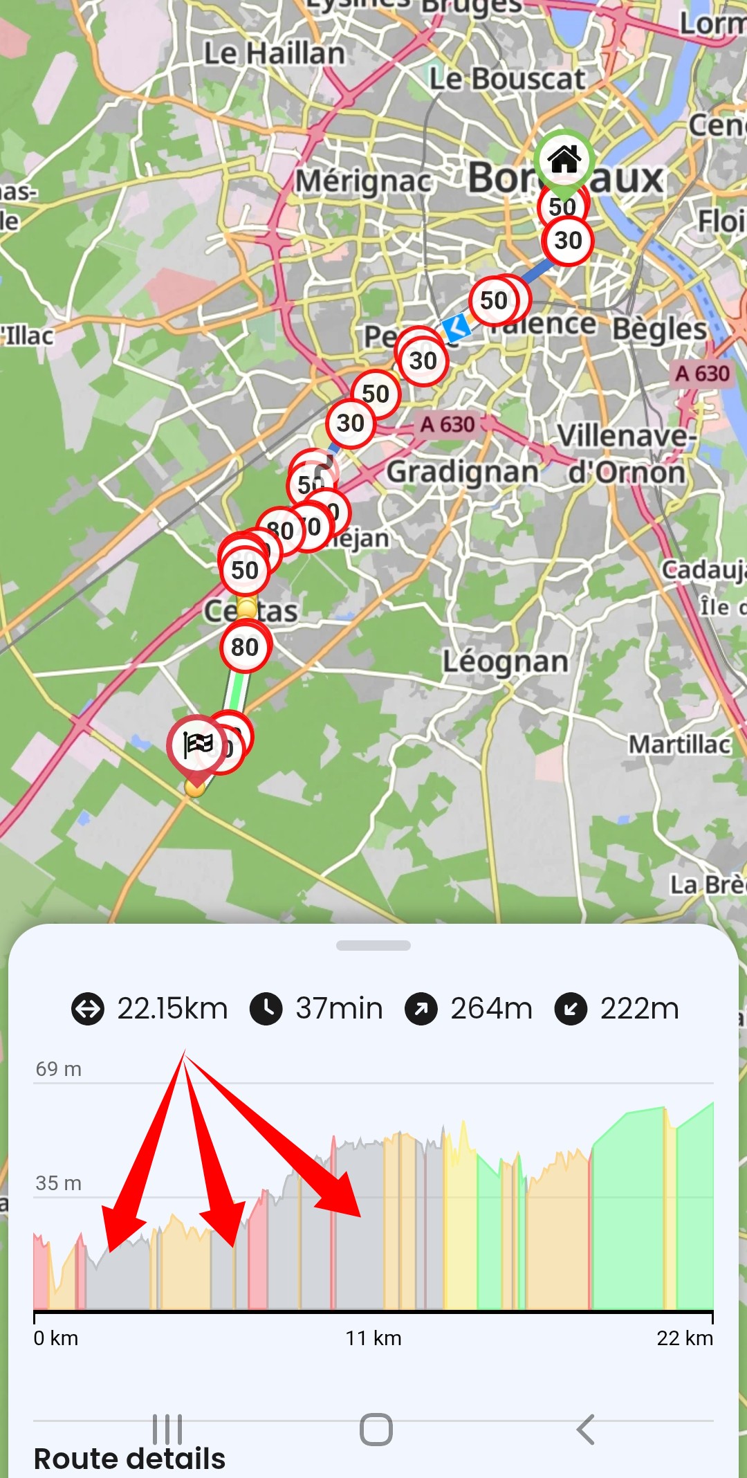

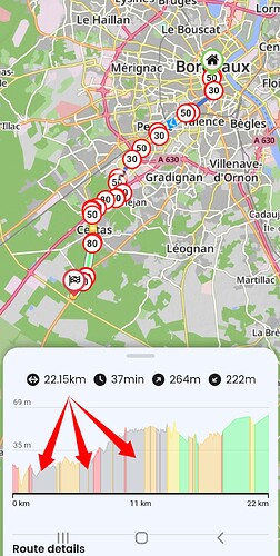

I just made a completely random route near Bordeaux. The gray areas indicate the sections, where no speed limit data is available in OSM. This random example indicates that there are possibly some mapping gaps around Bordeaux. It does not mean that it is like that everywhere in your neighborhood.
As I understand, the “maxspeed” is maintained for some way segments, while others are not. So the display changes to the question mark.

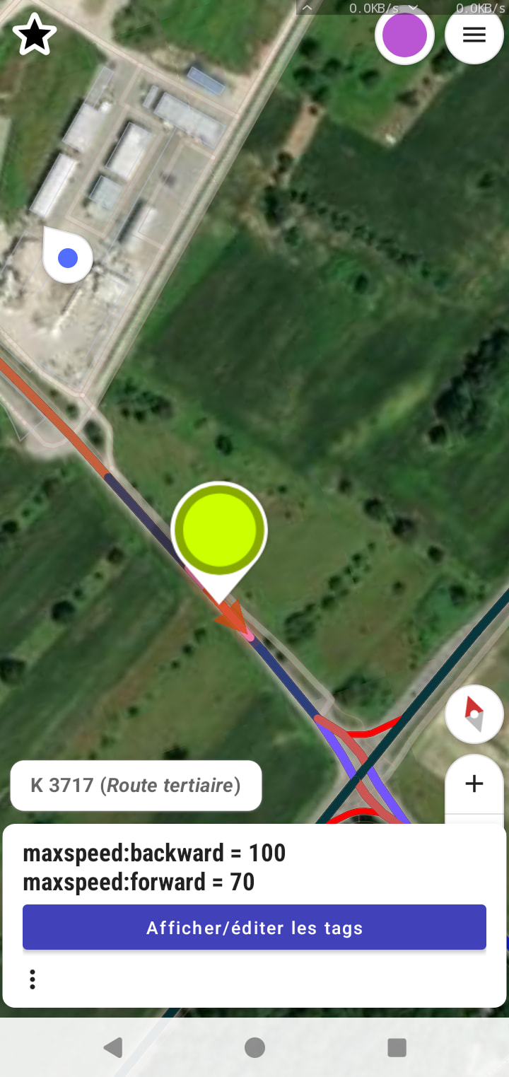

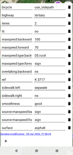

Kurviger is based on the data from OpenStreetmap (like most other Navigation apos, except from the really big players). You can read this thread to check if this could be something to put some free time into (mainly reading the guidelines for all the tags, checking how other mappers are working, understand special cases).
The example is for surfaces, but is valid for any other tag used in OSM. Introduction OSM: App StreetComplete and SCEE
From SCEE
OSM Data
