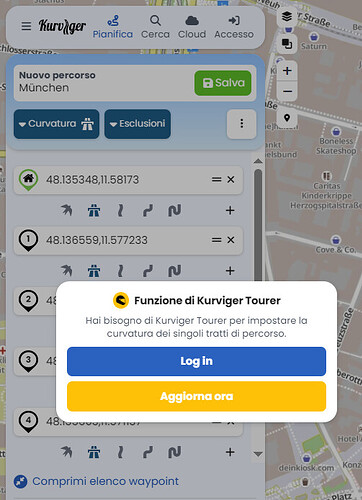

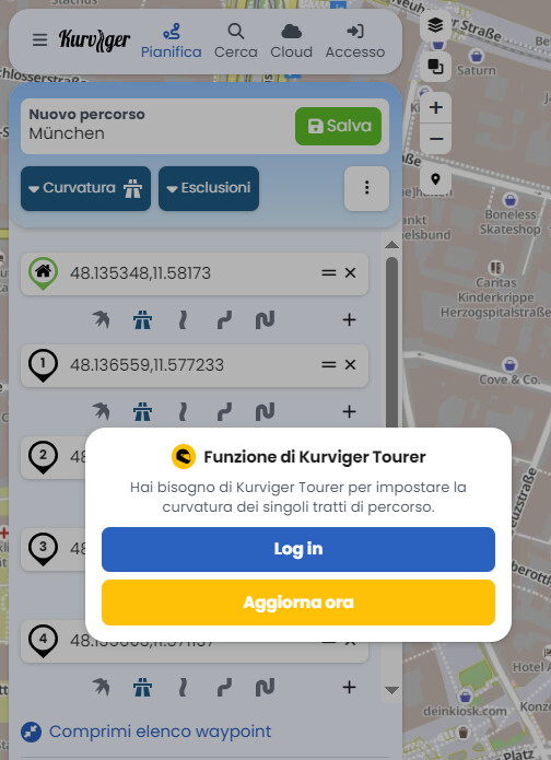

The beeline function is only available if you have a TOURER subscribtion.

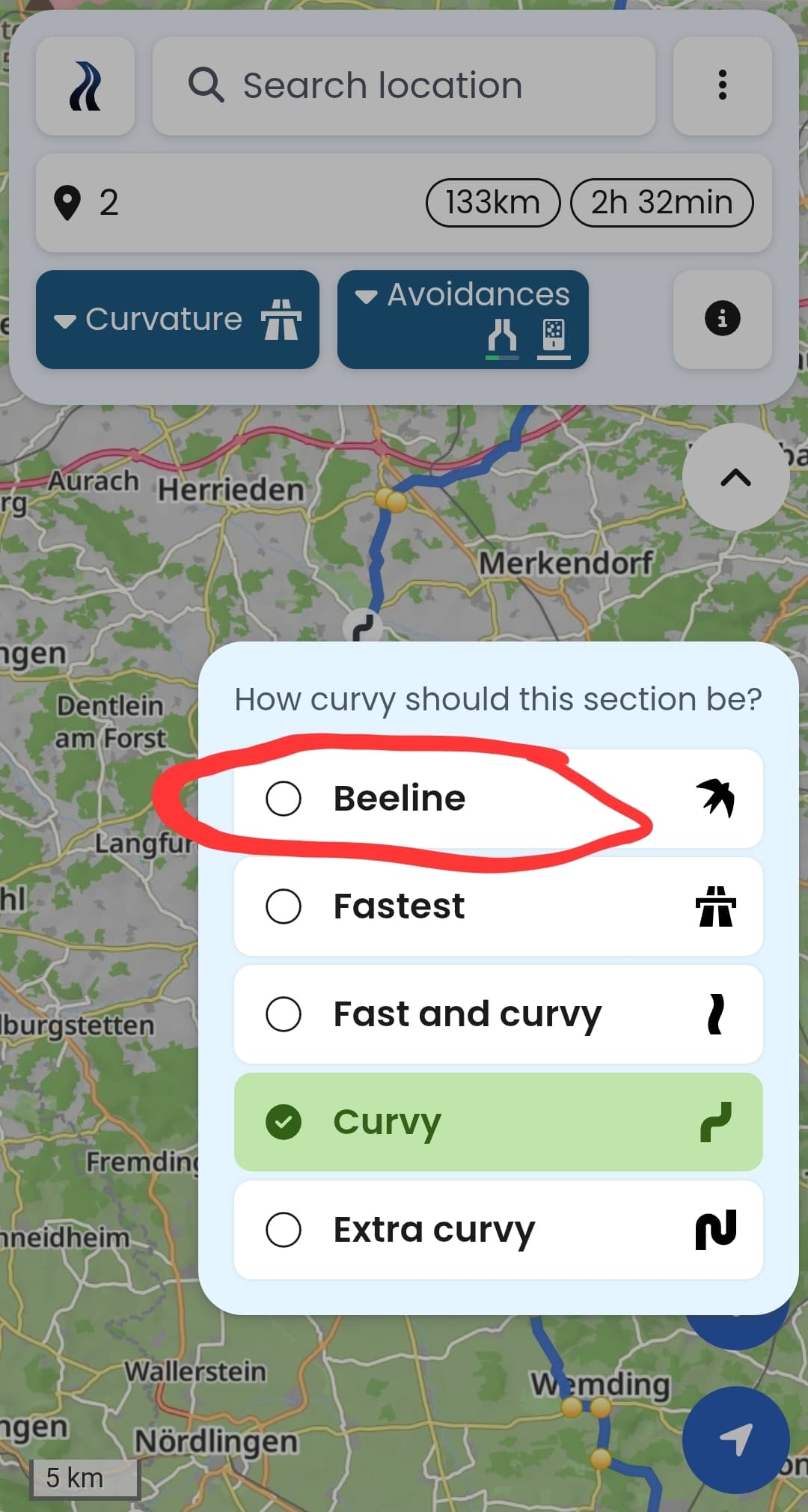

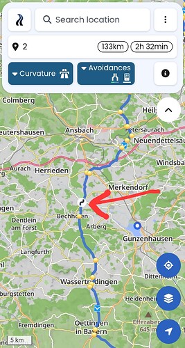

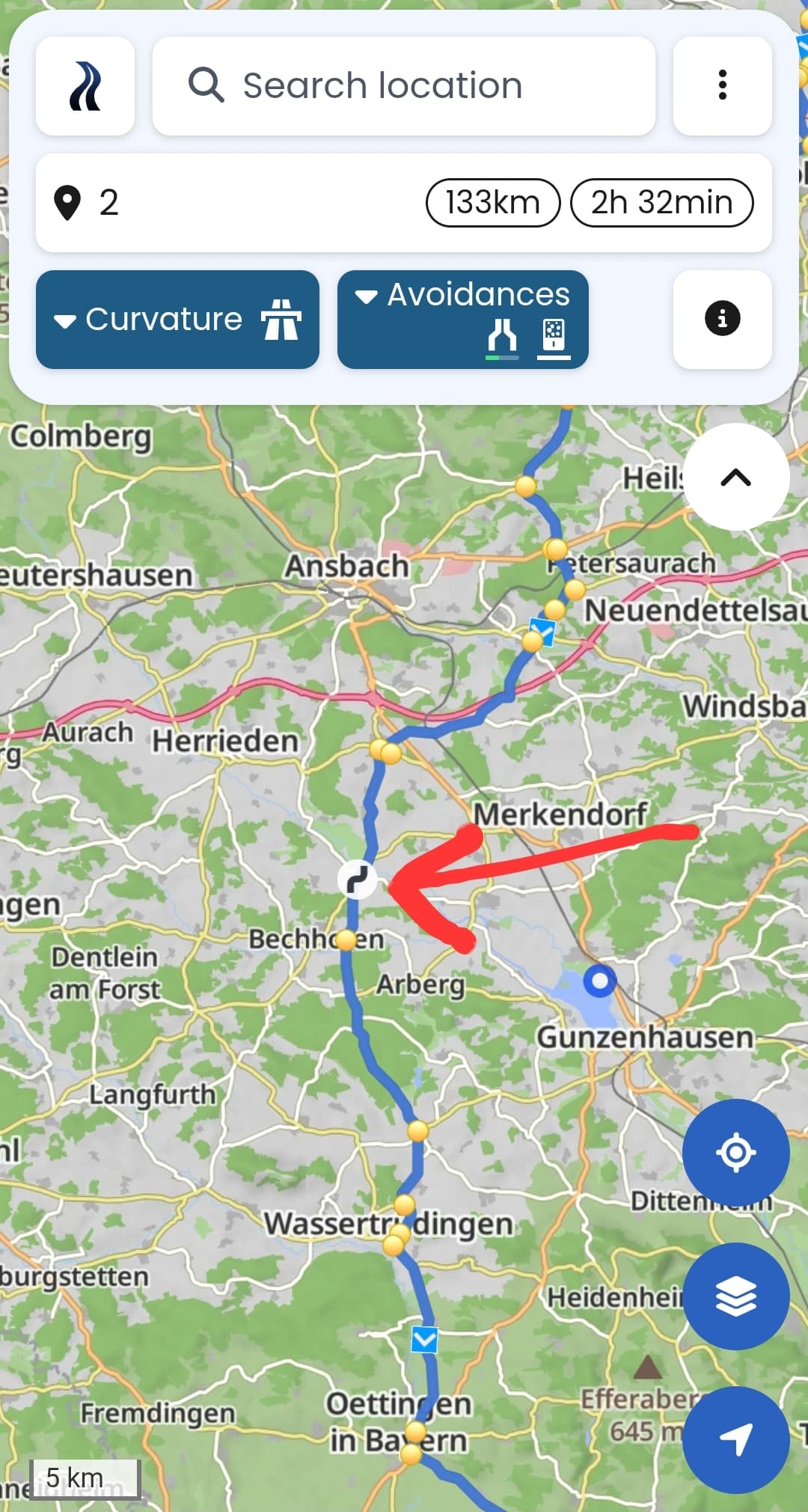

In the app (provided you have Touerer subscription), you will find it here - click on the round symbol in the middle of a route section:
A menu pops up where you can select the beeline.
I do have a Tourer, and got it, I’ve found the beelines option with your directions.
I’ve been looking everywere, but in the section circle.
I’ll need to set to point in a LTZ, the app will trace a straight line between, and THEN, clicking on the circle, I’ll find the Beeline (with a bird symbol).
