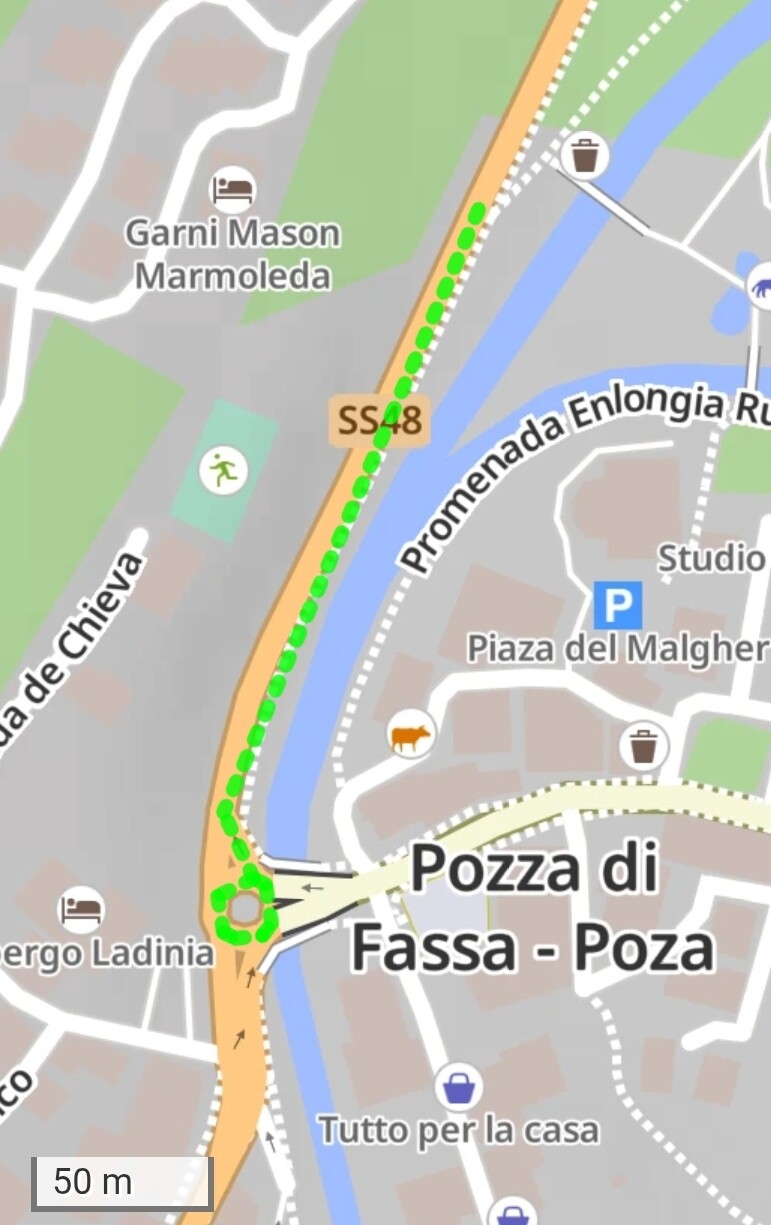

Strada Dolomites correction (not one way) at Pozza di Fassa
It was tagged “oneway:no” four days ago, probably in attempt to fix the issue, but before that it was not tagged with “oneway” at all. My maps are from yesterday [19.07.], so the “oneway:no” is probably already in them.

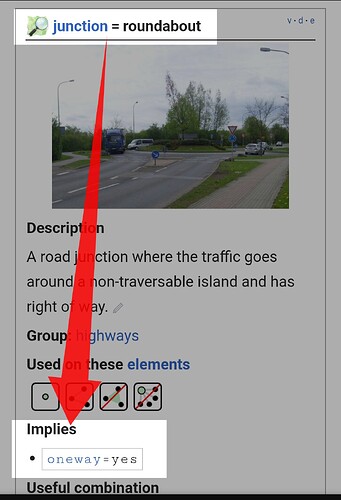

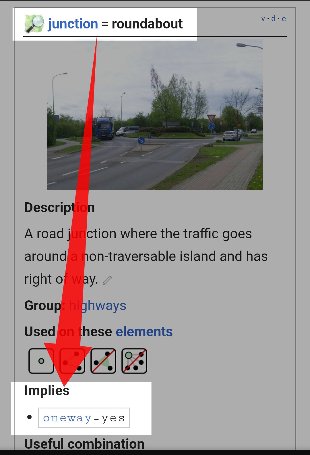

Can you please check with overpass the roads for junction = roundabout? A lot of ways are (possibly) tagged not correctly.
Good spot:
Here the result of Overpass Turbo:
export.gpx (1.1 MB)
Added as an overlay:
Deleting the “junction=roundabout” on the straight part of the road would solve the problem?
UPDATE: added note to OSM.
Roundabout tags on straight roads are wrong → I removed them and marked the note as solved.
