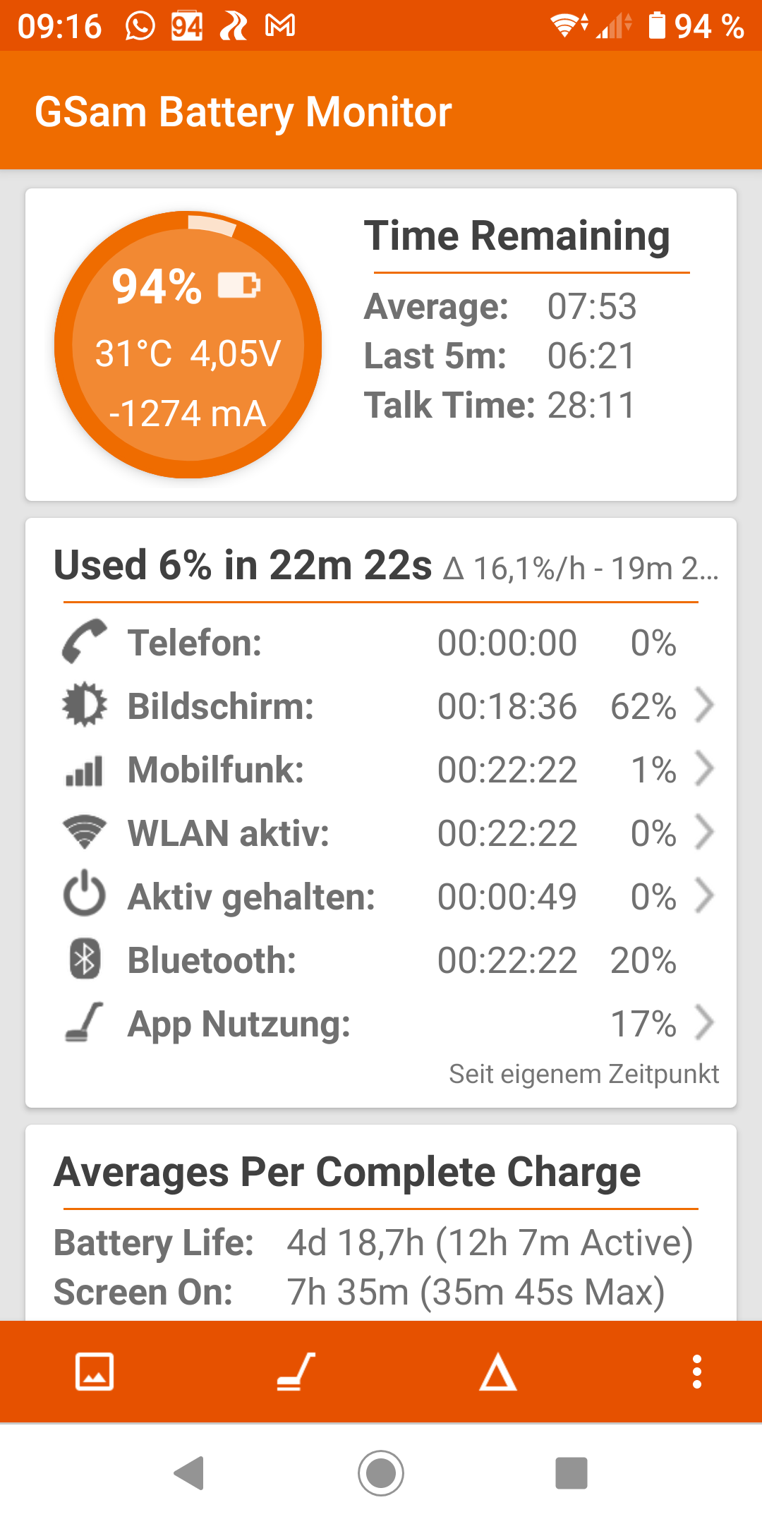

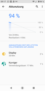

Today I’ve driven just 12 km (fuel is expensive in these days
) and captured the power usage. I didn’t charge the smartphone (Sony XZ2, Android 10) while driving. Here my results:
Sure that the display takes most of the power. Unfortunately the Gsam App combines all Apps to one figure (I’ve not rooted my smartphone).
