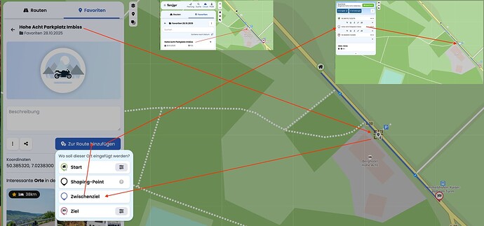

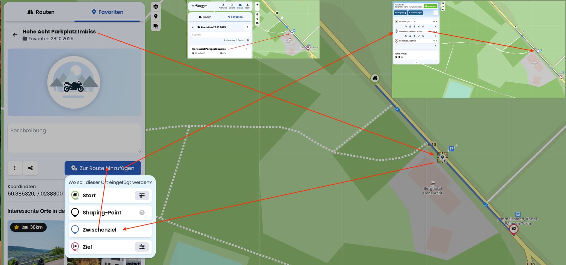

  2. How can I copy and paste (or drag and drop) waypoints from the Kurviger “Favorites” area into a Kurviger “Route”?
