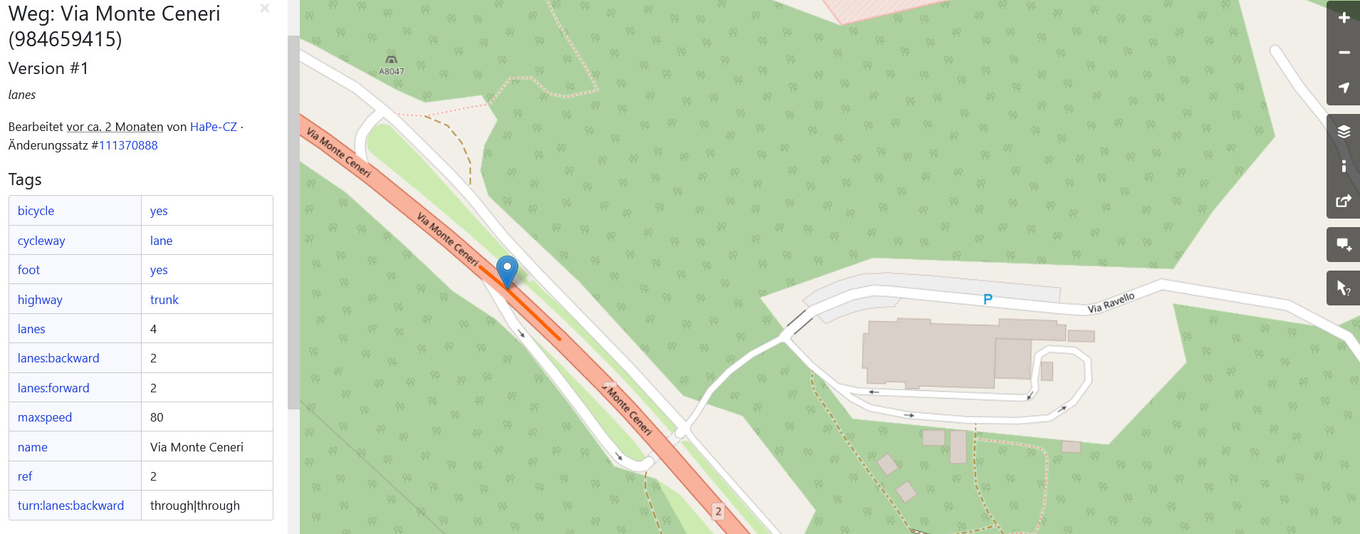

OSM zeigt kein potentielles Problem an der Stelle (siehe screenshot).

OSM shows no potential problem at the location (see screenshot).

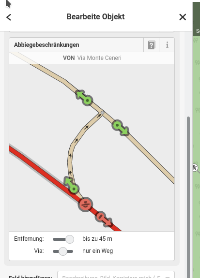

There was a wrong turn restriction here
I’ve corrected it.
It may take 1-2 weeks or so, until Kurviger updates its database.
