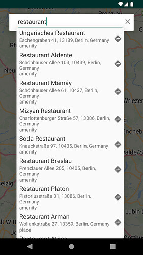

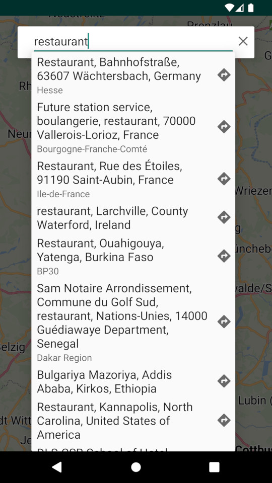

Search seems to work properly:
(if internet is available)

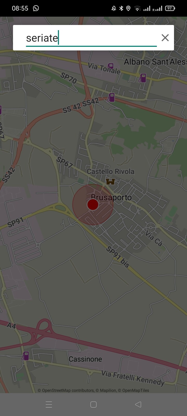

show us a screenshot of your attempt to search for an address
so we can maybe understand your problem better :wink:
This is the screenshot as you can see no results from the search bar

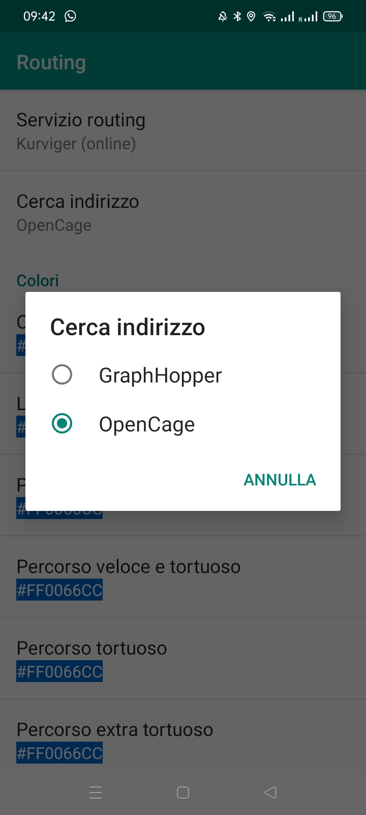

PROBLEM SOLVED :grimacing:
The problem was here
Was set on GaphHopper despite to OpenCage

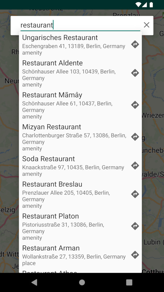

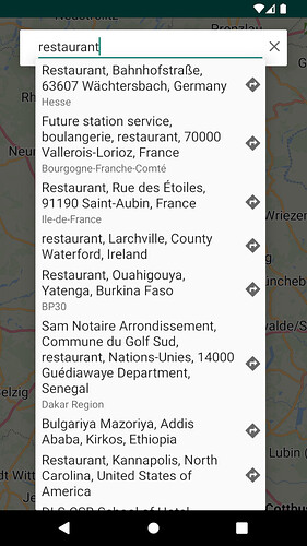

OpenCage also seems to work:
