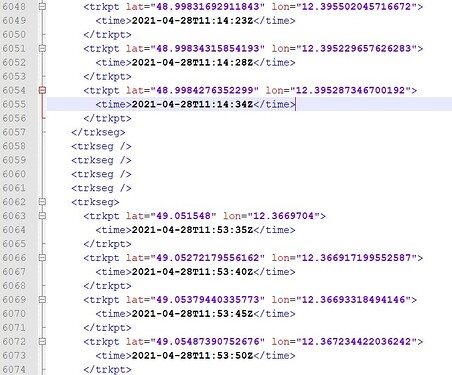

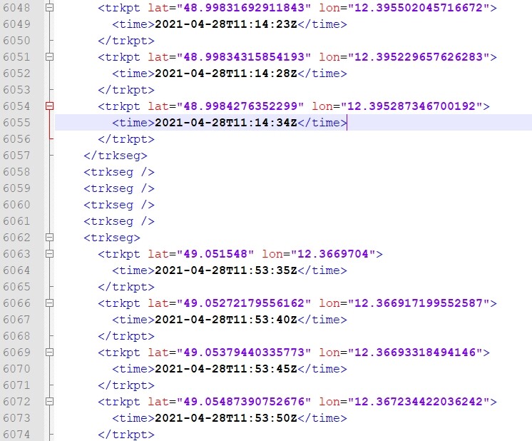

But another detail - kurviger was recording GPS data and the original file shows the following for the time of the failure (the break was longer, we took lunch as well):
(screenshot of NotePad++)
Perhaps it gives you a hint, Emux … :neutral_face:
It not removed from recent apps, then apps just resume their previous state,
they do not do a fresh start.
This looks like consecutive starts / stops of GPS logging (by who?).
Quite sure not to stop/start GPS recording - since this wasn’t my problem …
But I did several stops/starts of the app itself, may be these caused the entries.
