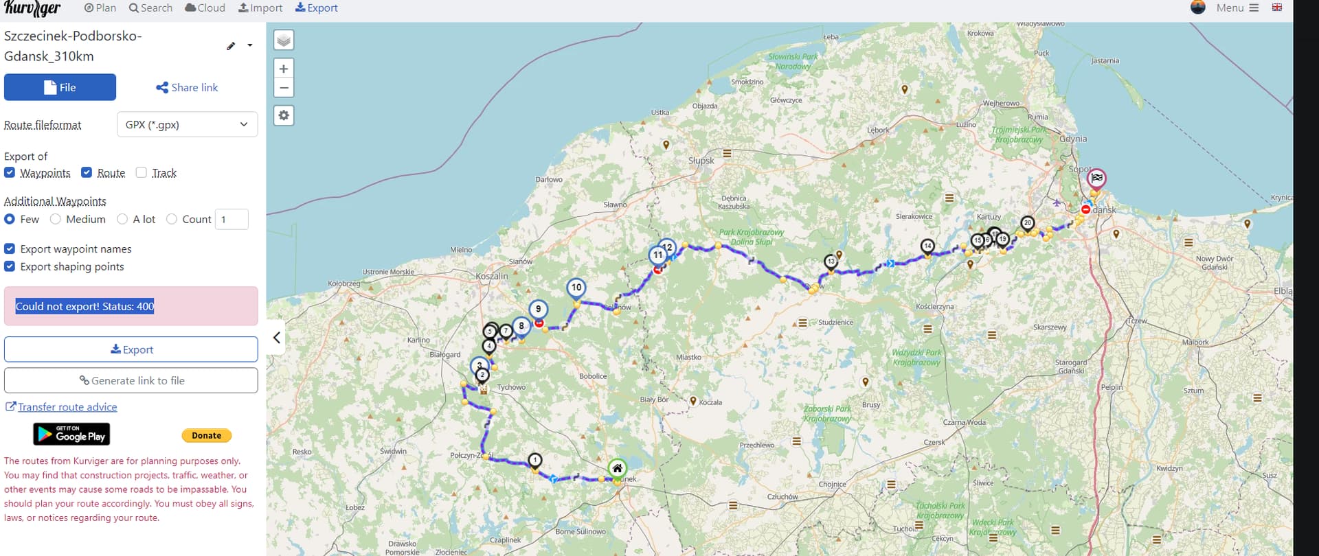

Problem with the export of a route "Could not export! Status: 400"
I receive the following error message if i export a route. “Could not export! Status: 400”
Know somebody a solution about that?
Regards
Alejandro

Hi all, I cannot reproduce this on the website currently. I tried with the exact settings that can be seen in @SimOn 's screenshot, even with quite a long route, but everything seems to work fine. Maybe there was a temporary server hickup? Can you confirm whether this is still happening to you all?

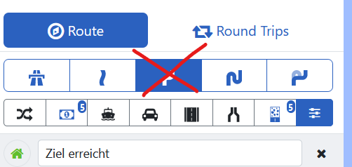

Edit: inspired by the 2 routes you provided and looked for the differences and the suggested weighting=curvaturefastest I saw the difference between the 2 routes.
One has the setting curvey roads, the other fastest. When you set the route calculation to fastest, the export works. Offcourse you might need to add some shaping points to maintain the route…
Hi, unfortunately same here, still can’t export this exact route.
Same problem here. Does not work with setting “curvy”, however fine withe setting “fast and curvy”.
@Venzent I run Inspect (Q) in FF to see whats happend. Under Network Analyse i can see the Get Request and it ist possible to copy the request for analyse and modify.
All planning models are working without curvy
In the curvy model the parameter weighting= xxx is missing
