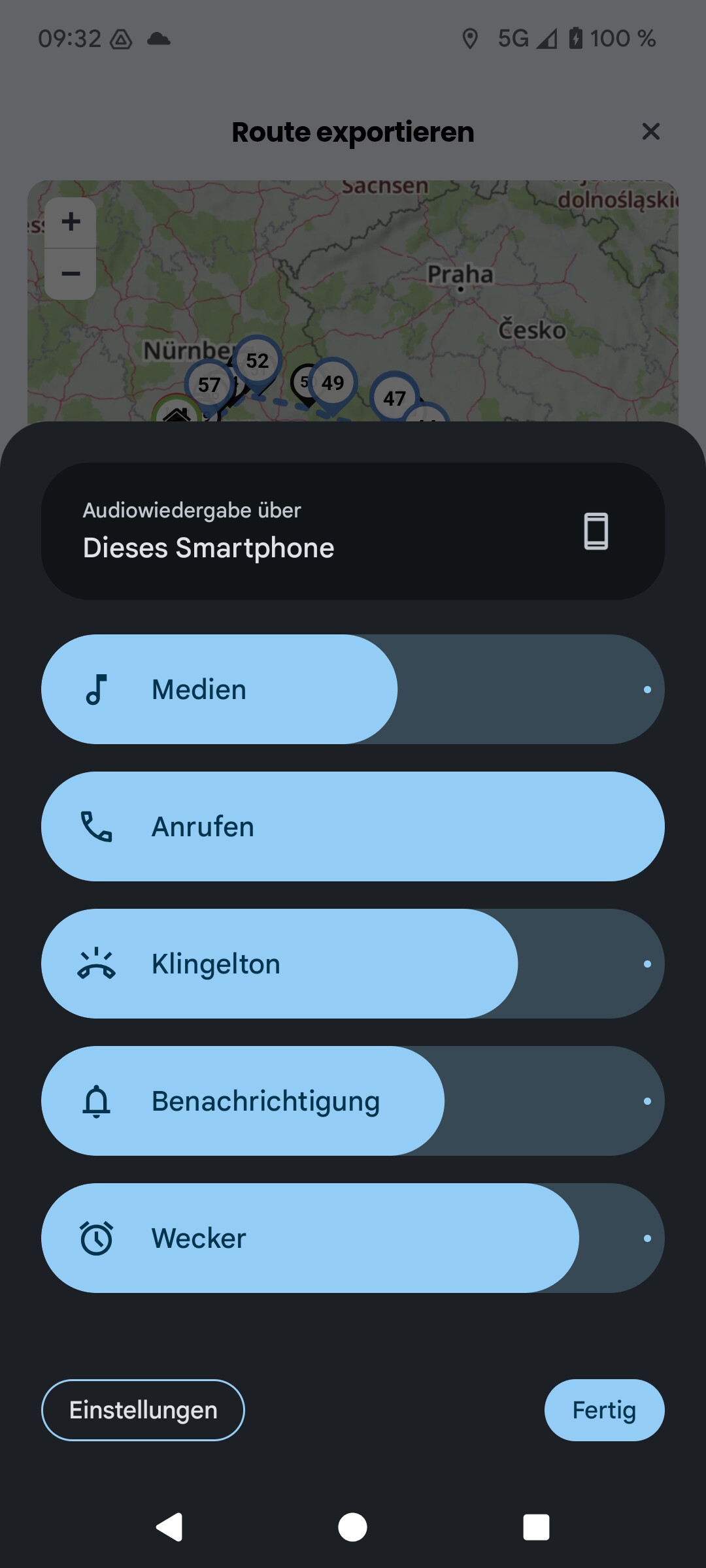

This is correct, this is possible with the calls channel. Android has at least three different volumes, sometimes more:
  • music
  • notificaiton
  • calls
You can change them individually, you would need to set music to for example 50% and calls to 100%. Here is an example from my smartphone:
