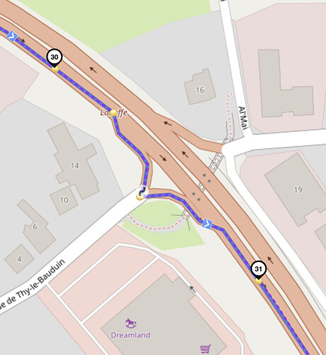

I want to remove a yellow dot on the map. I cannot seem to figure it out.
The route wants to got right and I want to go straight. Se my attachment.
I guess I could go on between 30 and 31?
Hello
You cannot move yellow dots. You can only move dots with a number, as in your example, because this is a waypoint (SP or VP).
However, you can also change the curve to fast (highway symbol) between points 30 and 31.

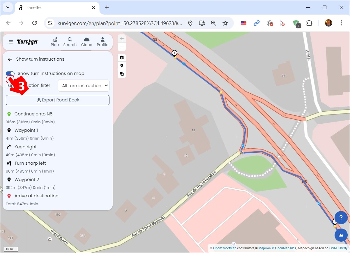

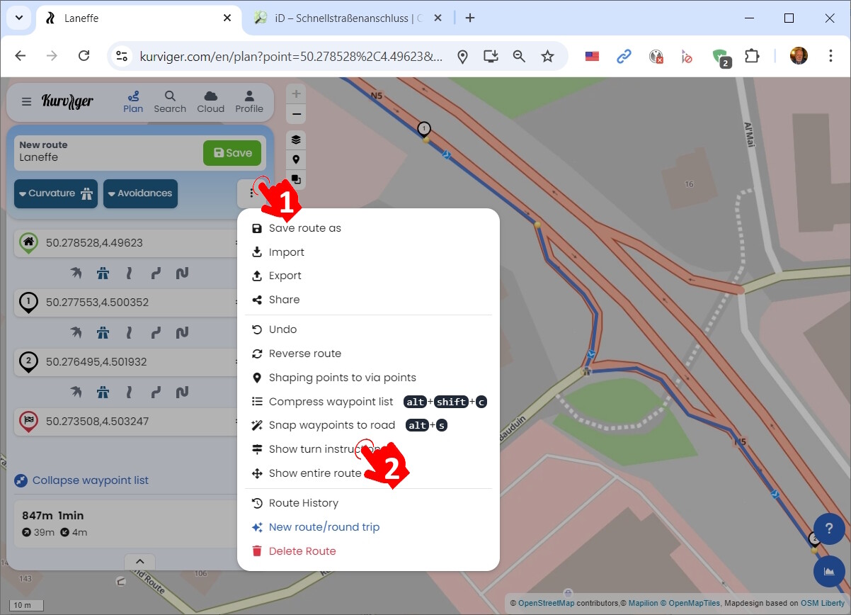

You cannot remove the yellow dots, but you can make them invisible:

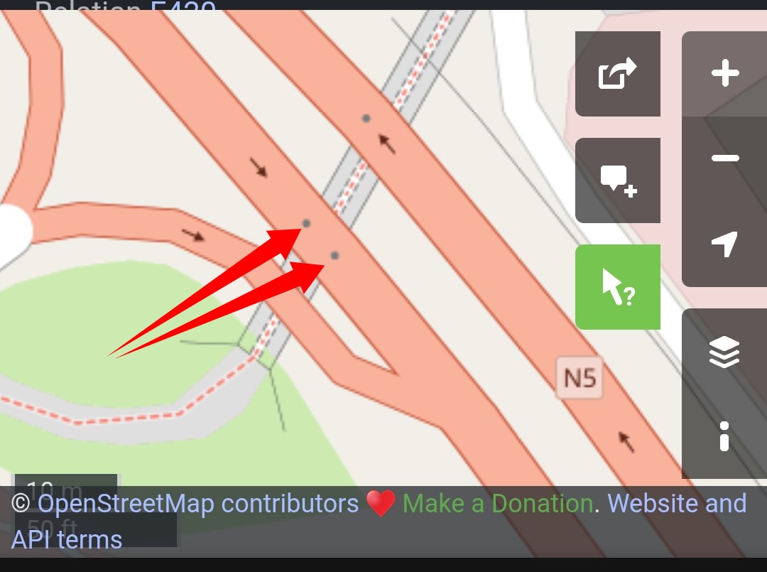

Could these bollards (Node: 1126401952 | OpenStreetMap) be the problem (i.e., OSM error)?
I do not think they should be associated with the N5 road.
Also, the turn Kurviger suggests should be illegal - also here OSM could be updated.

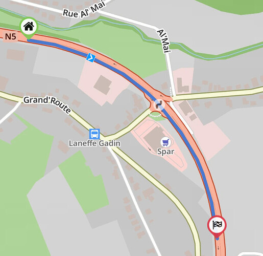

Thank you, and in this case, the problem lies with OSM. So that you can continue planning without having to wait for a possible change at OSM, use a straight line between the two points.
https://kurv.gr/e793z

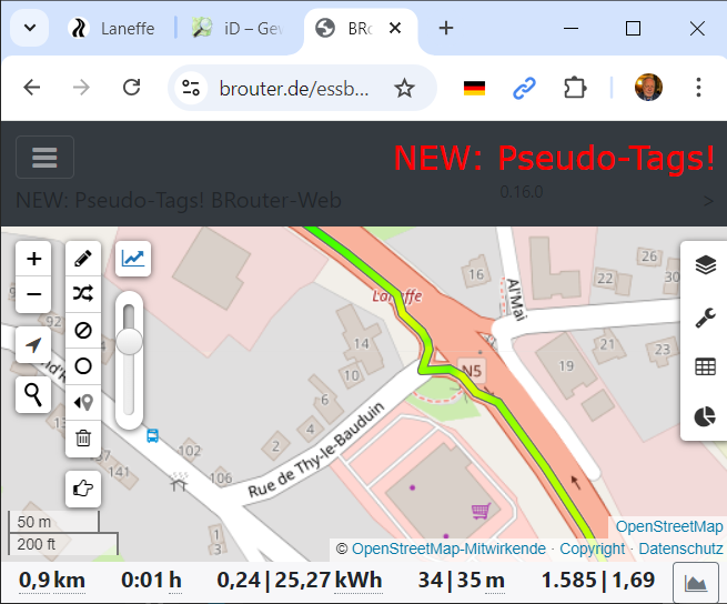

That could be true … even BRouter takes the “detour”:

Corrected in OSM, it works now: https://kurv.gr/AB7dH
