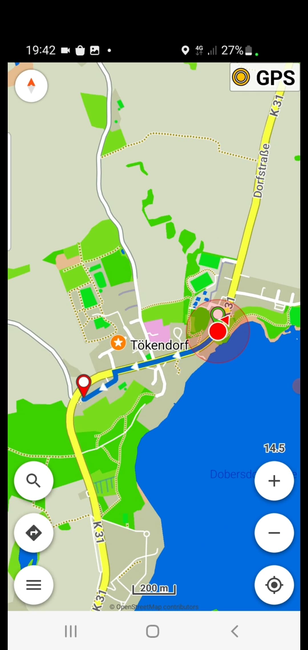

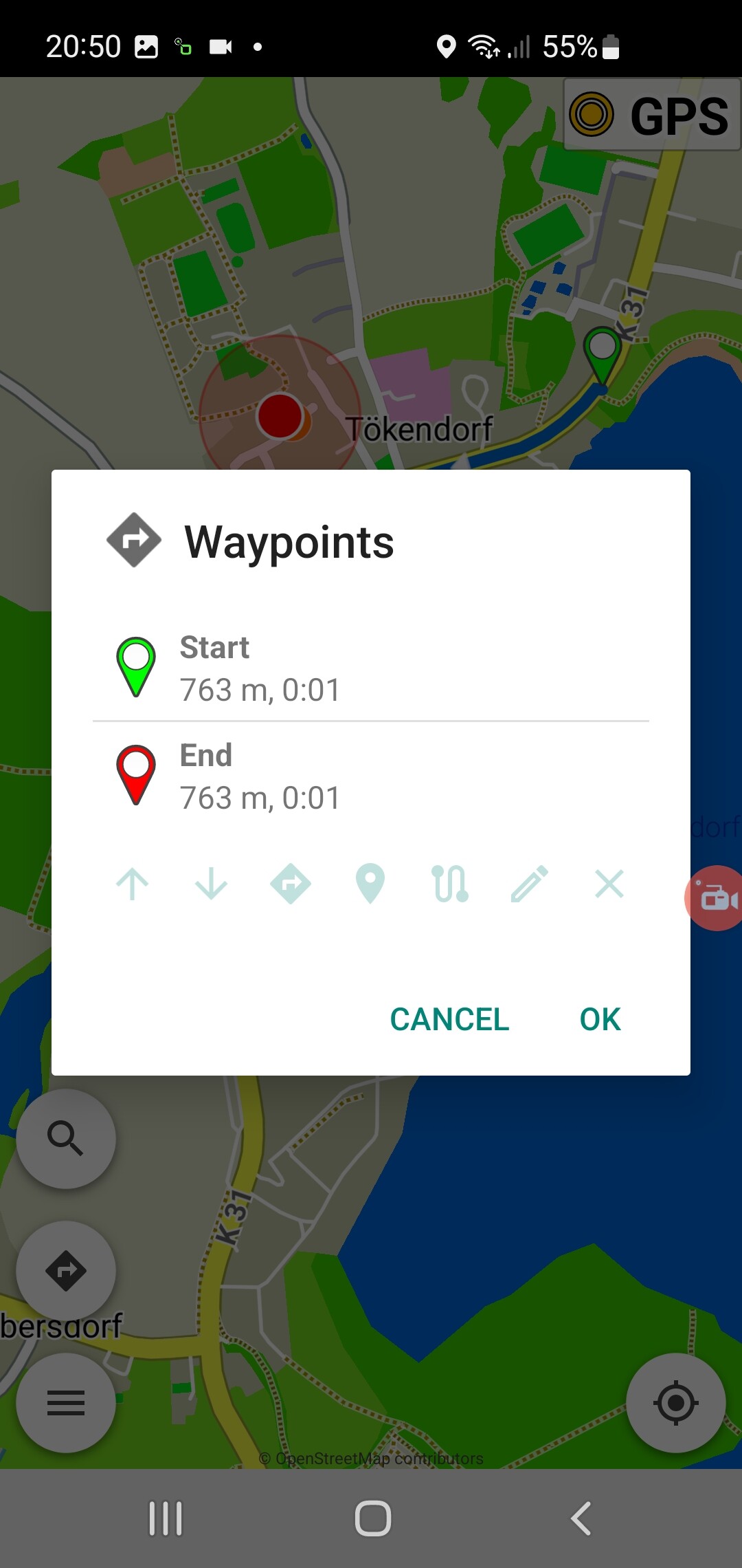

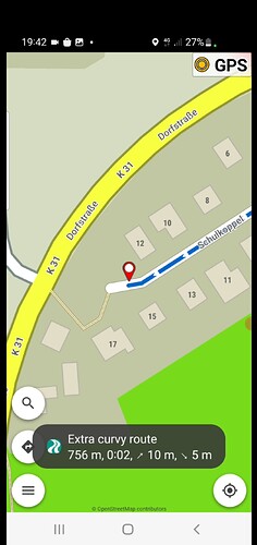

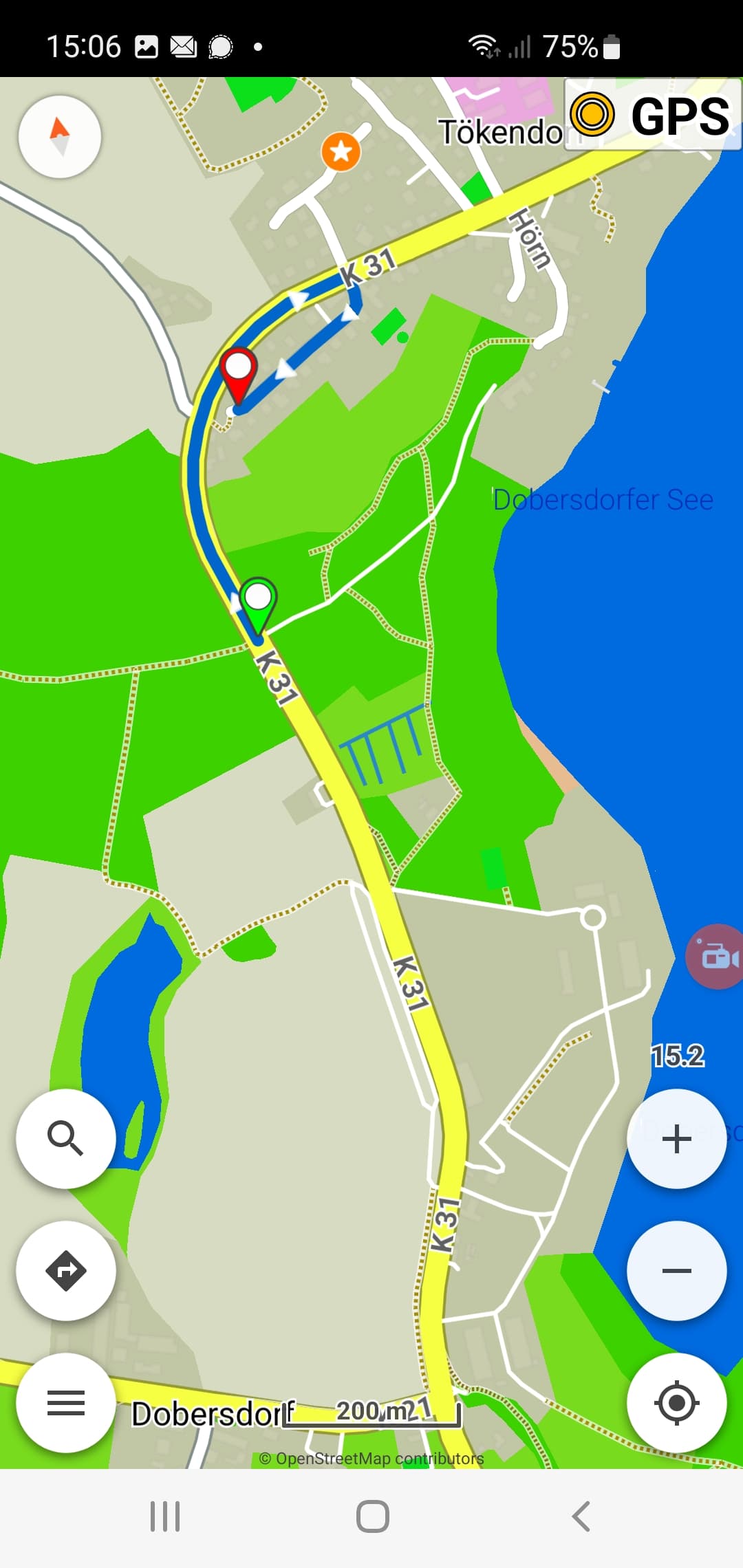

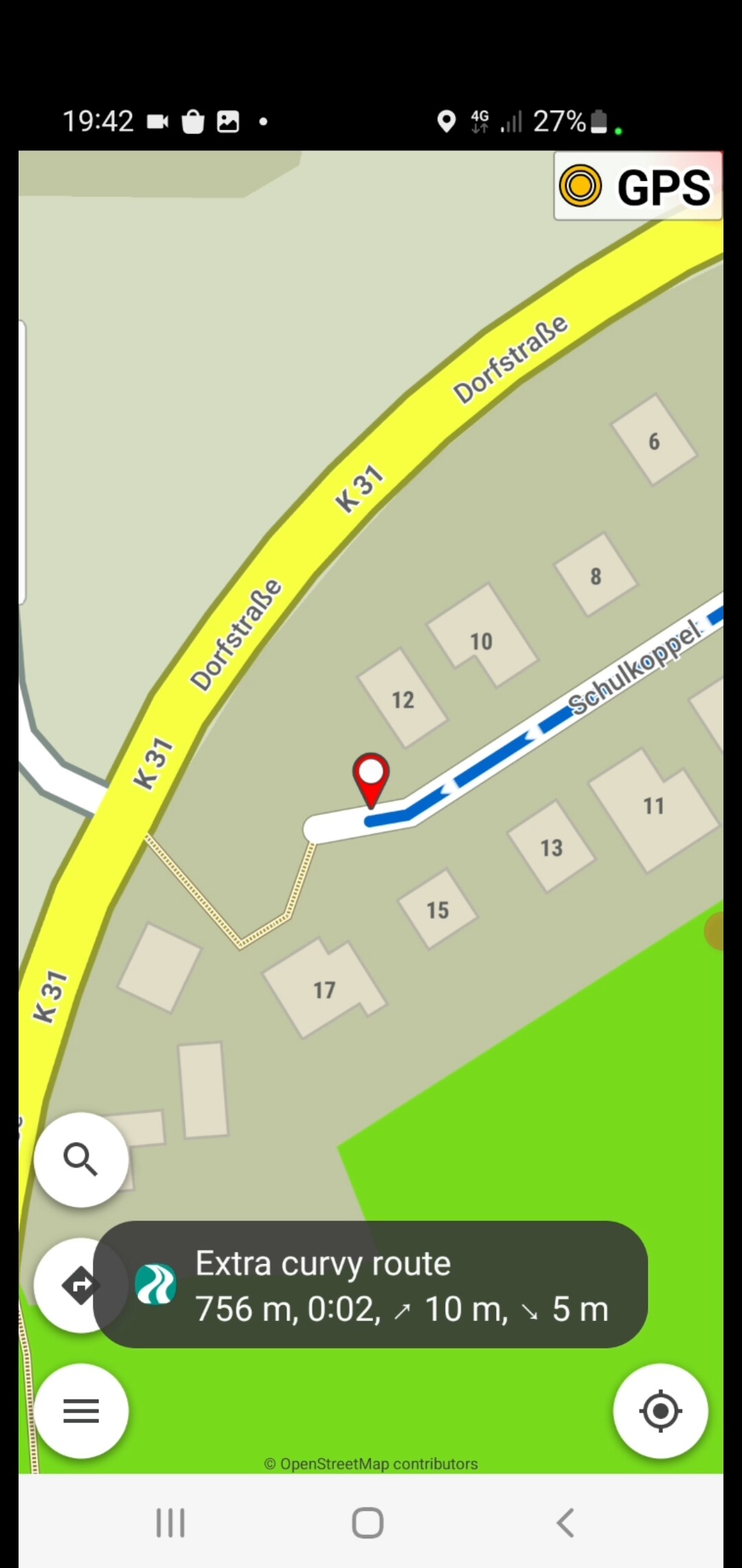

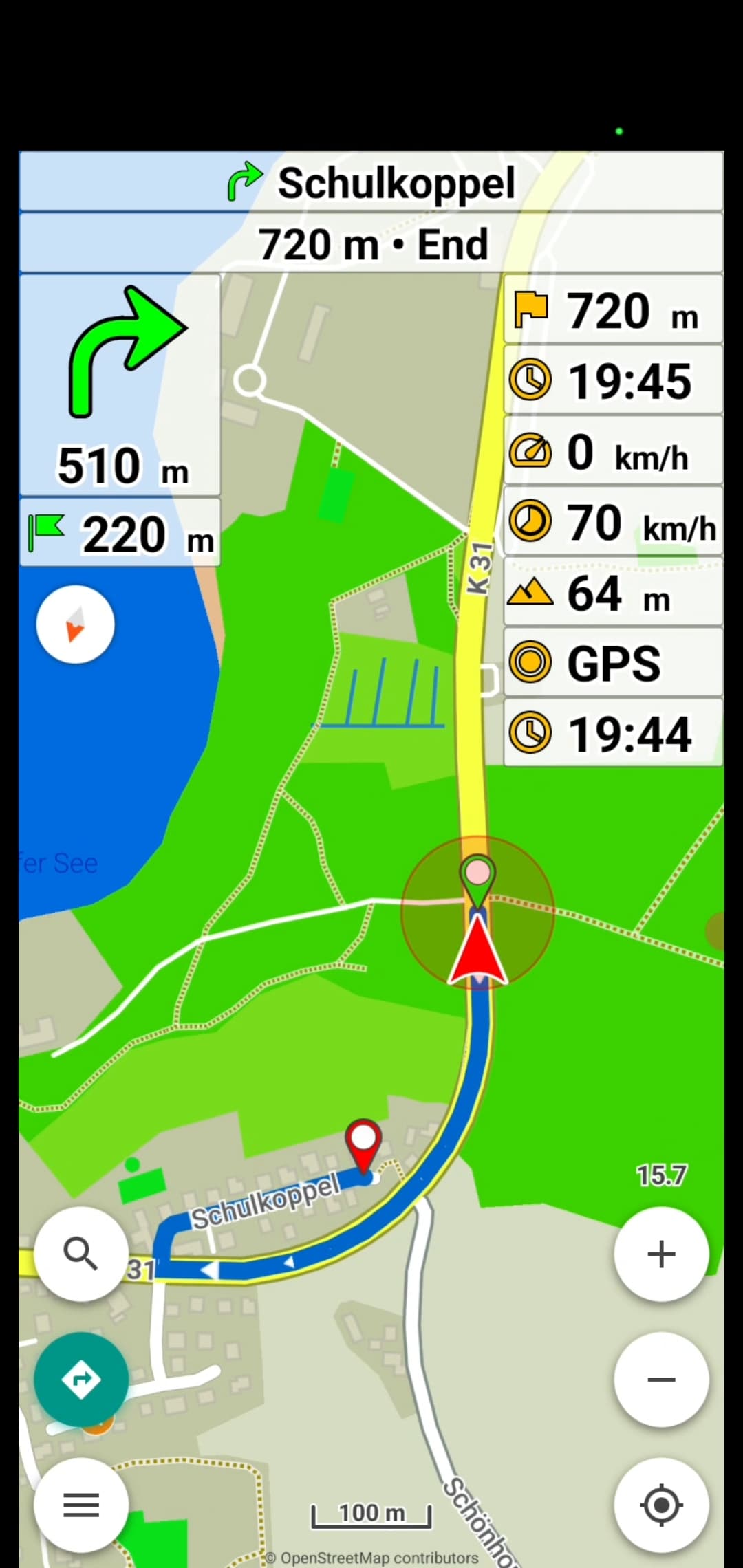

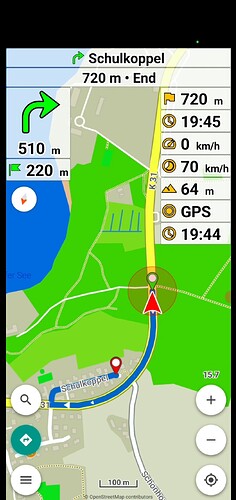

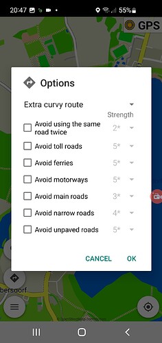

Here is my simple route created in the app. I have Internet connection.

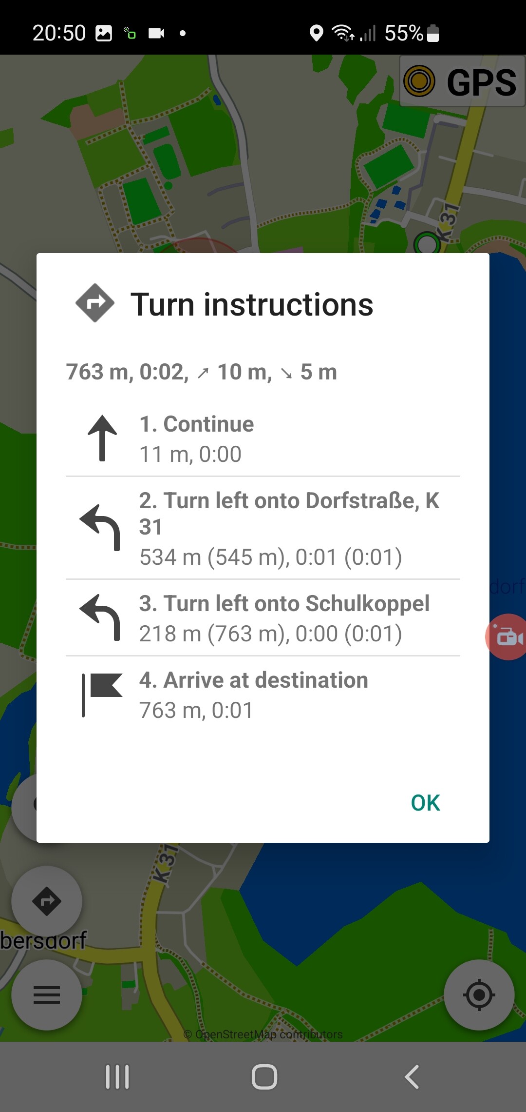

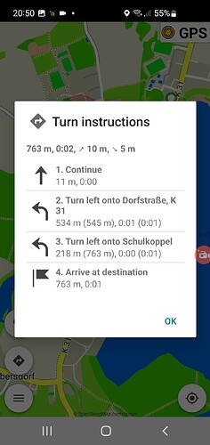

1.) Creating a very simple route
2.) Complete route before starting the tour.
3.) Still on the right way

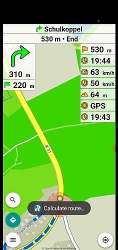

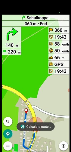

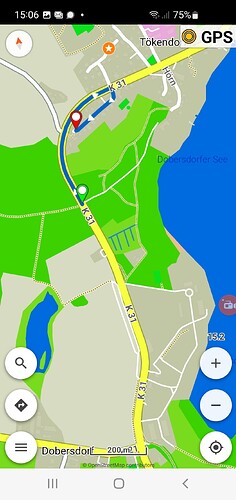

4.) Just turn missed! The route is recalculated. No further voice instruction!
5.) Re-calculate the route again! No further voice instructions! I’m getting further and further away from the destination because I still drive in the opposite direction related to the re-calculated route!

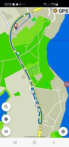

6.) Driving stopped. Route overview.

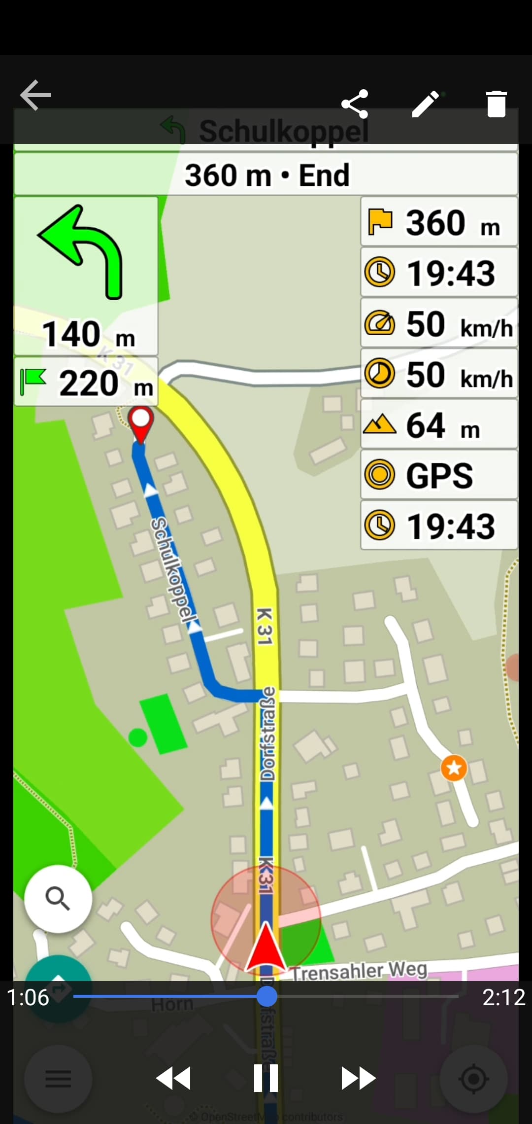

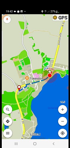

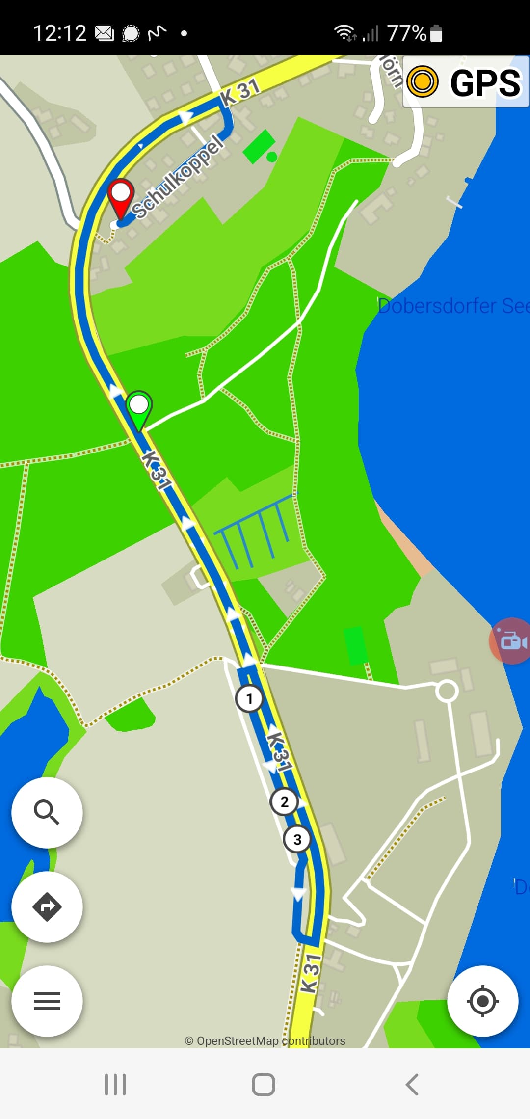

7.) Again, the situation after several root re-calculations.
8.) My old navigation app Navigon, which I cannot use any more, gave me instructions how I can change my direction in this case. Found a new way.
9.) More detail.

Rerouting ON and the “snap to route” (visual) ON.

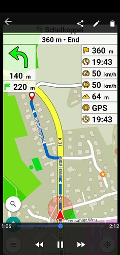

If you miss the turn, the distance indication to target (Finish) suddenly increases. THE APP (not the router) could generate a “return” even before the first recalculation trigger.
However.
An additional difficulty is that the road on which is driven stays close to the route. Therefore the route design sometimes remains just in the “snap to route” navigator catch range. (Even with visual snap to route display off, this function still remains).
The navigator therefore wrongly thinks it is on the route. As a result, the navigator presents itself very confusingly for a while. A stable distance indication increase to target (Finish) is only there once you are out of the “snap to route” range. If the route and the road you are driving on are further apart then, it is more stable clearly.
Therefore, here is a slightly different demo route design where the “snap to route” function does not cause any additional confusion.
Example 1.
You miss the turn and so you drive wrong. The distance counter to target (Finish) then increases, and the app notices this. If the distance increases and each time the “snap to route” is then released, could the app possibly generate a “return” alert even before a recalculation is triggered?
