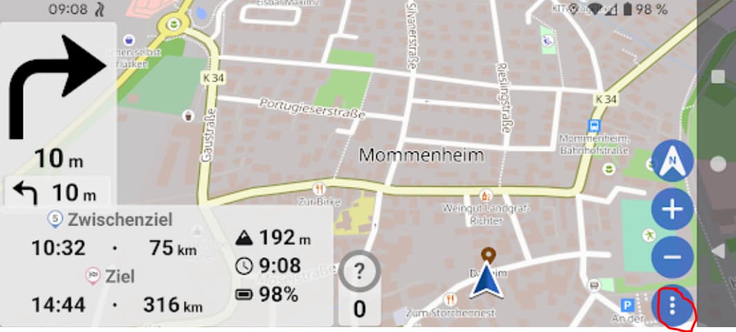

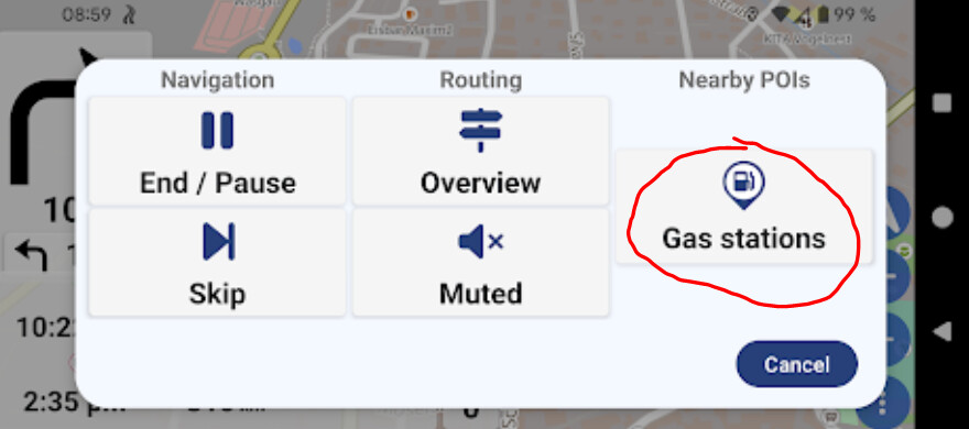

Did you do that in navigation mode by tapping on the 3 dots? Should look like this:

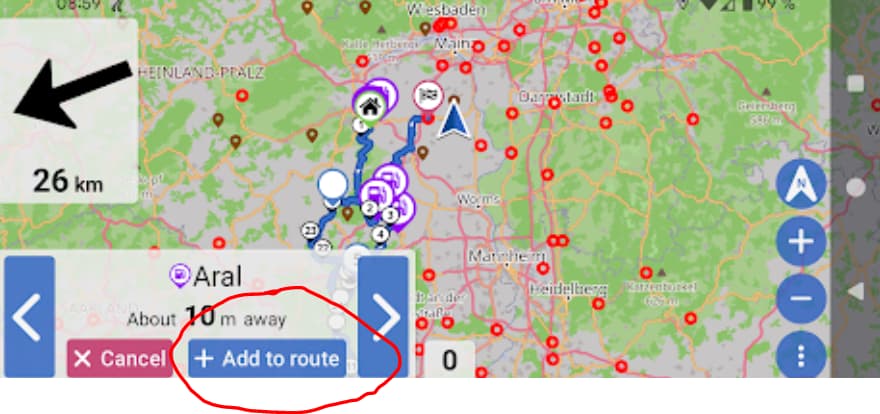

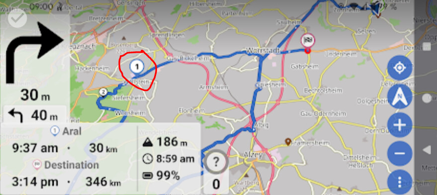

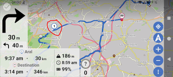

After tapping on the ‘Add to route’ button the gas station is added to the actual route
So there should be no significant change to the originally planned route.

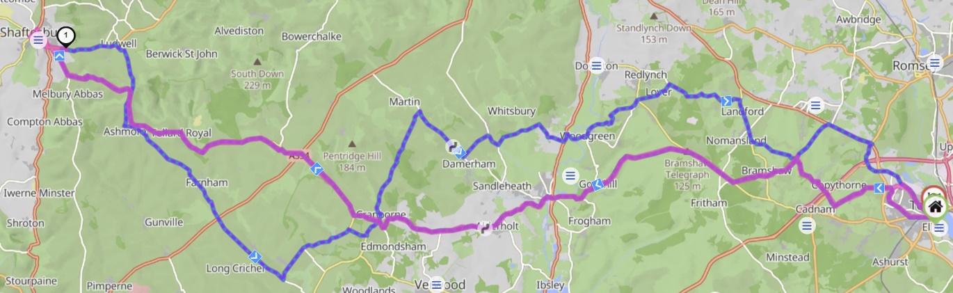

I did exactly that to find the nearest station. The recording looks like this: (blue was planned return and pink was as navigated back on the way I came from. When planning I set avoiding using the same road.
Hi Pikor,
I see only one shaping point. As your destination point varies from starting point I think the algorithm sees this slight deviation as a different route.
My recommendation: set some additional shaping points on the complete route and the problem should vanish.
