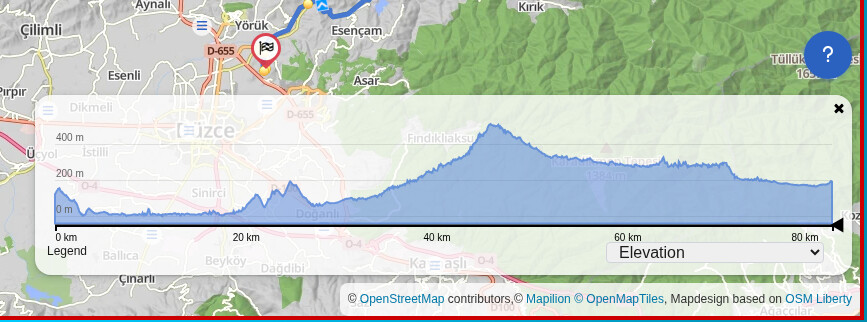

here:
like which section has asphalt which section is unpaved etc…

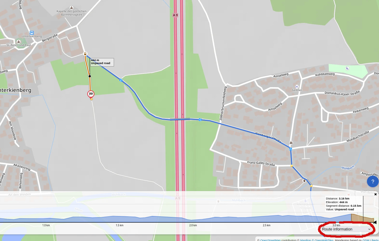

Yes, that is possible.
You need to switch from “Elevation” to “Route information”
Than the unpaved sections are shown in brown.
The information is as good as the map data in OSM

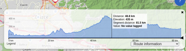

what is the issue here? on osm it has complete data, i double checked it
can you share the route example?
What part do you think is unpaved?
Remember that Kurviger can only show unpaved sections if they are correctly tagged in OpenStreetMap (OSM).
There are no unpaved roads on the route. I was just checking to see if there were any. If Kurviger only shows unpaved roads, then that makes sense.
Beware that Kurviger will only show unpaved roads if they are tagged accordingly in OSM. If the road surface is not tagged at all (e.g., in Turkey this might be the case), Kurviger will display those sections in blue color as well. So, you cannot always rely that everything is paved if everything is displayed in blue.
