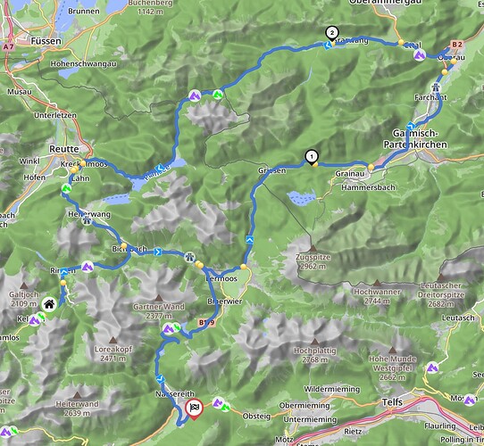

Kurviger won’t just randomly alter ShapingPoints. SPs can be skipped, this typically happens for loops where on the whole loop there are only SPs like here:
If you ride from start to destination, ignoring the SPs then the SPs will be removed.
