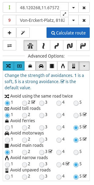

Looking at your example route, you have used features of the “Kurviger Tourer” subscription.
E.g. changed the strenght of avoidance.
This new features are only available in the new Kurviger App subscription.
Now you have 2 options:
  1. If you stay with the (old Version 1.x) Kurviger Pro App use *.kurviger files to transfer the route.
  2. Buy the new Kurviger App subscription (Version 2.x).
    It can be installed additionaly to the old Kurviger pro app 1.x

I generated a really long trip (~2200km) and if I share it with my Mobile using the link,
it differs from the one in the WebApp.
Every Waypoint and Shaping Point is correct, but the route between is quite different.
Until now I could use the Kurviger Short Link and got 100% the same route.
Opening the link in the Webbrowser on my Computer shows the correct Route.
https://kurv.gr/JTFFU
EDIT: Using the *.kurviger export file shows the correct route

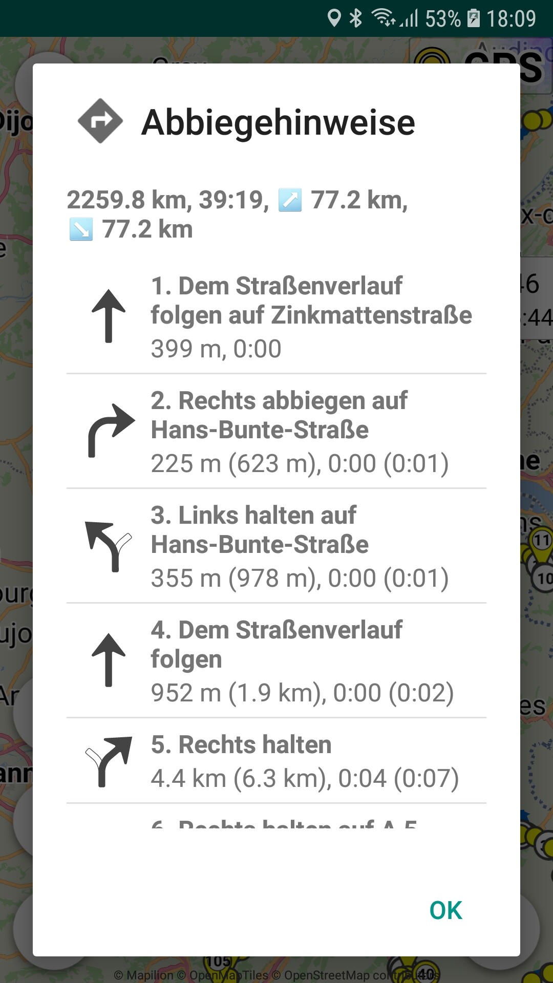

I tried your short link.
The difference can’t be big.
Distance in the website is shown as 2260km
Why do you think there is any change? Where exactly is it?
Do you see any difference in route options after loading the route?
Strange…tried to reproduce the routing error, but now with the exact same avoidance settings I get 100% the same route in Kurviger 2.
