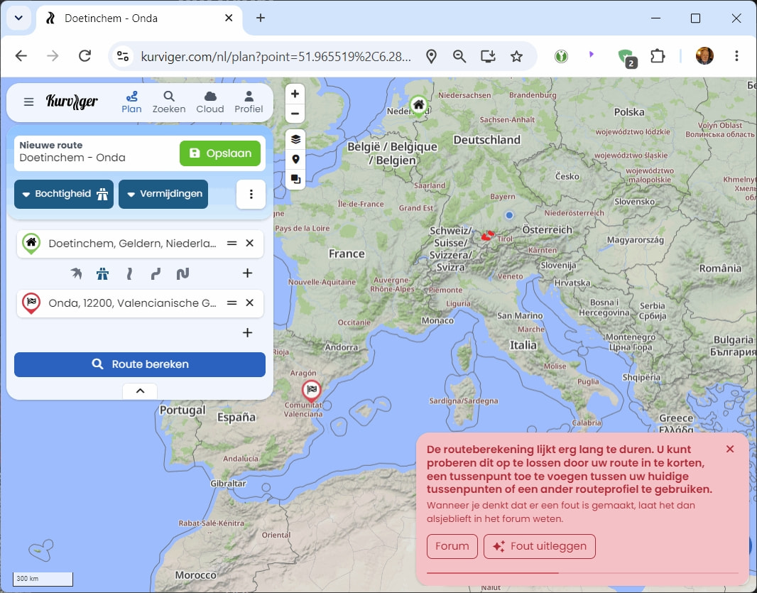

Kurviger cannot create a route from Doetinchem to Onda, Spain. The settings are configured for the fastest route and only unpaved roads are enabled.
What is the problem?

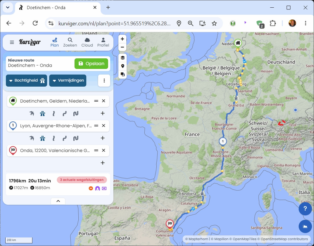

Hi @Gerard_Sloetjes,
You’ve already been given a few good tips. In general, we recommend breaking up very long routes into shorter routes.
The route you want is generally possible, but if you set many restrictions the algorithm will have a very hard time calculating a route for you.
