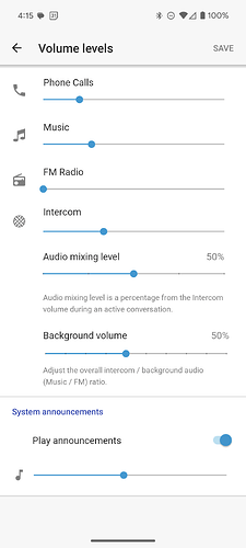

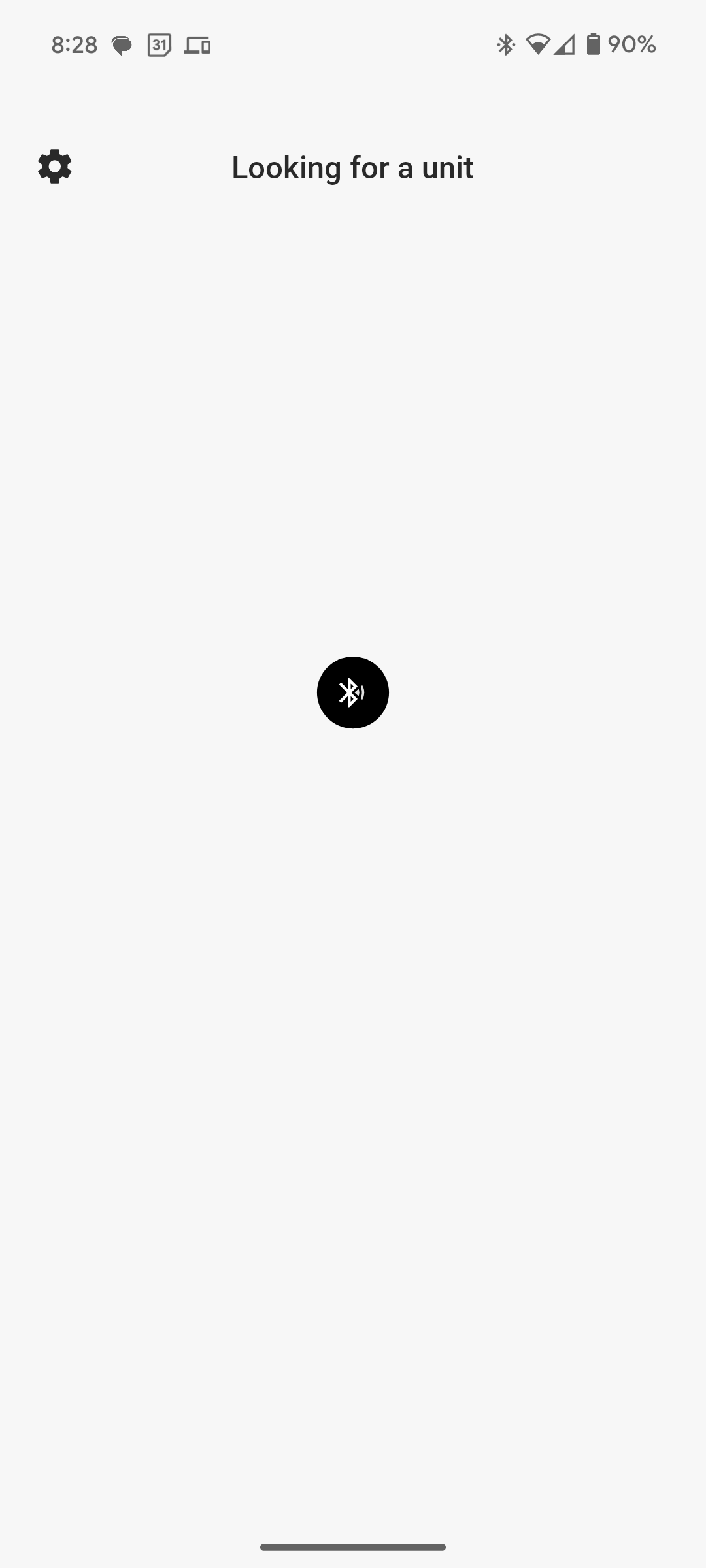

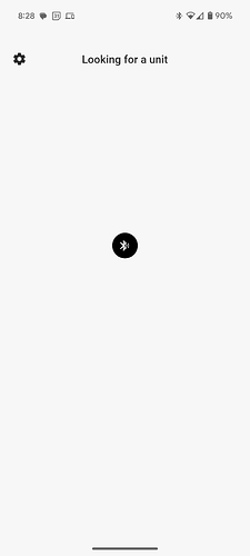

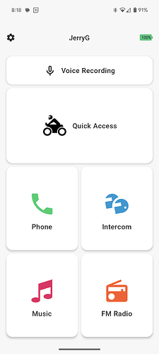

Your problem may be your intercom settings. I was able to fix my volume issues via Cardo Settings as shown in the picture below.
i didn’t have this in my android 14 settings…
My apologies. I’m not being clear. Let me add some detail. Get your Cardo unit and turn it on. Get your phone and open your Cardo Connect App on your phone.

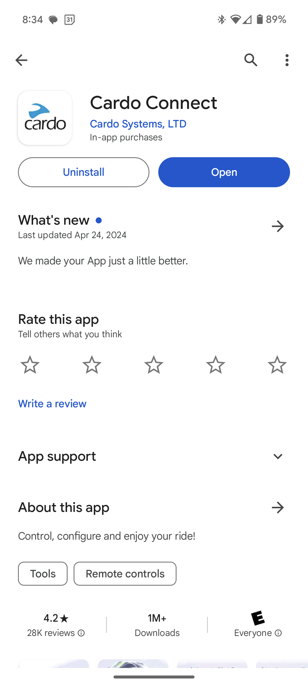

If you don’t have the Cardo Connect App on your phone, go to the Google Play Store; find it by searching on “Cardo Connect”; and install it. Once installed, open it and it should automatically connect to your Cardo unit as long as it is turned on. It’s been awhile since I went through that process for the first time, so there may be some steps to doing that. If it doesn’t connect, completely close the app and reopen it.

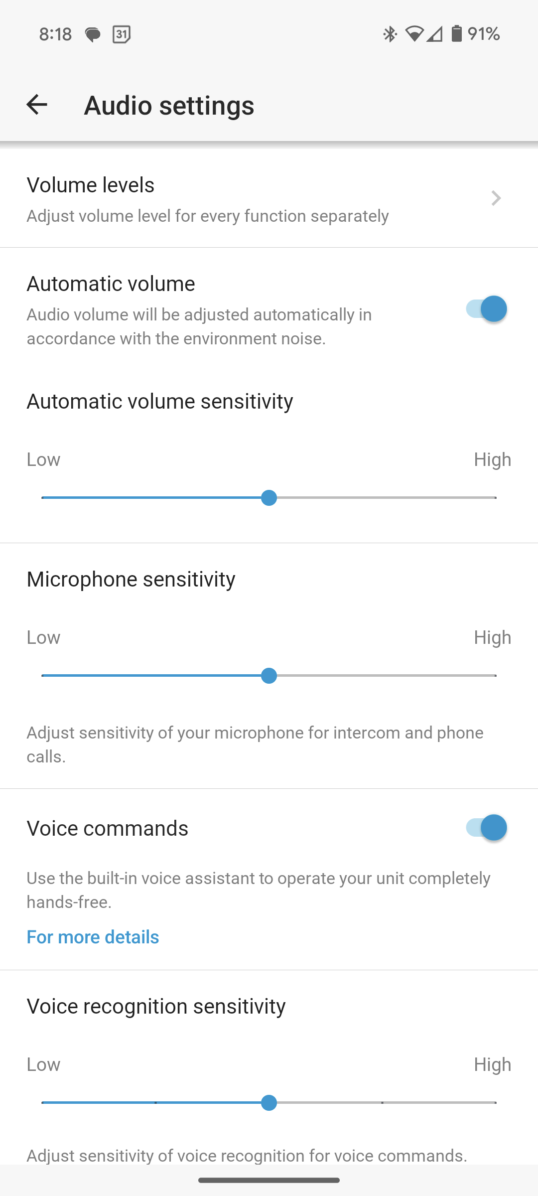

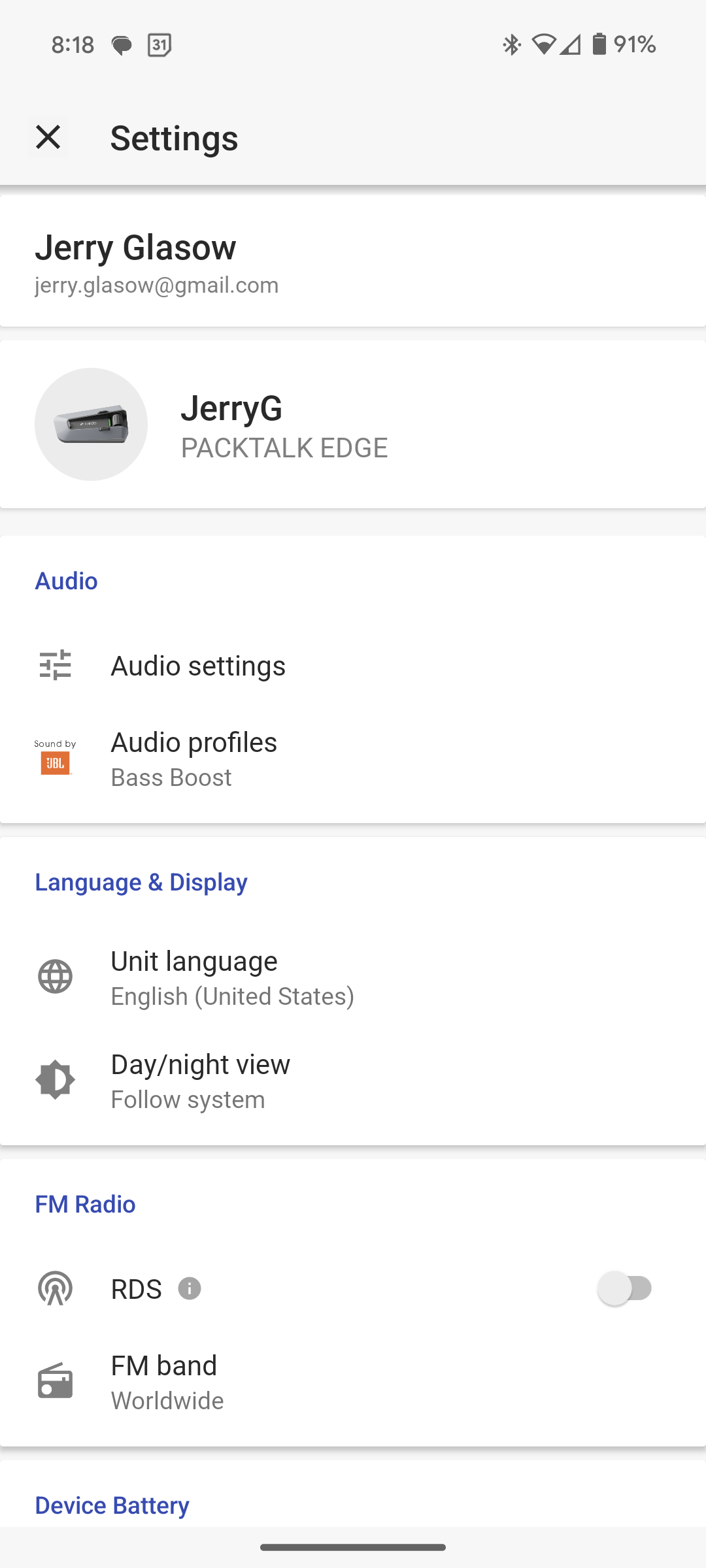

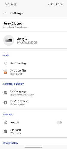

After your Cardo unit and Cardo app have connected, touch the gear in the upper left to open Settings; then touch Audio Settings; then touch Volume Levels; then experiment with changing the Volume Level settings to see if you can find a combination that solves your specific problem.

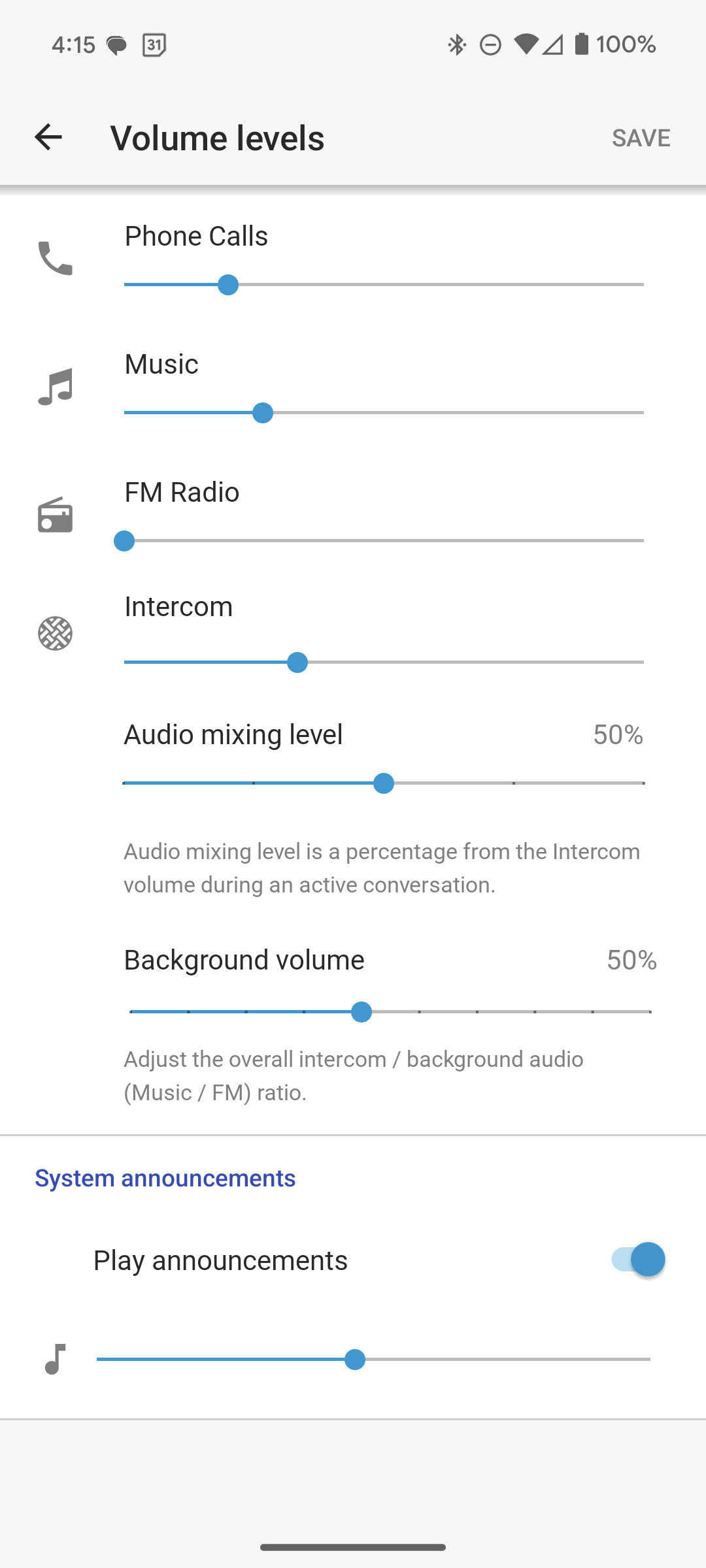

I had to do some test rides while finding the settings that worked for me. My settings are shown in the last screen shot below, but I use custom molded ear buds plugged into my Cardo unit, so my settings probably differ from someone who is uses Cardo’s helmet speakers.
I hope this helps.
This is the Play Store Cardo Connect App page:
This is the app trying to connect to your Cardo unit:
This is the app Home Screen that appears after the app connects to your Cardo unit:
This is the Cardo app Settings Screen that appears after touching the gear symbol on the above screen:
This is the Audio Settings screen that appears after touching “Audio settings” on the above screen:
This is the Volume Levels screen that appears after touching “Volume levels” on the above screen:
(These specific settings are the what I use with my Cardo unit and my custom molded ear buds.)
(I zeroed out FM Radio only because I never use Cardo’s FM Radio.)
