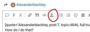

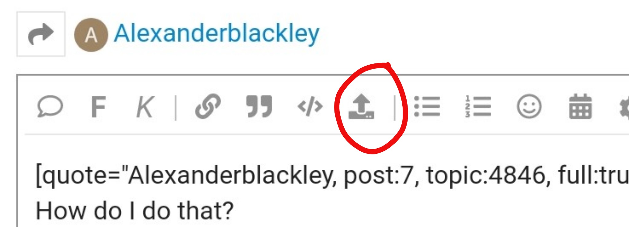

Please can you upload a problem file (which you can not import) here? That would make it much easier …
How do I do that?
Think I’ve found out what the problem was. When I exported the new route I renamed it. When I did this before the new name always added .kurviger after it but now it doesn’t so if I export the new route, name it and add .kurviger after the new name i can now import it. Think problem solved. Thanks for trying to help.
With this button:
