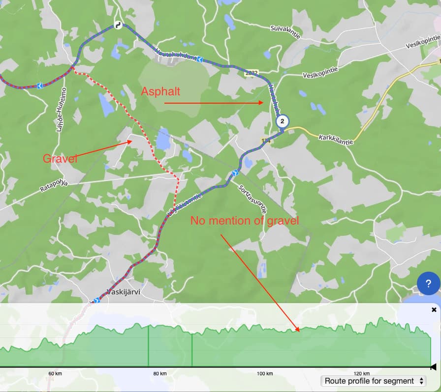

I have now modified the route. But when it was in original shape there was also no mention of gravel part.
So I understand, this is the part of the Route which is a gravel road:
In OSM there is no mention of gravel:
So the OSM should be corrected first - only then Kurviger show it as unpaved road. Is the whole length of this road gravel? You can correct the data in OSM yourself, but if you are unsure how or, someone from the forum could help.
Yes, the section marked in the picture is entirely a small gravel road.

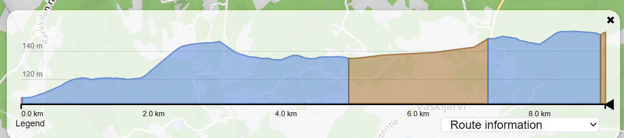

@boldtrn - in the route overview where unpaved roads are shown - could you also display the road where “paved/unpaved” tagging is missing (e.g., with grey colour)? Like you do with speed limits, when they are undefined. This way users would be able to be identify which sections of the route may need to be double-checked.
I mean here, or in a similar view - show as gray area, when the tags are missing:

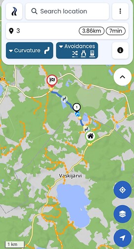

@staape - I have added tags to unpaved roads in OSM. They should be effective in 2-3 days.
Test route: https://kurv.gr/8QpQL
Let us know if there are other roads that should be updated.

We would need a different display for this, but we could. This is actually something we have planned already :slight_smile:
Why different display and not the one already used for unpaved roads?
The one is about route information, it highlights important information. Where are unpaved roads, where are closed roads, where are ferries or toll roads.
Following the argument that we should show roads with missing tags in gray, we would also have to show roads with no toll information in gray :slight_smile: (I’m exagerating of course).
You can see (route information) in the bottom-right.

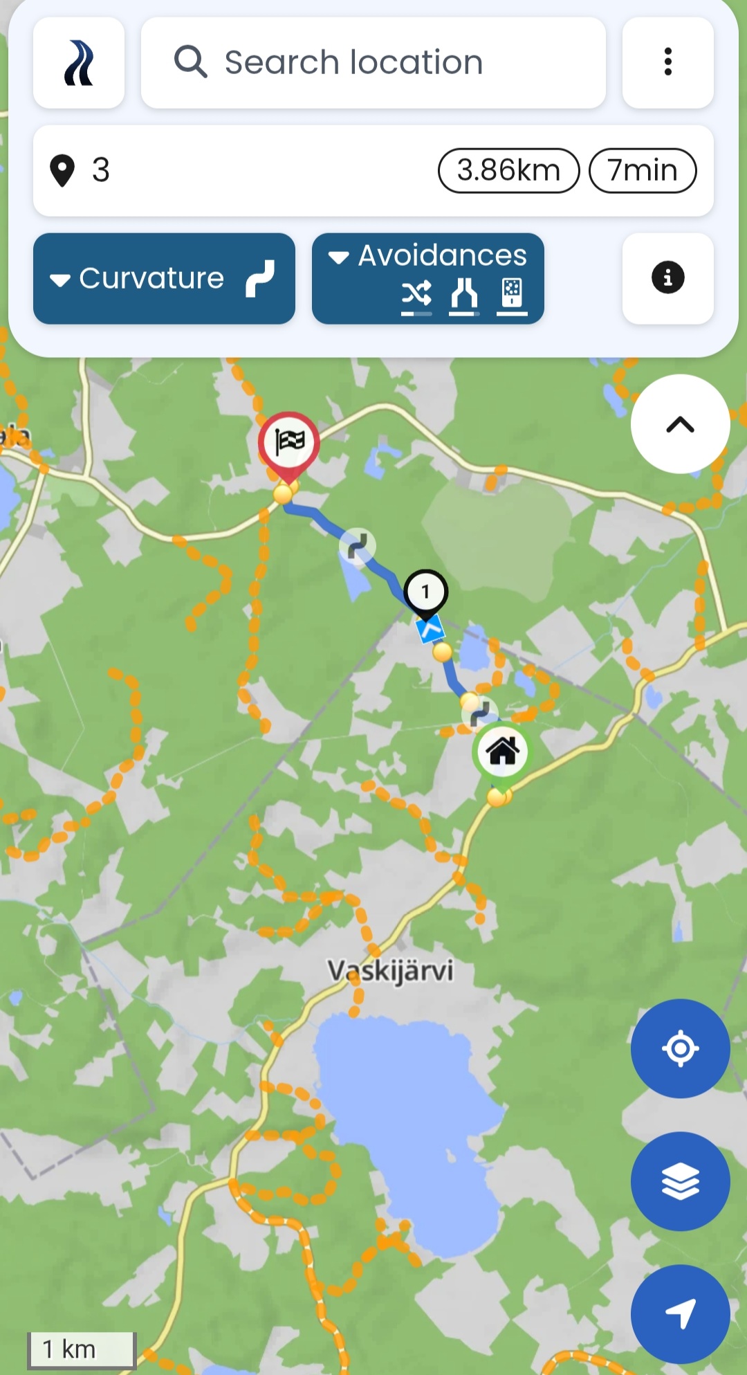

@rumbrummer is it possible to make a query in Overpass Turbo and export all (legally accessible) roads where surface tag is missing as GPX file and then add it to overlays? This could also help users with the similar problem as @Staape to identify where a double check for unpaved roads might be needed.
I think, “legally accessible” will be difficult to handle. Searching for several highway types without surface tag is possible, but I have some doubts, if loading them as overlay in Kurviger works.
Edit: With this search you can find highway=unclassified and highway=tertiary without surface tag in the region of your OSM changeset linked above:
Export as gpx and load the file as overlay works.
Yup. @Staape it would look like this in your area (dashed orange lines are roads that you would need to double check when planning):
