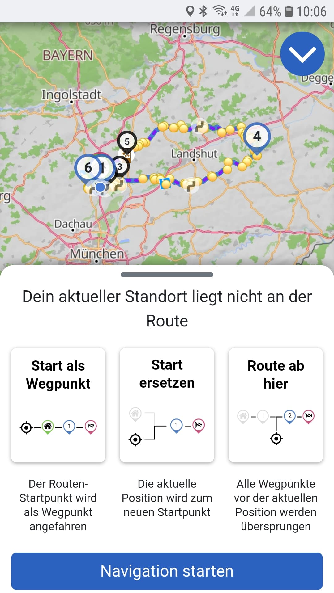

When you start navigation off-route, you should get a popup like this.
Which option did you choose?
thank you, I dont exactly know where I had to take the detour and do a recalculation, will try to be more mindfull next time, first I took Route ab hier, but that shortened the rountrip with 150 km, so I took Start ersetzen and that one brought me back to waypoint nr 1 and from there it picked up the route again…still I am not sure what skip next waypoint in the app does…you can skip it but then? It doesnt bring you automatically to the next one, would be nice if that was so…automatic recalculation or even manual recalculation is very tricky and unreliable when doing a roundtrip…
