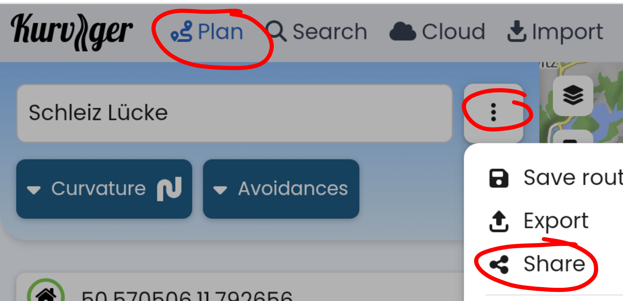

My question is how do I transfer planned routes from my laptop to the mobile app and others in the group?
Before I was able to do this via a QR code this seems to have disappeared. Now it just goes to my downloads in my memory where I am unable to move it anywhere I need. Am I missing something?

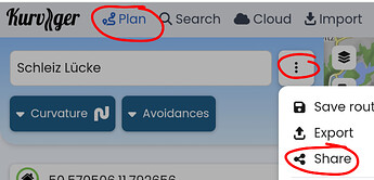

The easiest way is the kurviger cloud.
Via .kurviger file or via shortlink / QR code, located now in Plan / Share:
