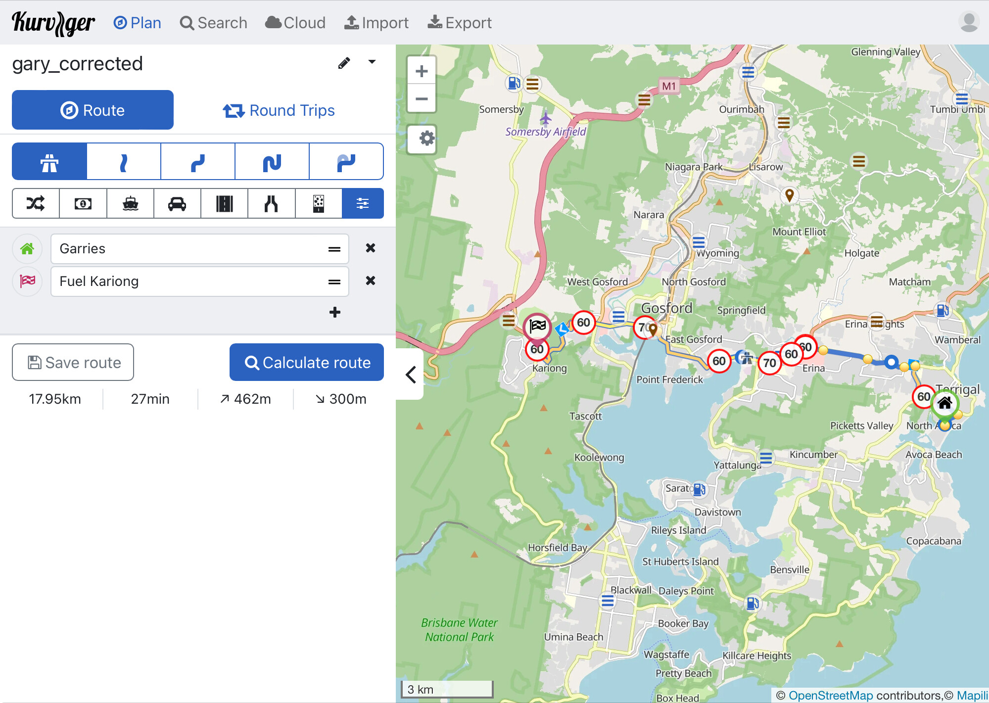

I cannot import any of my GPX files in to Kurviger. It will only provide Start and End points and gives me blue circles for all the Waypoints and Shaping Points.

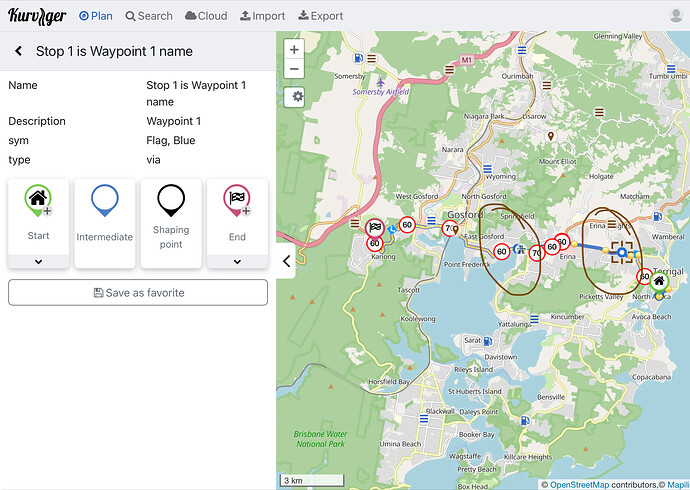

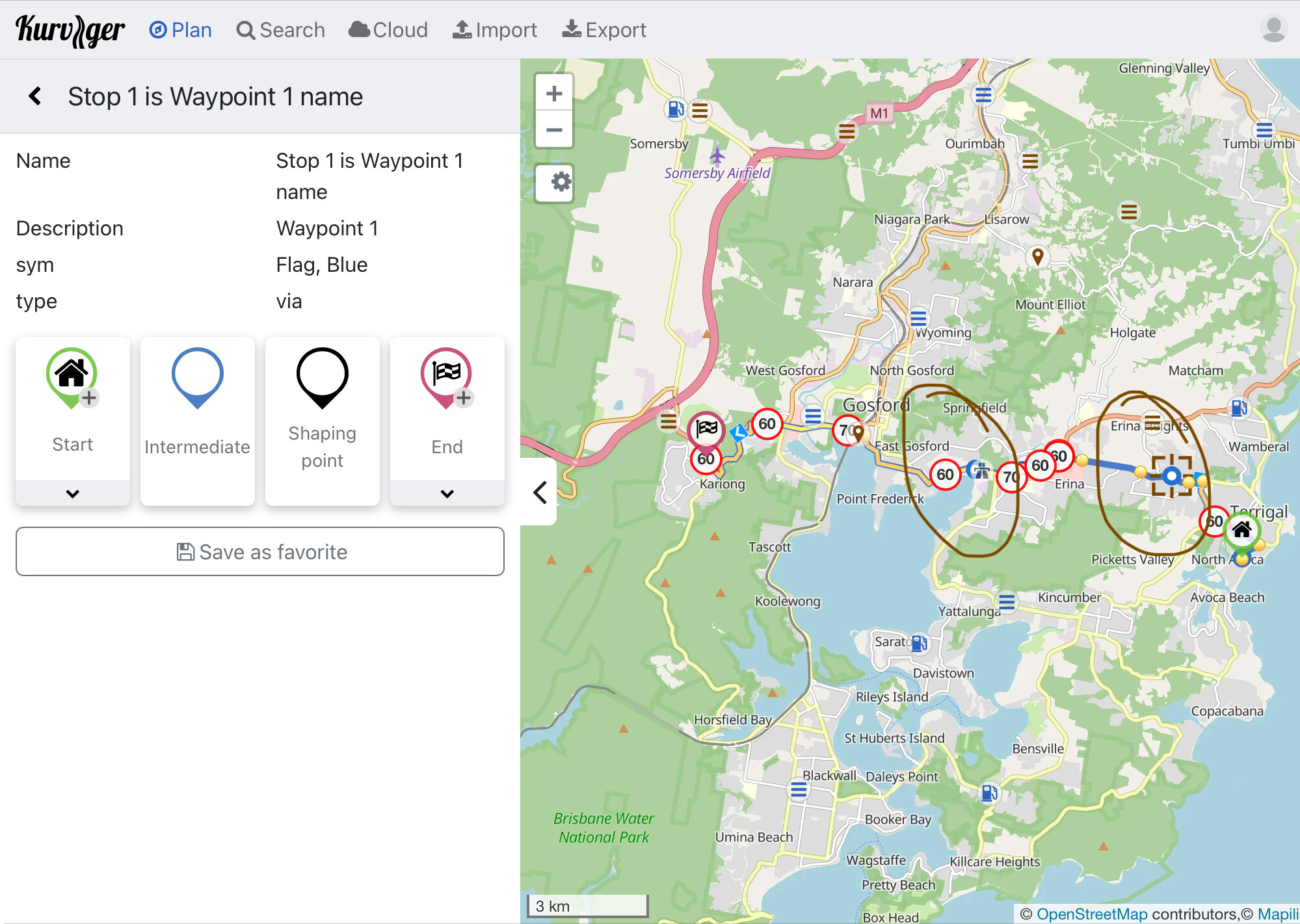

I saved the Corrected file you posted but when I load it, this morning Chrome on an iPad (IOS17.2), it still only loads the start and end points and two blue circles for the Waypoint and Shaping point ! So it is happening on Windows PC and iPad.
Even I I load a GPX from 2 years ago I just get the start and end points. I have cleared my browser cache fully and restarted.
If I click the blue circles they have properties but seems they are not being parsed correctly. Intriguing!

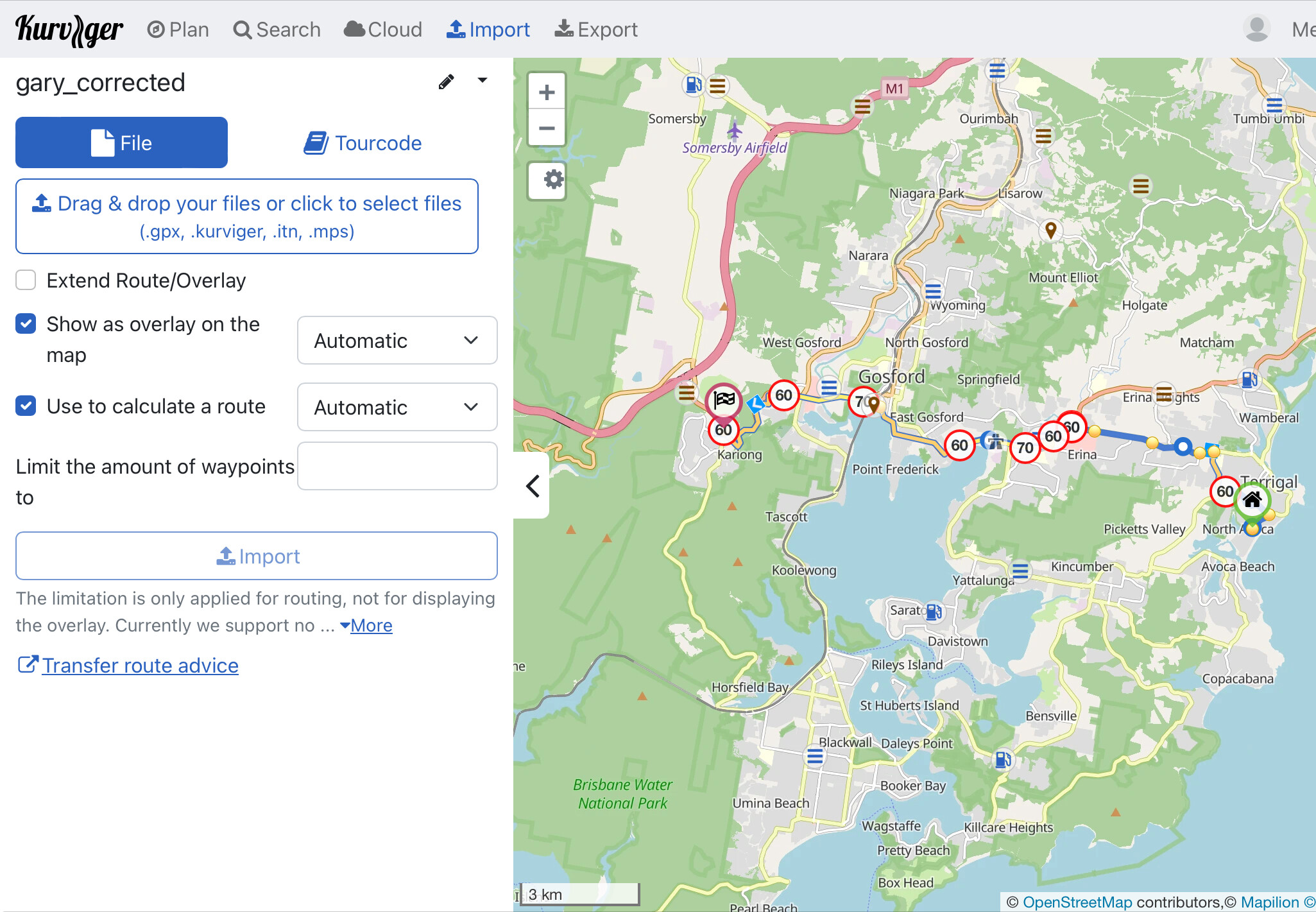

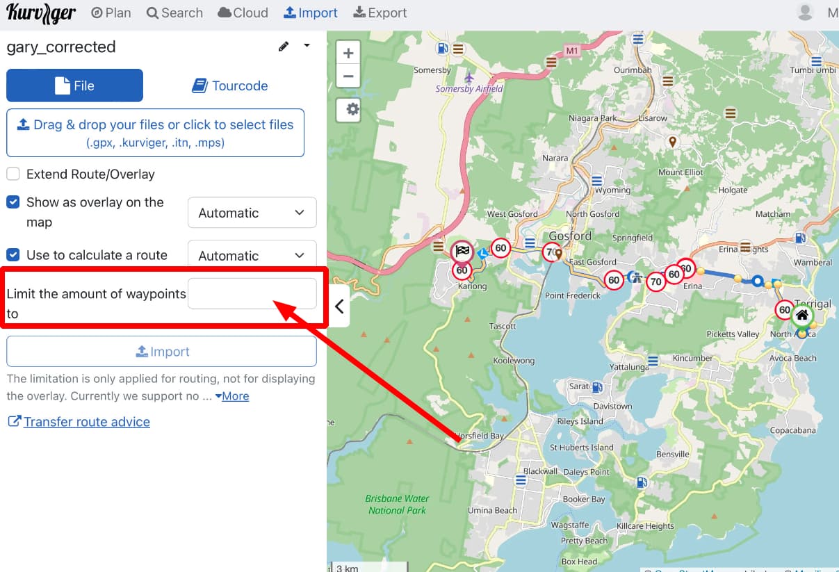

Hi @OldManEmu,
try to write a bigger number to the field
[details=““Limit the amount of waypoints to””]
[/details]
I use to use 100 (smaller only when I really intend to reduce the number of points), for this example 4 would be sufficient.
If you have 2 or less, it takes 2 points only = “Start” + “Destination”…
…but as you have “Automatic” for “Overlay”, it shows the rest of waypoints just as points in the overlay, clickable, but not as a part of the route.
