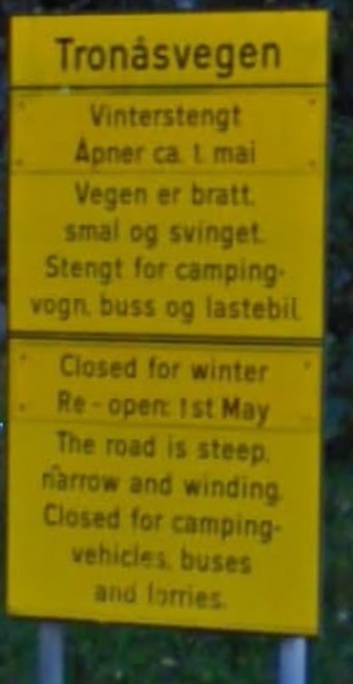

This seems to be because of this road:
The editor noted:
Closed between 1st of November and first weekend after 17th of May every year. The road goes through a protected area for reindeers.
So the access is currently set to “no” and Kurviger will obey that and not drive there. The gate on the other side seems to be implemented better, with a conditional:
Node: 303398800 | OpenStreetMap
I don’t know by heart how Kurviger currently handles conditional access, @boldtrn is currently implementing some stuff (see also discussion here), but I think it would work if the road I mentioned above gets corrected. Seeing that it is after May 17th now, you could go ahead and remove it, or even better: add a conditional from november to May

If you switch over the map layer (use the button at the very top right) to OpenStreetMap, you will see that the road does indeed continue there. Some map providers have better or worse data, depending where you are :slight_smile: The algorithm itself, used to calculate your route, uses the OpenStreetMap data behind the curtain, so it would drive up there, if the road wasn’t blocked/closed. And surprise surprise, this is again what we see, there is an improper gate there:

The issue is not the conditional access, but someone also placed a hard access=no on the road, for example here:
Kurviger obeys these hard access restrictions. The additional conditional restrictions in this case don’t state when access would be allowed, they just define an additional no. So two no’s will result in no in all cases :slight_smile:.
IMHO it’s prefered in these cases to tag roads with:
access=yes
access:conditional=no@(XXX)
AFAIK there is no strict guideline though, but that’s best for routers IMHO.

The Tronåsvegen is definitely rideble.
Look at the videos in youtube. (tronasen or Tronåvegen)
Cool, did my explanation above make sense to you? will you change it in OpenStreetMap?
