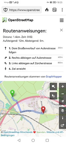

Probably due to recent change there is a routing error shown in the following screen:

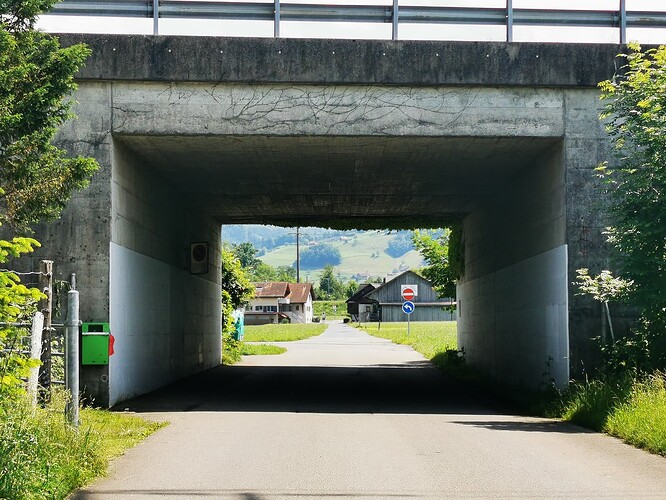

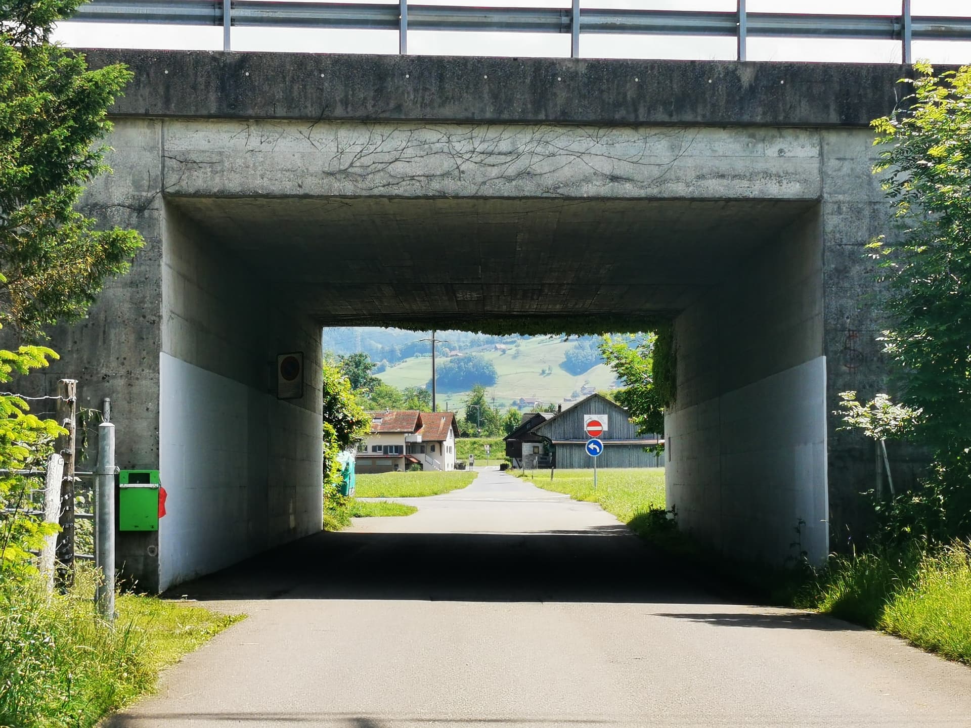

To drive by car from 47.19694, 8.86887 to 47.19178, 8.88332 you’ll have to use the road named “Hämmerli” to get to Zürcherstrasse as Aulenstrasse is a one-way - see Photo. I’ve attempted to modify Aulenstrasse to be one-way and extended Hämmerli to join Aulenstrasse (this probably was not a driveable route until recently) but routing stubbornly sticks to the path no longer valid as shown in above link. Any experts know why?

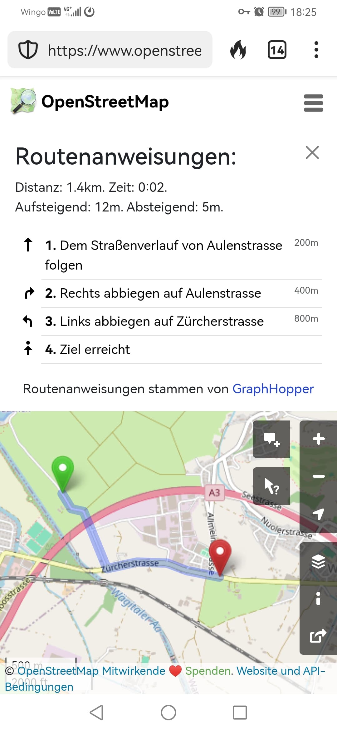

when would you expect the edits to show in the route? not yet familiar with how replication in OSM works. the route is currently still wrong - see screenshot
