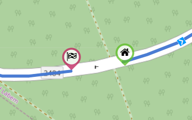

Ich habe heute eine Route durch Tschechien planen wollen. Bei einer der StraĂźen stimmt was nicht. Kurviger plant aufgrund fehlerhafter Daten bei Open Street Maps einfach drumherum. Kann sich das mal bitte jemand mit Ahnung anschauen? Bei OSM wir auch ein Fehler angezeigt.

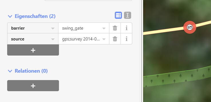

of course :slight_smile: If you switch the map view to “OSM” you can see that the culprit is probably this gate
then you can right click in kurviger and click on “Open in OpenStreetMap”. There, in the edit mode, you see that the gate is missing access conditions
On a road like that it’s incredibly likely that we can drive through this gate. But just to make sure: do you know this region/road and know it’s allowed to go through there?
I don’t know this road. I just planed a route and was wondering why it dosen’t go through this street.

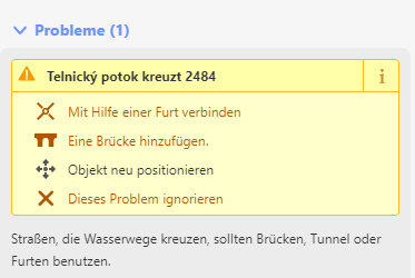

I may have to check it on side. I`ve been confused by this massage in OSM:
But it seems not to be the problem of the Routing issue.

Kurviger refuses routing, if there is a gate without access-tag on the way.
No, those are just warnings, as linux-user and me said, the reason is the gate. I am usually very uncomfortable editing this without local knowledge but… this case seems super clear cut. This is even an access route to the ski lift up there, it’s probably just used to close the street when snow is too high, so I’ll edit it real quick
Kurviger should use the road in 1-2 days
