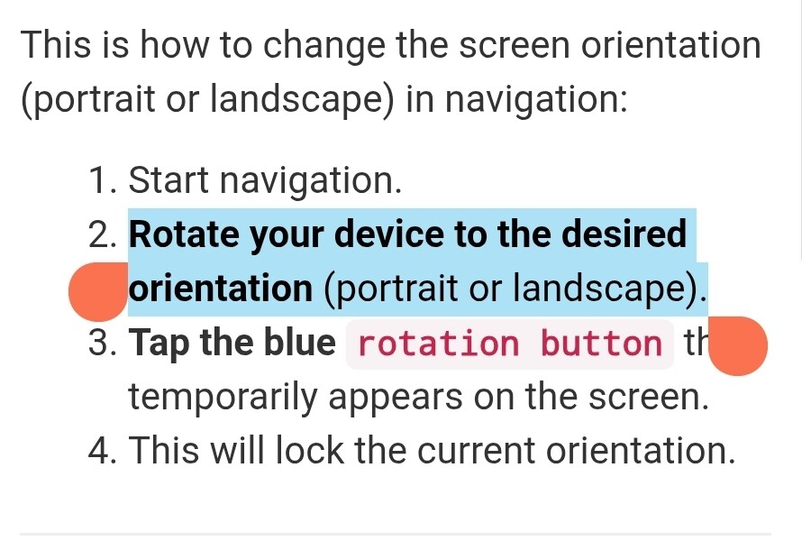

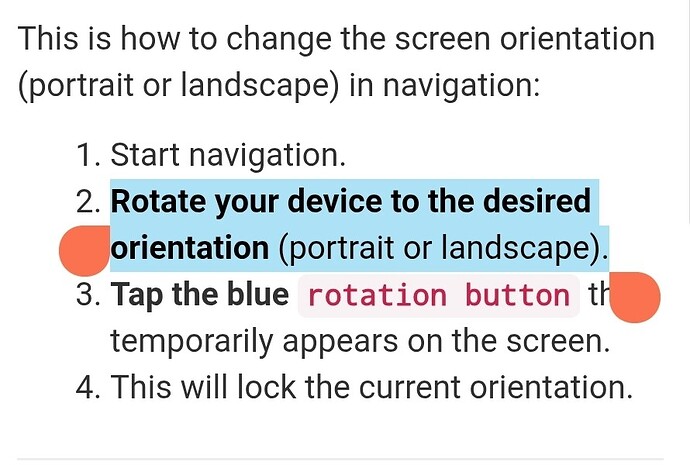

If I follow this link, the second point literally says “Rotate your device…”.
Where is the part that explains “don’t actually have to rotate”?
Yes, and in this case your device is already rotated in the desired orientation :wink:
