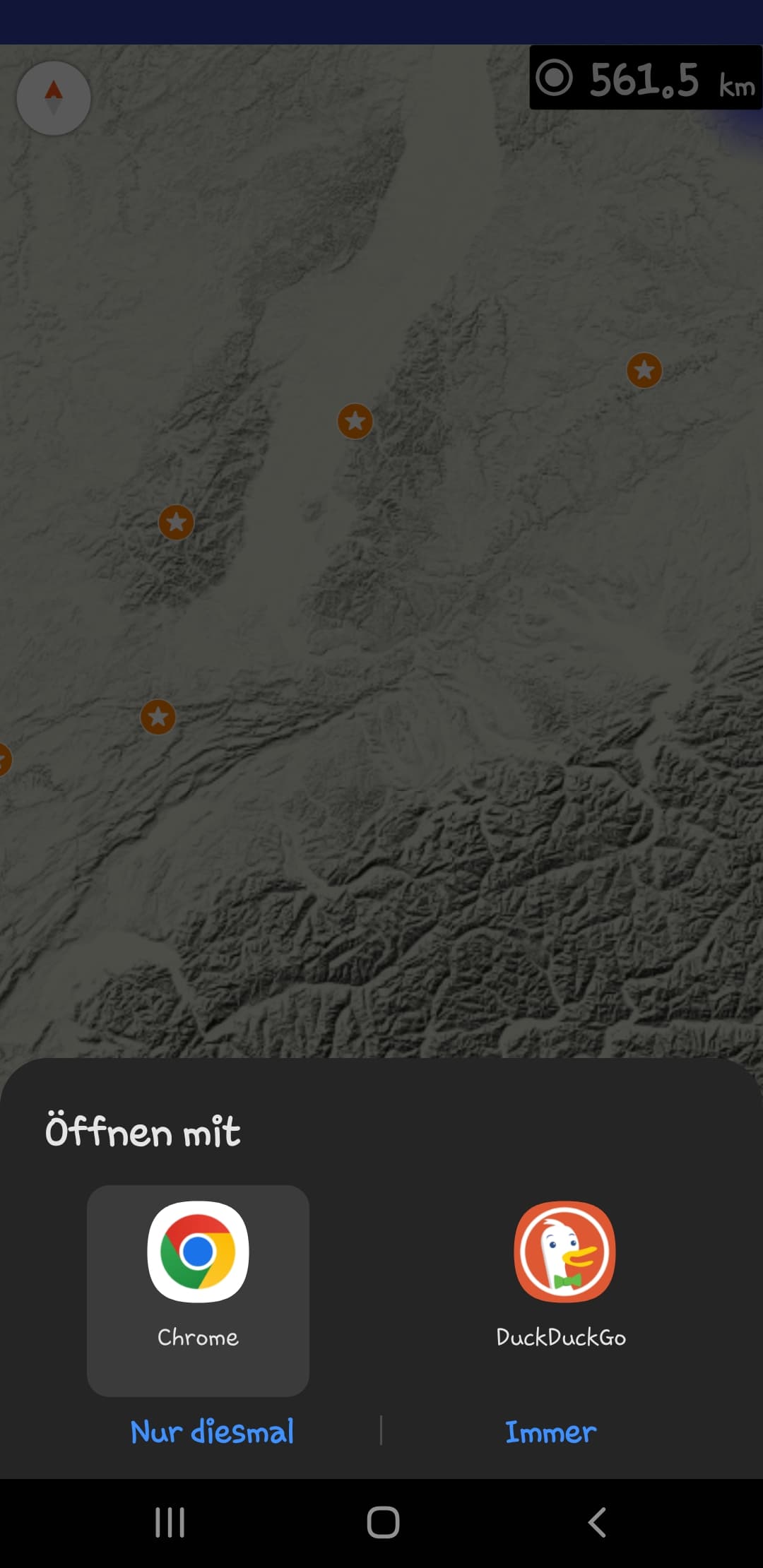

When I scan the code and open the connection the following happens:
1.) Three apps are shown: kuviger, chrome and duckduckgo
2.) When I click on kurviger, kurviger appears on the screen and immediately another window slides over it giving me only the possibility to choose chrome or duckduckgo.

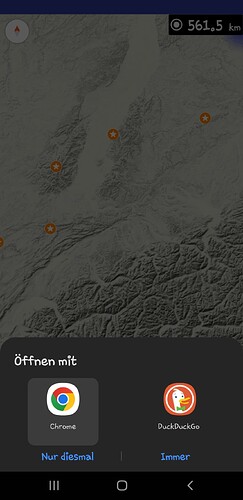

It’s not really an app. It looks like this:
The suggested apps list window is controlled by the Android operating system.
It is supposed to appear only once.
So the process starts correctly → select the Kurviger app.
So the suggested apps window appears for the 2nd time on your device?
You can close it (press the Back button) and proceed with the Kurviger app.

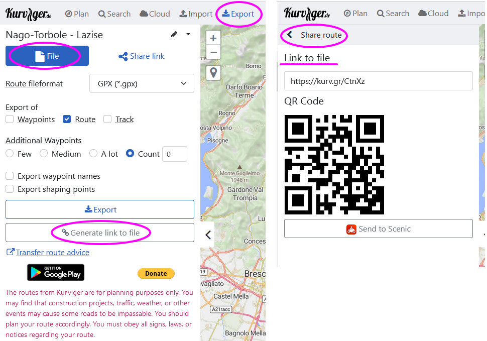

In the website there are 2 different ways to create a QR code.
According to your screenshot you used:
EN: Export > File > Generate link to file > (Opens “Share route” widget including QR code, see right picture)
DE: Export > Datei > Generiere Link zur Datei > (Öffnet “Route teilen”-Widget mit dem QR-Code, siehe rechtes Bild)

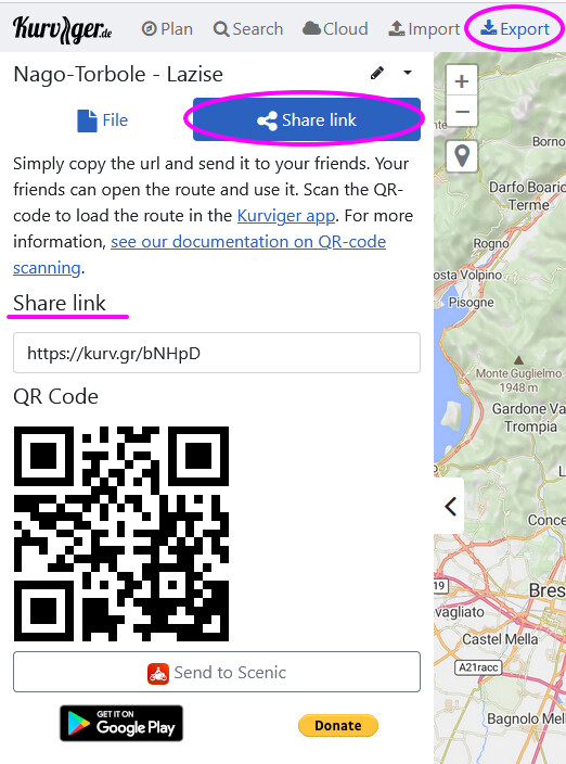

Another way is:
EN: Export > Share link > (Shows QR code in the same window)
DE: Export > Link zum Teilen > (Zeigt QR-Code im selben Fenster)
Perhaps the solution to solve your problem is to use Export > Share link >
and using this QR code.
Many thanks to WalterG and devemux86!
Walter described the root cause and the solution. As it is very often the case the problem was sitting in front of the screen.
