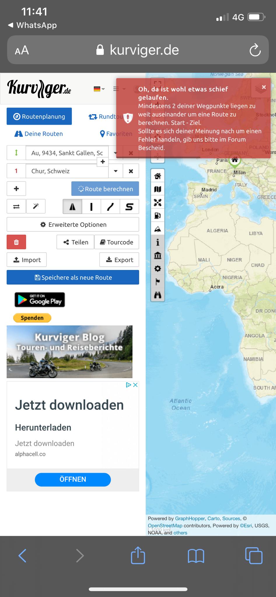

Something goes wrong. at least 2 of your waypoints are too far apart
Since today i have the Problem with every Route i want plan on the Website
At least 2 of your waypoints are too far apart.
Doesent matter how close or far they are.
Tested on different Devices, different Browser, different OS.
Is this a Issue on the Server or something wrong?
Thanks
Greetings from Switzerland

also wenn ich nur 2 Punkte angebe also von A nach B kommt gleich der Fehler. Also in meinen Fall von 9434 AU (Schweiz) nach Chur (Schweiz). Weiss nicht ob das mit diesem Link schon sichtbar ist.
Ich versuche noch ein Printscreen bei zulegen
So kommt der Fehler auf allen Geräten

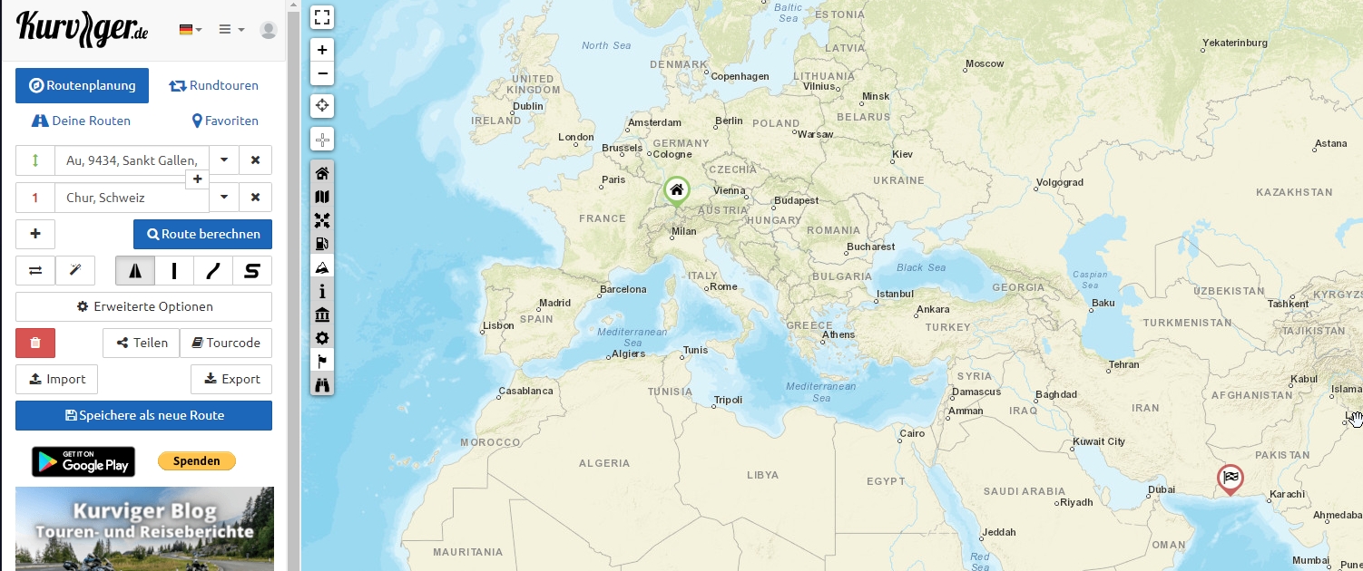

Seems start and end are too far away, like routing across different continents?
Please see the relevant documentation:
"Due to technical limitations we cannot easily route across different continents.
We recommend to split the route into two different routes, if this is possible."
Hast Du Chur, Schweiz selber festgelegt? Bei mir wird Dein Ziel in Pakistan angezeigt…
Oder hast Du “Chur Schweiz village” gewählt? Da scheint was mit der Adresse nicht zu stimmen @boldtrn. Mit Chur Bahnhofsplatz funktioniert es. “Chur, 427110, Russland” liegt auch in der Schweiz… :joy:
hi devemux, thanks for your input. But both places are 80km away and not crossing continents. Both Points are in Switzerland. But when i chose Chur, Village its comming this error. When i chose Chur Bahnhofstrasse (Street) the Error dont appears.

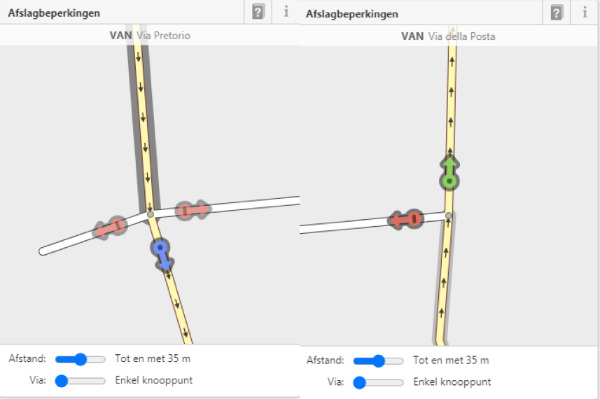

Unfortunately, this is a known issue in OSM. There are issues with the turn restrictions there. I created a OSM note 3 years ago, but unfortunately, no one has worked on it yet: Note: 1172576 | OpenStreetMap
The problem is, for Lugano, the search places the waypoint exactly on this street.
