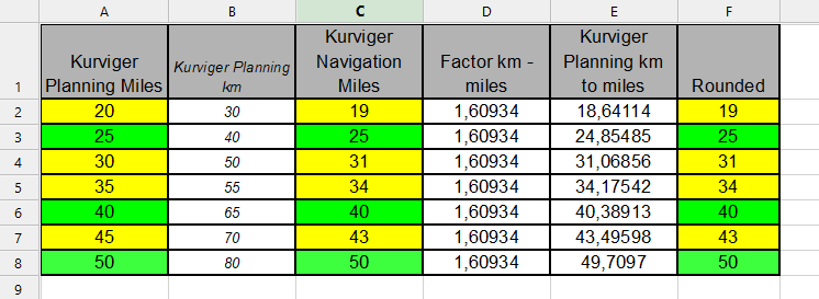

I just came back from a Sunday tour. Here a few issues that I observed:
1.) The speed limits were not always displayed or incorrectly display. Here are few examples: A 35 mph speed limit was display as 34 mph. A 20 mph was displayed as 21 mph. Many time did I see a ?.

That is how it should look:
I checked the route. It seems it is caused by a rounding issue from km to miles. A possible solution could be to round up/down to 5 miles/h or km/h. From OSM-taginfo for maxspeed this would be valid for about 99%. There are some few exceptions; in my head summed up to only about 1 percent.
Yes, that’s a good point, rounding to the closest 5 would probably help quite a bit here :+1:
Perhaps only for countries using miles.
If you could fix it, it would be great. It is a bit irritating when I see the strange speed limit numbers.

I tested the version 3.5.2. The displayed speed limited for 55 mph is still incorrectly displayed as 56 mph.
We haven’t changed the rounding here yet. We fixed the color, if you are going too fast.
