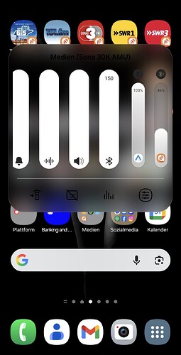

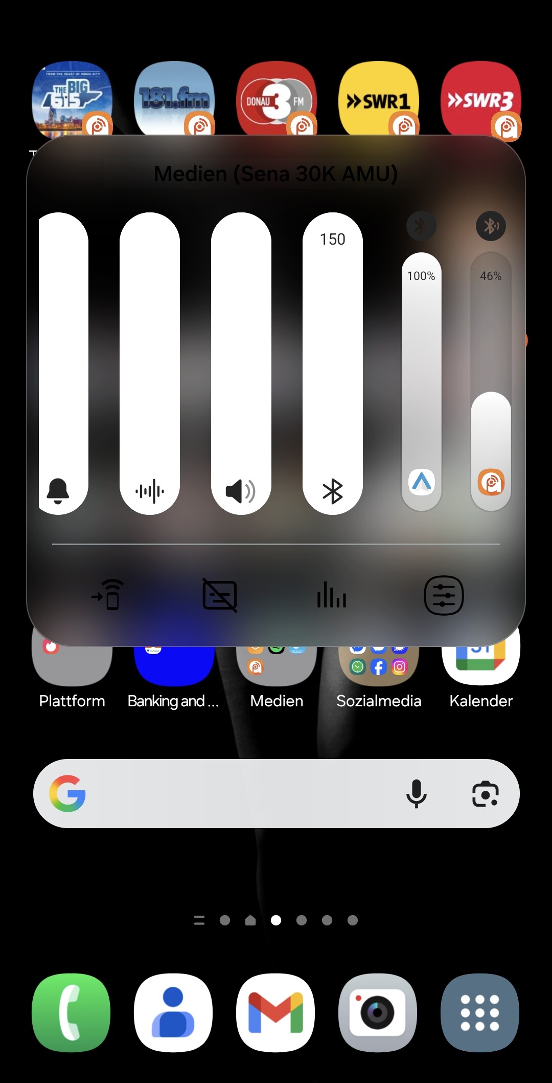

Please see here, a lot of people confirmed this solved the volume issue (volume can effectively only be changed when Kurviger speaks). Try to set output channel in Kurviger to Music/Media.
I have to disagree; the Samsung Sound Assistant does affect that. At least when you adjust the balance between radio and navigation announcements.
