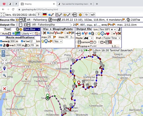

In order to create a .gpx file for co-riders with as little effort as possible (because I use the Kurviger app on my smartphone), I “developed” the following procedure:
  • create the route in Kurviger Tourer,
  • set all waypoints on the road,
  • look for u-turns in turn instruction
  • export the route in .kurviger format
  • then switch to gpxshaping.de and import this .kurviger file
  • this website inserts enough shaping points to force Garmin to follow the track
Files:
AR - Anzing - Falkenberg.kurviger (25,0 KB)
AR - Falkenberg.gpx (211,1 KB)
AR - FalkenbergShp.gpx (98,4 KB)

Yes! (There is a excellent helpfile in this website)
Sure there are differences between the maps (therefore I use kurviger app). The “trick” is, to provide a route with enough waypoints and not Garmin let define the waypoints based on just the track.
Okay - even with my procedure there isn’t a 100 % guarantee to get the exact route - but it’s close!
