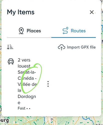

Actually the â€œĂ©â€ is ok, the problem is the " ’ " character.
Also, the issue is not in the file name, therefore simply renaming the file does not solve the problem.
Tomtom does not like the character appearing in the metadata tag:
<name>2 vers louest Sarlat-la-Canéda - Vallée de la Dordogne</name>
which appears twice in the GPX file. If you edit the file and remove the " ’ " from the tag, the file will load.
@boldtrn does the GPX standard prohibit usage of special characters like this? If yes, it might be a good idea to remove/replace them, otherwise it is a Tomtom problem.

Yes, so the ’ is not strictly forbidden, it has to be escaped in some places, but I guess we should just escape it everywhere, we will look at this :+1:.
