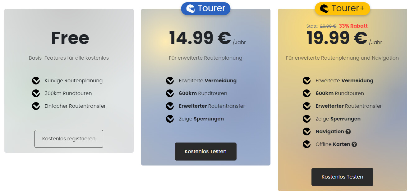

Hallo zusammen, bin etwas ratlos wg meinem
Account, bin als Tourer registriert, Button hat gelbe Farbe, bei Early Bird Sale ist der Tourer+
Button gelb hinterlegt. Was ist richtig?
Liebe Grüße
Der Tourer kostet jetzt 14,99 €/Jahr
Tourer + ist die neue Modalität, in der Tourer und der Browser zum Preis von 19,99 €/Jahr enthalten sind
Tourer+ ist für die Navigation mit der App.

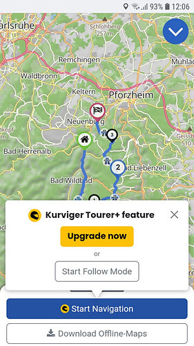

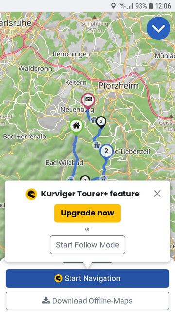

Hi.
I am having problems using the app since yesterday. There is no problem when I creating a road, but when I click the Start Navigation button, the app is asking me to click to Upgrade now or Start Follow Mode. If I click Upgrade now, the app is directing me to subscribe to new plans, but I have already had one and do not need the other. If I click Start Follow Mode, the map opens but the app does not navigate me over the created road. Simply put, I cannot navigate using App. How can I fix the said problem?
Hello,
that’s right, since the introduction of the new app version 3.1.0 you need to have the Tourer+ subscription to navigate in the app.

This may happen, when you are not logged in at the app with your Kurviger-account or you don’t have a subscription or you have the “Tourer” subscription.
Screenshot: Dialog “Upgrade now” or “Start Follow Mode”

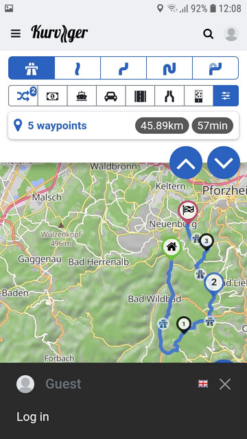

@boldtrn: Perhaps there should be a button to select “log in” when not logged in.
Screenshot: Not yet logged in
Are you really logged in in the app?

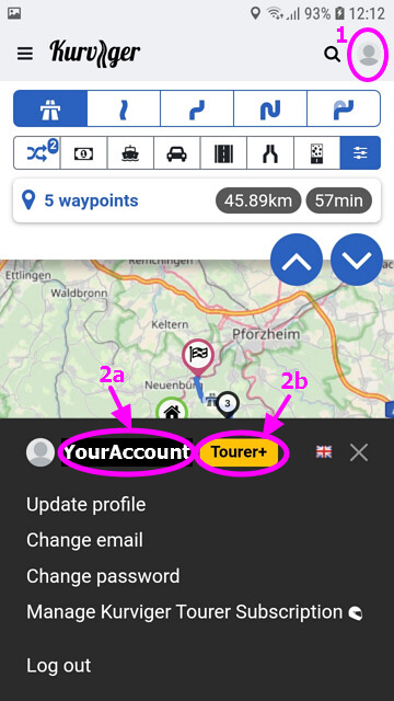

Screenshot: Logged in
When you tap on the Icon marked “1” then when logged in you should see the name of your Kurviger account (marked “2a”) and your subscription (marked “2b”). For navigation the subscription must be “Tourer+”.

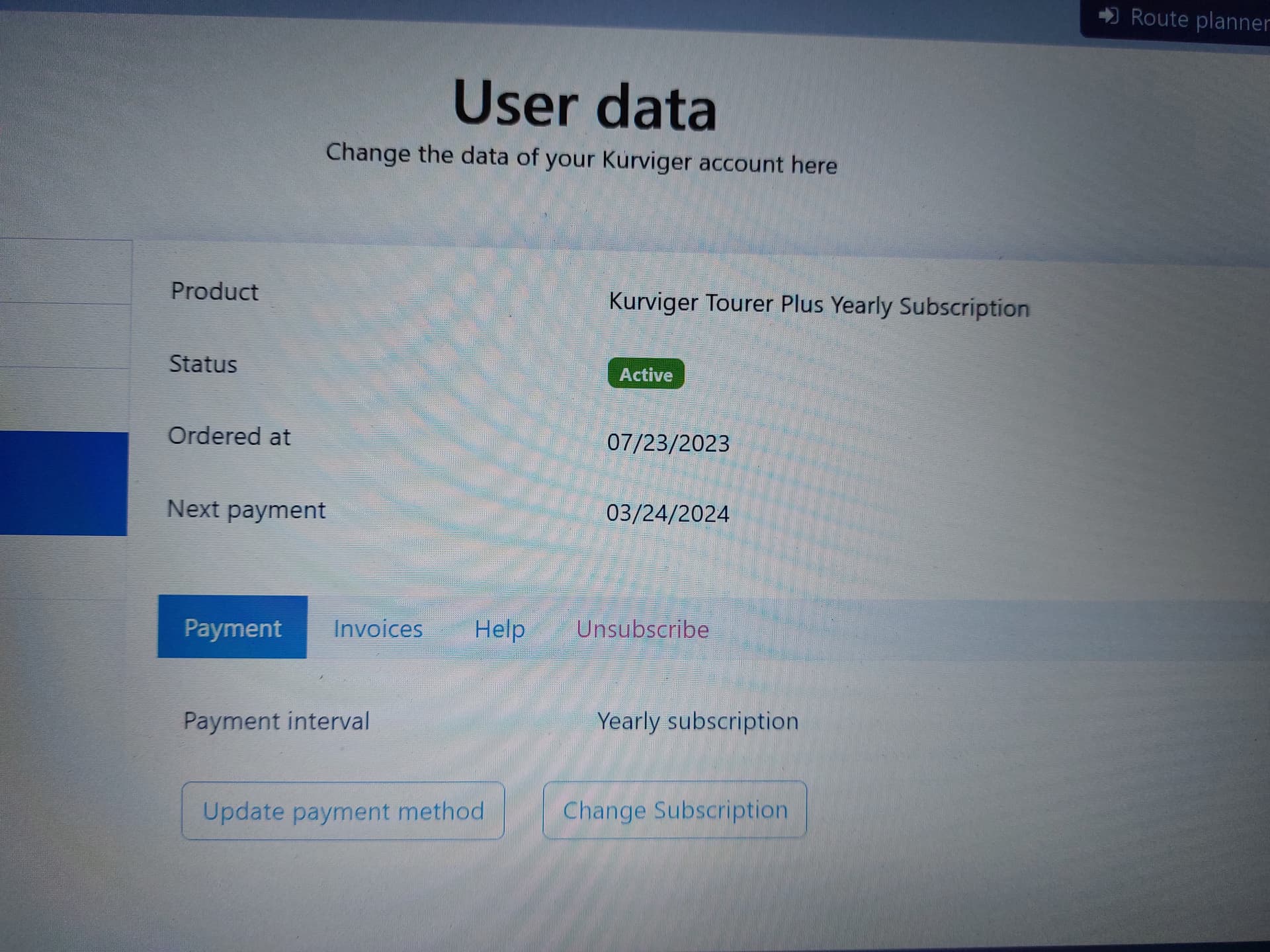

I’m logged into the app. I verified my account as you mentioned in the app. I realized that I don’t have any subscription in my App account but I have a Tourer+ subscription on the website, see screenshot,
and I already paid for it. I understand that the website and App accounts must be mutually connected, meaning that if I change something on the website, it should appear in the App. If I subscribe to Tourer+, will I be charged again?
I mean, if I subscribe to Tourer+ on App, will I be charged again?
you only need one Tourer + subscription. It is for the web as well for the app.
I cannot reactivate the Tourer subscription that I canceled by my mistake or I cannot change subscription to Tourer+ also. Before everything was great, I was really happy with how the App works. I don’t understand why I cannot subscribe to any Kurviger plans.
Is it possible that you have multiple accounts? Your screenshot shows Tourer+, I tried to check your account, but that account has a cancelled Tourer subscription. Please make sure that you only use one account.
