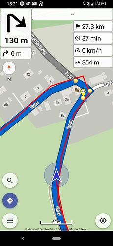

Hi@ll,
On my yesterdays tour I noticed that the calculated route and shown and spoken turn instructions are conflicting.
Please see picture
I´m using Android Kurviger Pro 1.12.4

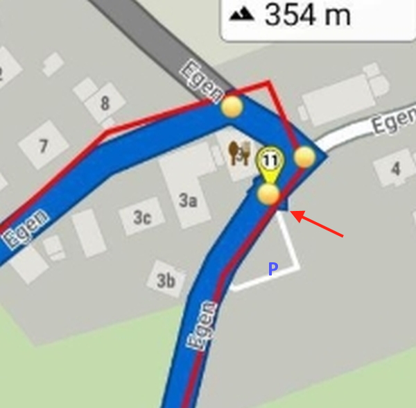

Hi McTom,
in my opinion your waypoint 11 is a little too far to the right. It sticks out into the side street (a parking lot entrance) and you get the instruction “turn right”.
I checked it out here (http://kurv.gr/rTzLp).
You easily can see it at the little triangle in blue that should not be there if the waypoint sits correctly:
Daaamn well spotted @zaphod_42, like sherlock with a magnifying glass! ![]()
Hint for everybody for the future: if you have a yellow bubble below your waypoint, that’s a big no-no. Because it means that the route “does something” below your waypoint
After waypoint types integration, the shaping points are those without instructions / yellow bubbles.
