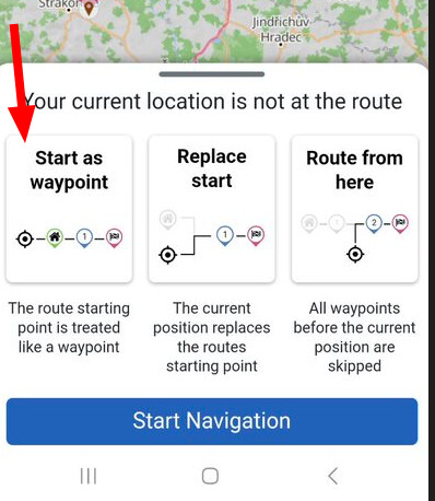

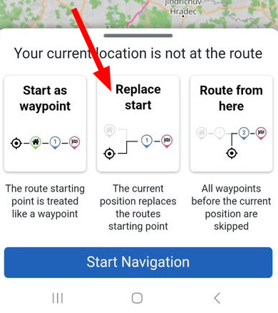

You are right, the newly created “start” is present only if you immediately start the navigation, so you cannot change the profile between the “newly created start” and the “original start, now waypoint”.

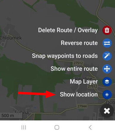

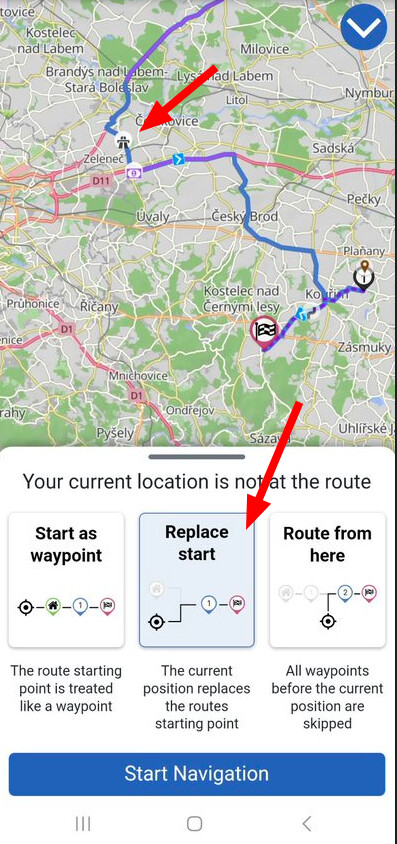

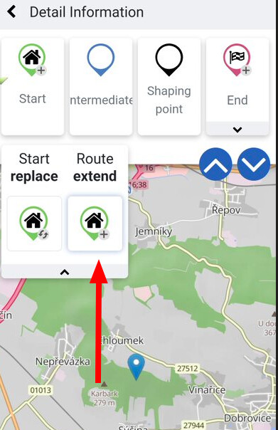

The you desire to do so, the way/workaround is to use the 3-dot menu to
click on it and
Now you have your location as a new start and you may change the “profile” for the “approaching part” of your route as desired.

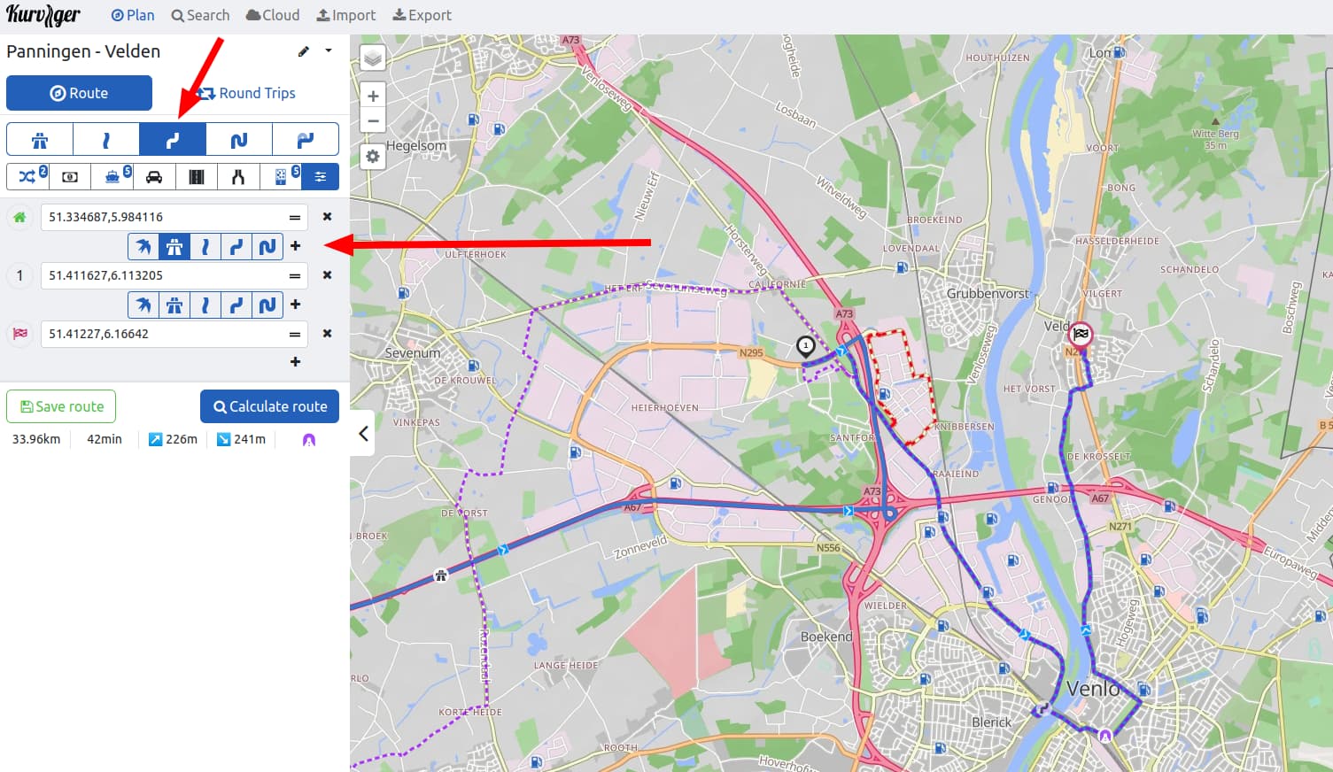

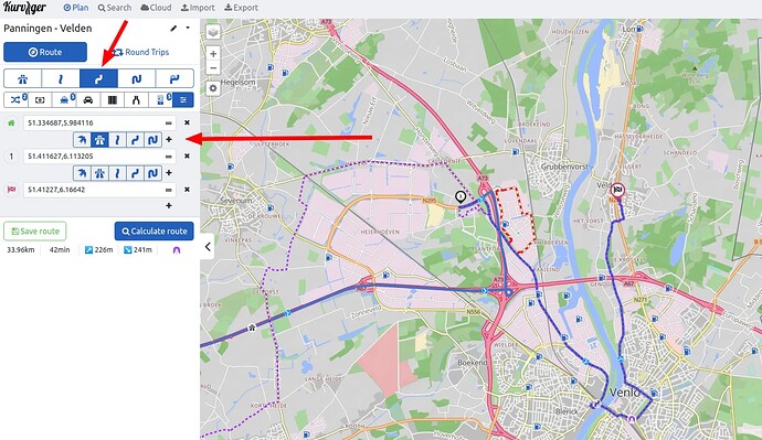

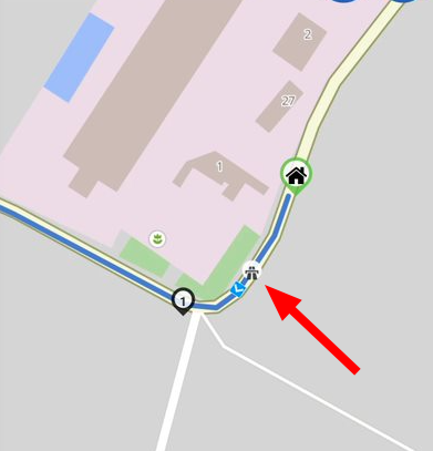

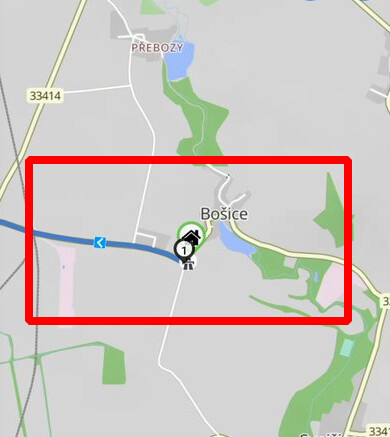

The alternative way is, if you want to plan a route with a distant start, you want to approach by the “fast profile” is
[details=“to plan at the beginning of the route a short part with the “fast profile”.”]
[/details]
Then, when using
you will be navigated to the next point by the “fast profile”…

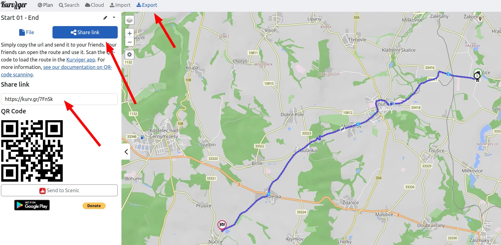

Strange, it works for me, for my example above - https://kurv.gr/G4RXx
[details=“it takes me from where I am to the “Start 02” by using highways and main streets…”]
[/details]
Will you share your example, where it does not work?

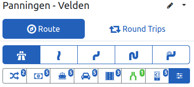

you have restricted
…it is extremely hard for the algorithm to find ANY route at all…
The general recommendation is not to use avoidances as much, only for essential things, as to avoid unpaved street if you ride a heavy cruiser…
Try this for example, if you need to avoid ferries, unpaved roads (and the avoidance of using the same route when planing round trips, which is not applicable here) - https://kurv.gr/CUHRB. As you can see, Kuviger takes you from Start to SP1 using highways and then using some smaller streets, without “doing wild things”.
My personal “best practice” is to use the “curvy road” as default, with some deviations only for the part necessary (here the first part of the route)
Personally, I do not even use any restrictions, but this is specific, as there are not many ferries where I usually plan e.g. and I ride a dualsport, so I do not mind unpaved roads…
