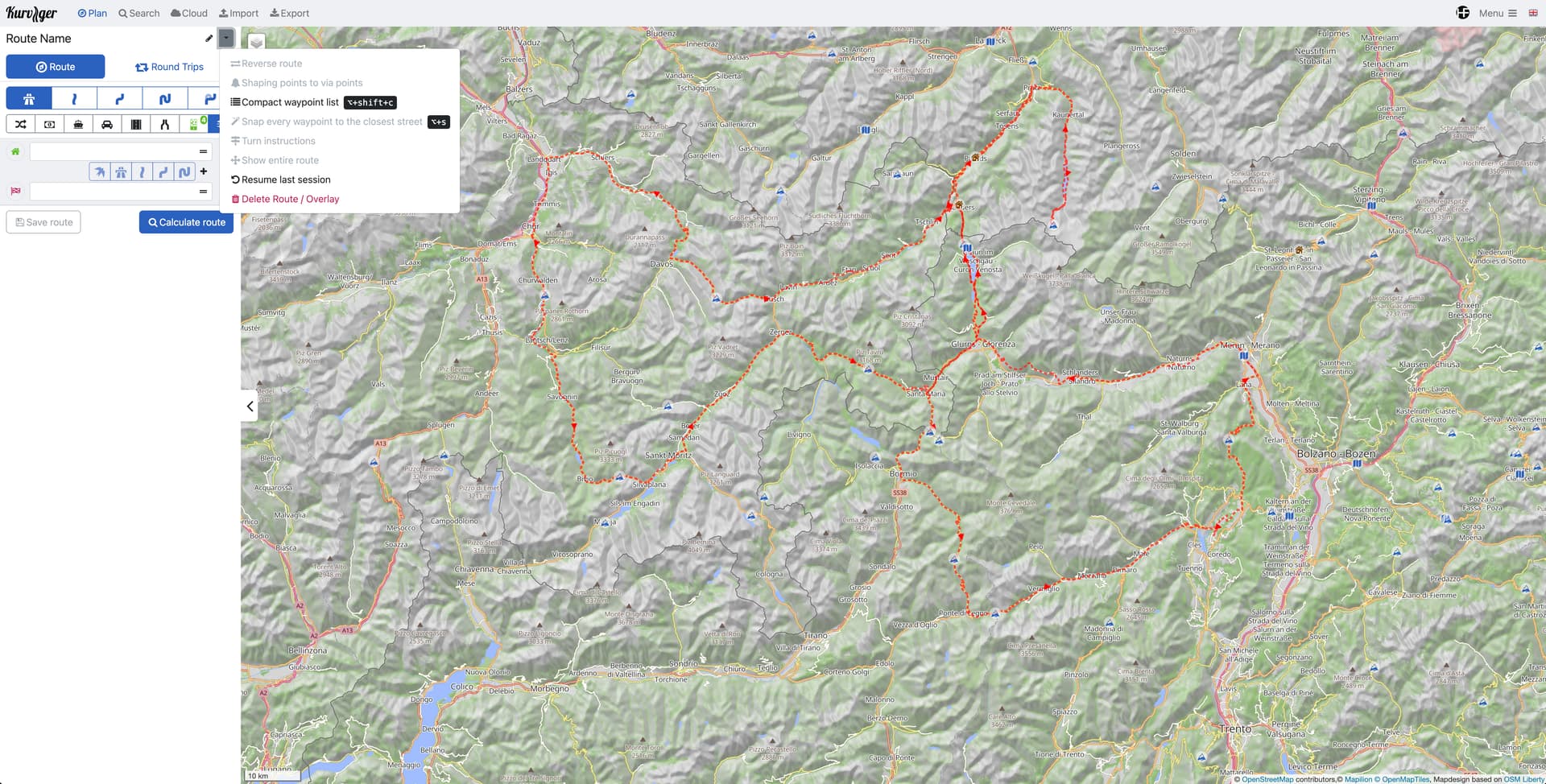

I planned a multi-day route and saved all daily routes in a folder.
Right hand beside the Route is an option “Show saved route on map”.
I did for all days to see the total route.
However, now I am not able anymore to “unshow” the routes.
They remain visible, even when I load a completely different tour.
How can I "un"show these routes now again ???

Hello,
I can only strongly recommend to really try everything at Kurviger once yourself to get to know the functions.
In your case, go to the planning, to the right of the route name and the pen symbol, open the menu and then select the red entry, delete overlay. That’s it

I saw this option but since it says ‚Delete ROUTE/Overlay‘ I was hesitant to use it. Didn’t want to delete the route.
Thanks for clarification.
With “Delete Route/Overlay” you can unfortunately only delete the TOTAL overlay (containing all possibly added routes).
It would be great if you could hide SINGLE routes that you have added via the dropdown menu with “Show saved route on map” (or hopefully in the future “Show as overlay”).
For example simply with a menu item “Remove saved route from map” (or later “Remove overlay”)…

Loaded routes and overlays can be deleted separately from each other.
Yes, but several routes added as overlay one after the other are all part of the SAME overlay - which can be deleted as a whole, but not on a per-route basis.
