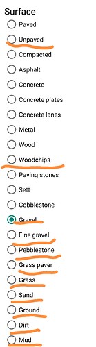

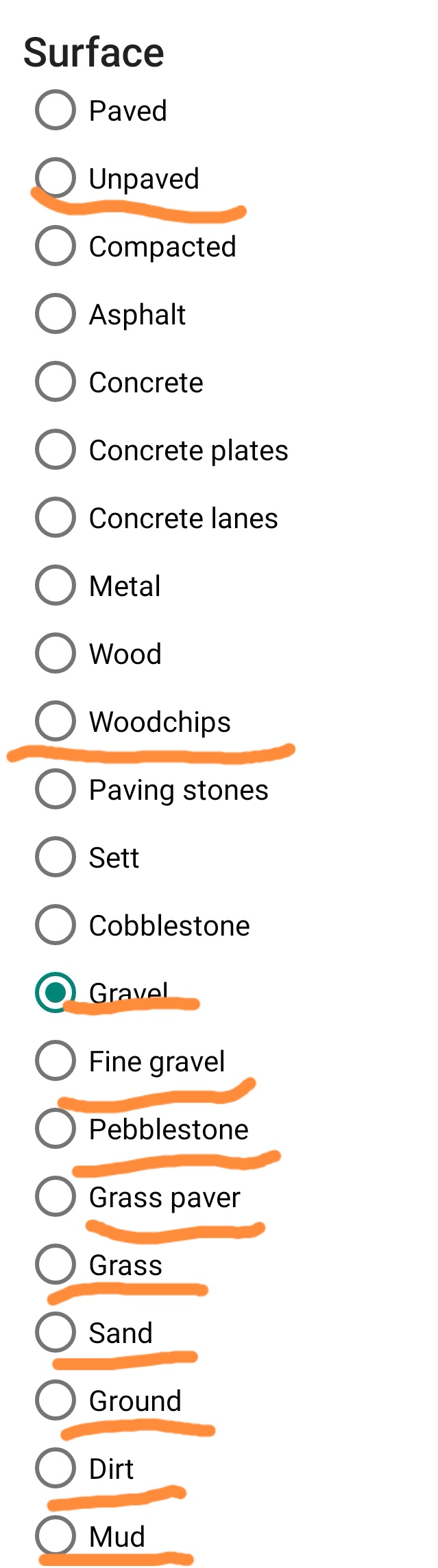

I suggest that “avoid unpaved” should mean to avoid all non-firm surfaces, such as (screenshot from Vespucci) :

That is indeed the current behaviour of Kurviger. If a road is not avoided, it is mostly not tagged correctly in OSM. If you find an example where this is not the case, please report it and we can check what happens in this case
