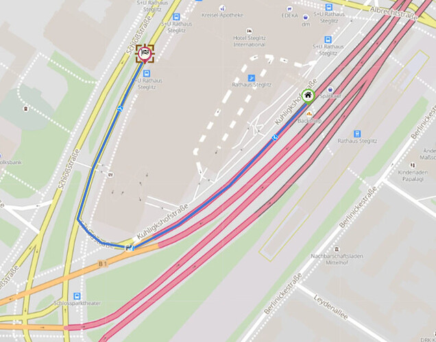

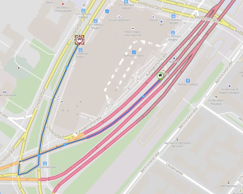

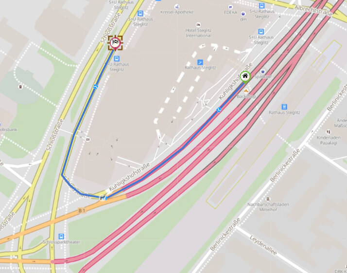

Using the beta, I navigated in Berlin and stumbled across this (useless - but I don’t know if avoidable) flaw/nonsense. When leaving the end of the freeway 103, the direction to go is right. Even if only avoid freeways is selected, but the freeway is used anyways, instead of turning right after the traffic lights, that terminate the freeway, the app wants to extend the route and use four more traffic lights for a gain of three corners and create at least one or two more stops.

Ok. If the option curvy is chosen, which is defaut, it will navigate this way. Useless, but probably a special case. https://kurv.gr/KfttH

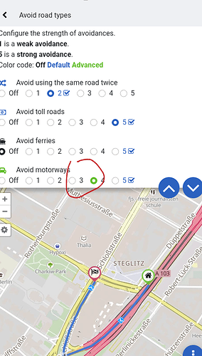

This might solve the problem.
Choosing the strongest avoidance causes some problems in routing
